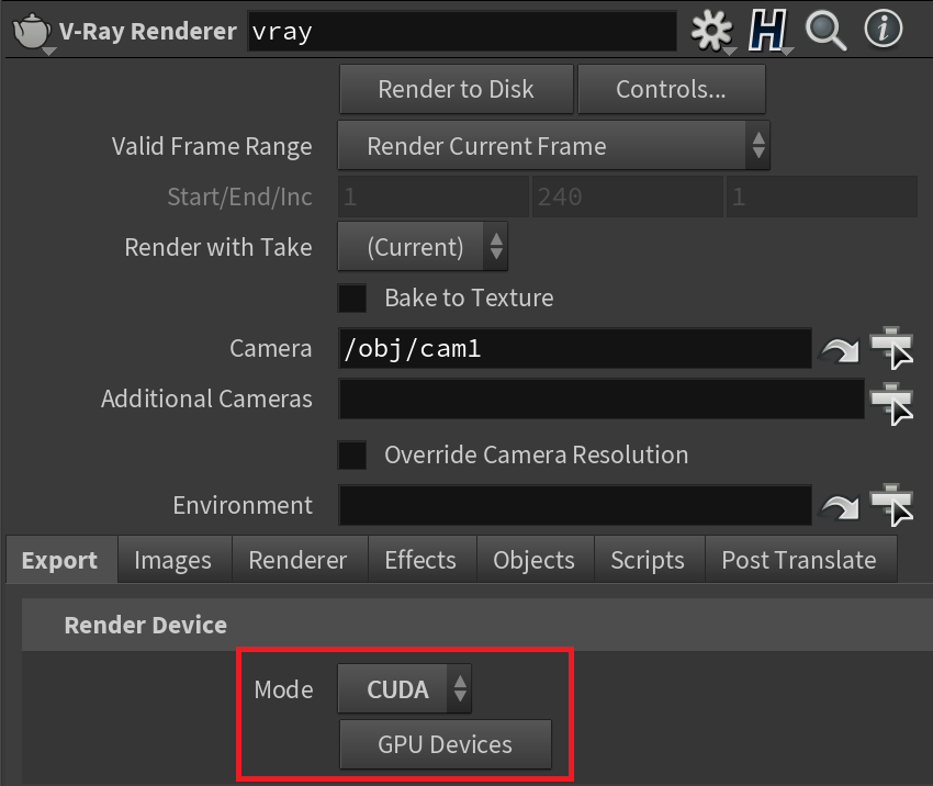

Can I choose which devices to be used for GPU rendering?
Yes. There are instructions how to do that in the GPU Setup section.
How can I check which devices on my system can be used for GPU rendering?
Why isn't my GPU device(s) listed?
Check the list of devices in the GPU Devices menu in the Export tab of the V-Ray Renderer node. If you don't see your device on the list there (the list is empty), try to deselect the In process checkbox. This will make V-Ray run as a separate process, working around the limitation.

You can set V-Ray GPU as production renderer by the V-Ray Renderer node's parameters (Export tab > Mode).
