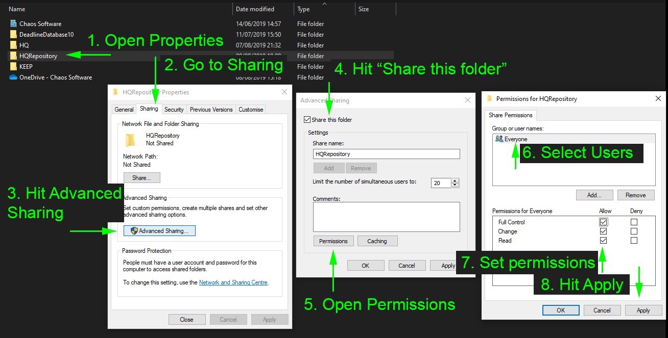

  1. Create a folder on the Windows machine that is going to store the main files repository for HQueue. In this example, the folder is called HQRepository.
  2. Right-click on the folder → PropertiesSharing tab.
  3. Press the Advanced Sharing button.
  4. Enable "Share this folder" so it is visible on the local network.
  5. Press the "Permissions" button to select the Users or Groups who can modify the contents of this shared folder.
  6. Select the Users who will be granted access.
  7. Set their permissions in the field below. Because the HQueue server and all clients will need both read and write access, in this example we've given full control to "Everyone".
  8. Press Apply and OK to close all windows.

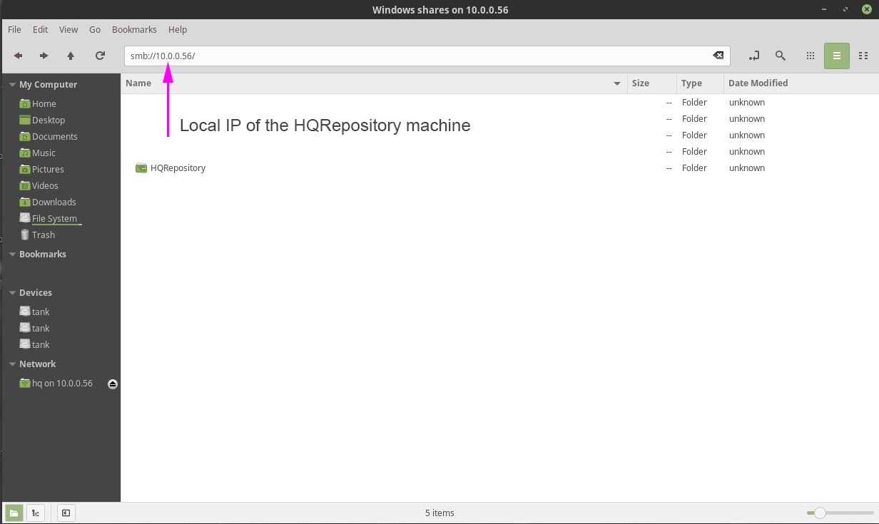

You can check if the shared folder can be accessed by the Linux machines using Samba.
In the file browser's address bar, type smb://x.x.x.x/HQRepository , where "x.x.x.x" is the local IP address of the machine hosting the shared folder.

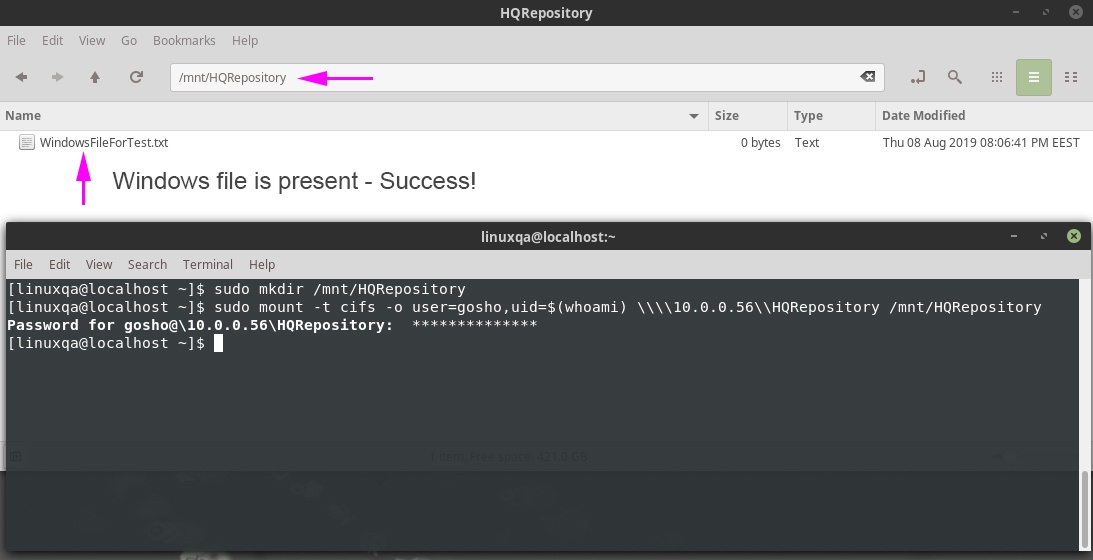

For the HQueue Server and Clients to access this folder, you need to mount it to a specific location.
Create a new HQRepository folder under /mnt on your Linux machines by calling:
sudo mkdir /mnt/HQRepository
Use the following command to mount the shared folder as /mnt/HQRepository
sudo mount -t cifs -o user=YOURUSER,password=YOURPASSWORD,uid=$(whoami) \\\\x.x.x.x\\HQRepository /mnt/HQRepository
where YOURUSER is the name of a Windows user with access rights to the share and YOURPASSWORD is the password of the user, if any.
x.x.x.x is the local IP address of the machine hosting the shared folder. This could also be the name of the machine, rather than the IP.
uid=$(whoami) is added for permission purposes. Houdini would not be able to write into this mounted folder if this is omitted because the owner would be root rather than the current user.

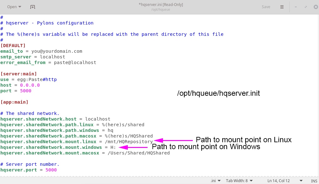

Once the installation is complete, open the /opt/hqueue/hqserver.ini file and edit:
  1. hqserver.sharedNetwork.mount.windows entry such that it points to the Windows mount point - this is the path used by Windows HQueue Clients.
  2. hqserver.sharedNetwork.mount.linux entry such that it points to the Linux mount point. In this example, /mnt/HQRepository.

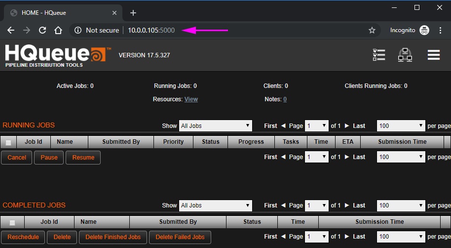

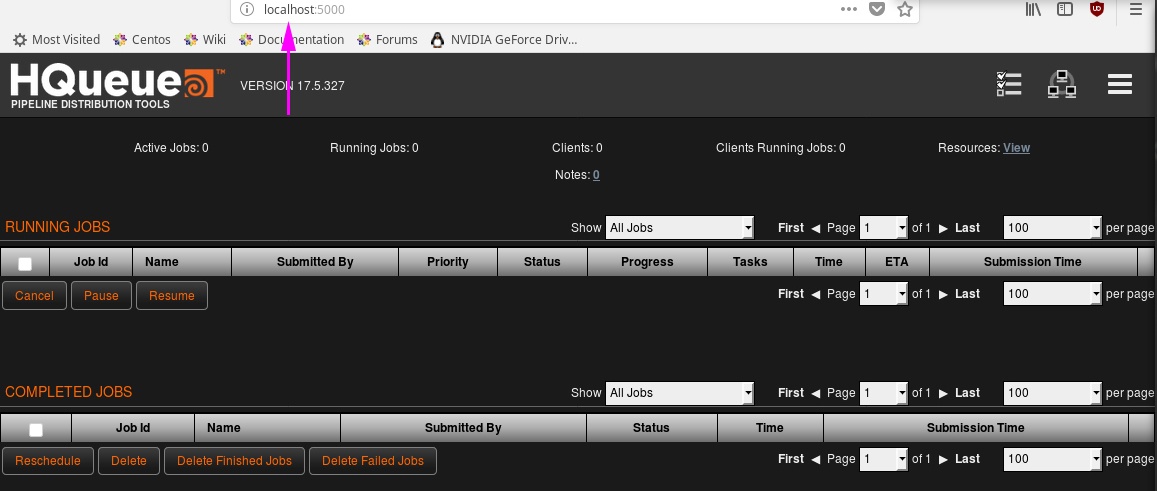

Open a browser and navigate to localhost:5000. If everything went well, you should be able to see the window from the screenshot to the right.
Try doing the same on another machine in the same network.
In this example, the internal IP of the Linux HQueue Server machine is 10.0.0.105, so 10.0.0.105:5000 is written in the address bar.
If the HQueue window shows up, you're good to go.
If you can't connect from a remote machine, this is most likely a firewall issue. Ports 5000 and 5001 have to be opened.

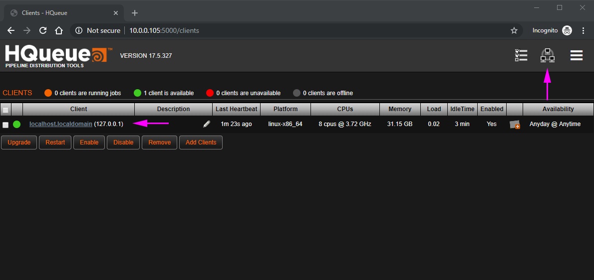

When prompted, specify the address and port of the HQueue server machine. E.g. 10.0.0.105:5000.
If you have already mounted the HQueueRepository folder, select NO when prompted for it by the setup.

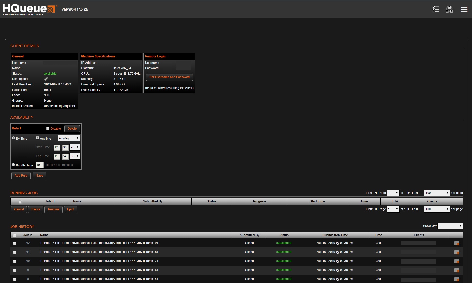

The Client should now be visible in the HQueue window as seen in the image to the right.

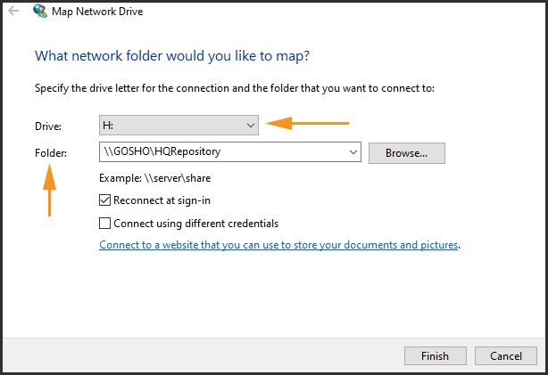

Before you submit jobs to the HQueue Server from your Windows workstation, you need to map the HQRepository shared folder to a Windows drive (e.g. H:\)
To do so:
  1. Open the File Browser and go to This PC.
  2. Press the Computer tab at the top and select "Map Network Drive".
  3. Choose a letter (e.g. H:) and point the "Folder" parameter to the shared HQRepository folder on the Windows host machine.
  4. If you required by your setup, enable the "Connect Using Different Credentials" option.

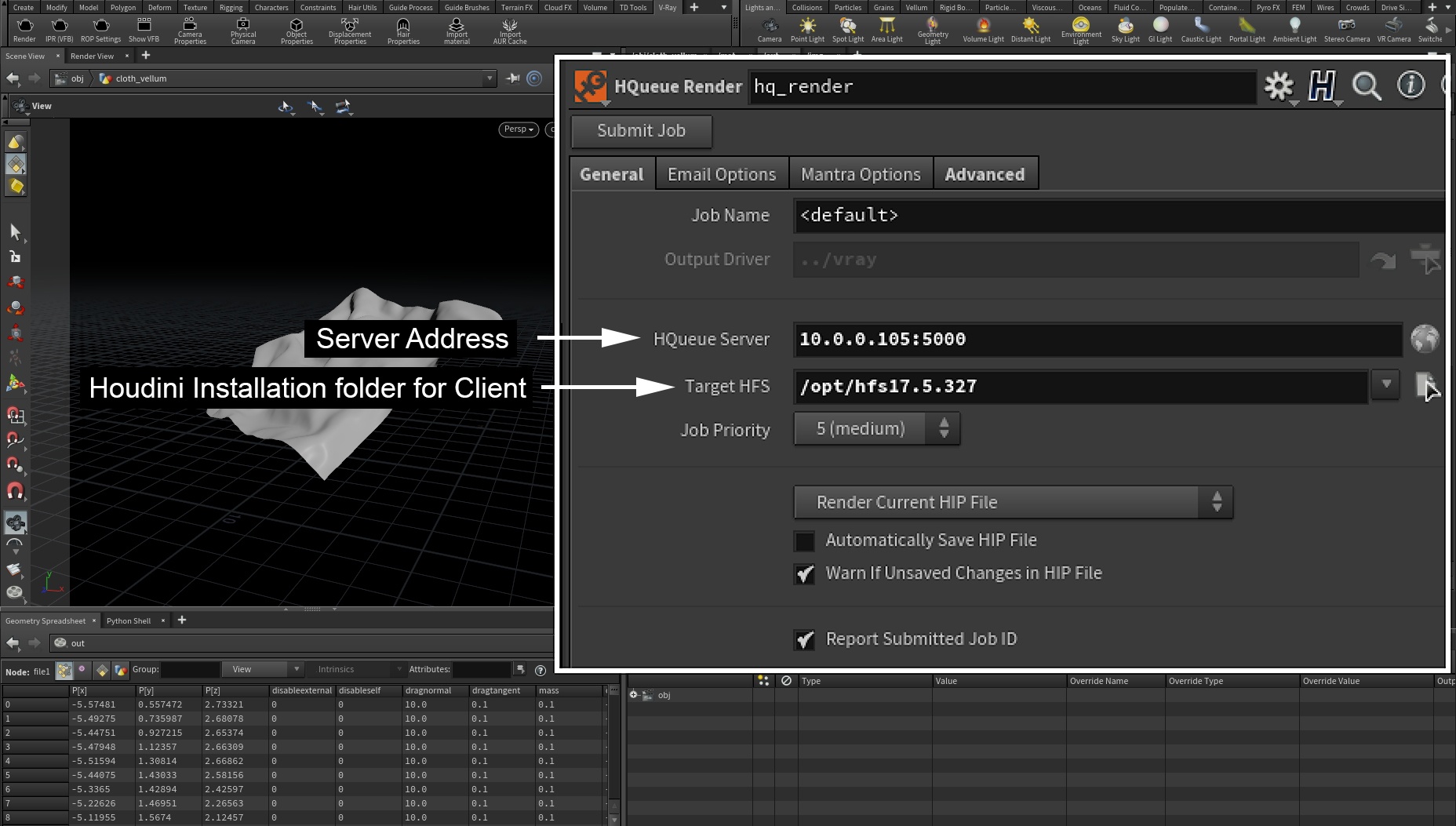

To render the scene with HQeueue, a HQueue Renderer ROP should be created.
Either plug the V-Ray Renderer ROP directly into the HQueue Renderer input or specify it under the General tab → Output Driver.
In this example, the HQueue Server address is 10.0.0.105:5000 (where 5000 is the port number).
The Target HFS parameter is used to specify the Houdini installation folder for the Client machines. In this example, the local path for the Client is "/opt/hfs17.5.327". If the Clients were Windows machines with a default Houdini installation, the path would be "C:\Program Files\Side Effects Software\Houdini 17.5.327".

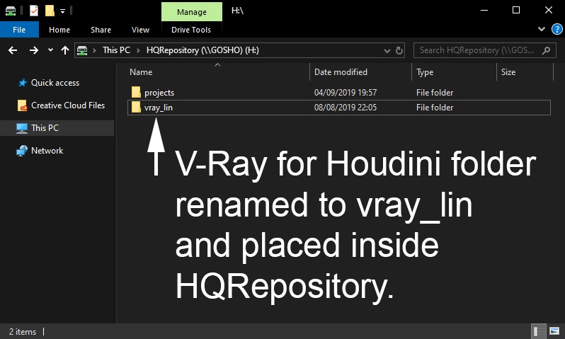

As mentioned already, the Client machines need to know where to find Houdini. The same is true for V-Ray.
The V-Ray for Houdini folder extracted from the archive is renamed to vray_lin (for simplicity) and placed inside the HQRepository so all client machines load V-Ray from the same location.

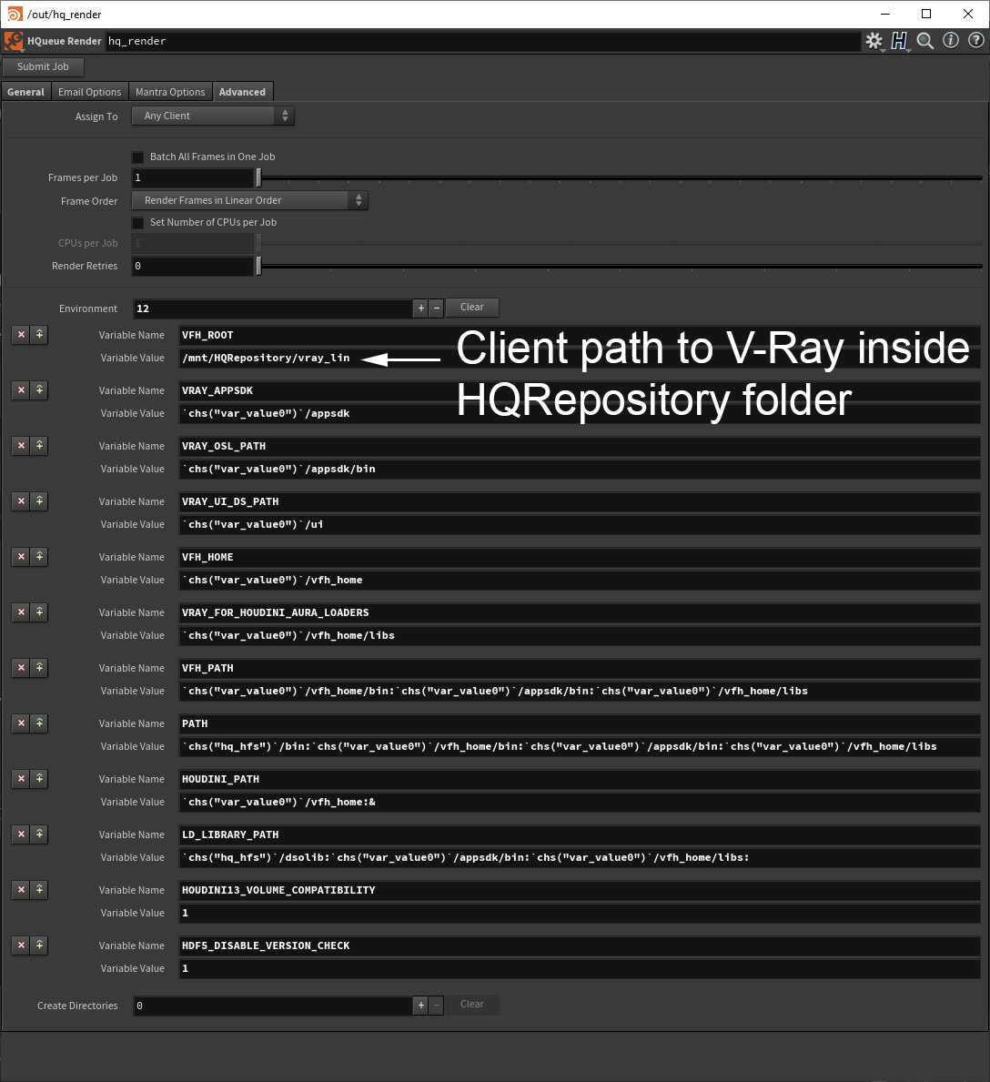

Listed below are the required environment variables that need to be set up under the HQueue Renderer → Advanced tab → Environment.
Consider saving this setup as a Preset from the Gear icon on the HQueue Render ROP.
VFH_ROOT
/mnt/HQRepository/vray_lin
VRAY_APPSDK
`chs("var_value0")`/appsdk
VRAY_OSL_PATH
`chs("var_value0")`/appsdk/bin
VRAY_UI_DS_PATH
`chs("var_value0")`/ui
VFH_HOME
`chs("var_value0")`/vfh_home
VRAY_FOR_HOUDINI_AURA_LOADERS
`chs("var_value0")`/vfh_home/libs
VFH_PATH
`chs("var_value0")`/vfh_home/bin:`chs("var_value0")`/appsdk/bin:`chs("var_value0")`/vfh_home/libs
PATH
`chs("hq_hfs")`/bin:`chs("var_value0")`/vfh_home/bin:`chs("var_value0")`/appsdk/bin:`chs("var_value0")`/vfh_home/libs
HOUDINI_PATH
`chs("var_value0")`/vfh_home:&
LD_LIBRARY_PATH
`chs("hq_hfs")`/dsolib:`chs("var_value0")`/appsdk/bin:`chs("var_value0")`/vfh_home/libs:
HOUDINI13_VOLUME_COMPATIBILITY
1
HDF5_DISABLE_VERSION_CHECK
1
Linux uses colons as separators in cases where the environment variable contains multiple individual paths (e.g. VFH_PATH). Windows uses semicolons instead.
Replace the colons ( : ) with semicolons ( ; ) in the strings for the VFH_PATH, PATH, HOUDINI_PATH and LD_LIBRARY_PATH variables if your render farm clients are running on Windows.

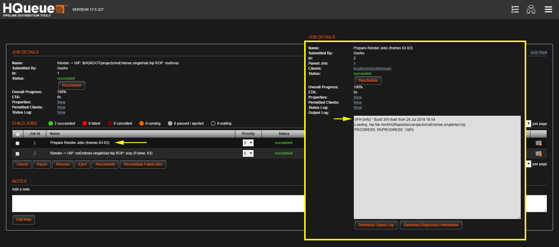

Save the hip file in the HQRepository folder and start a render.
You know the environment variables setup is correct and V-Ray is loaded if the following message appears in the Prepare Render Jobs entry of the log for the current job:
VFH [Info] * Build 3551ba6 from 26 Jul 2019 18:54

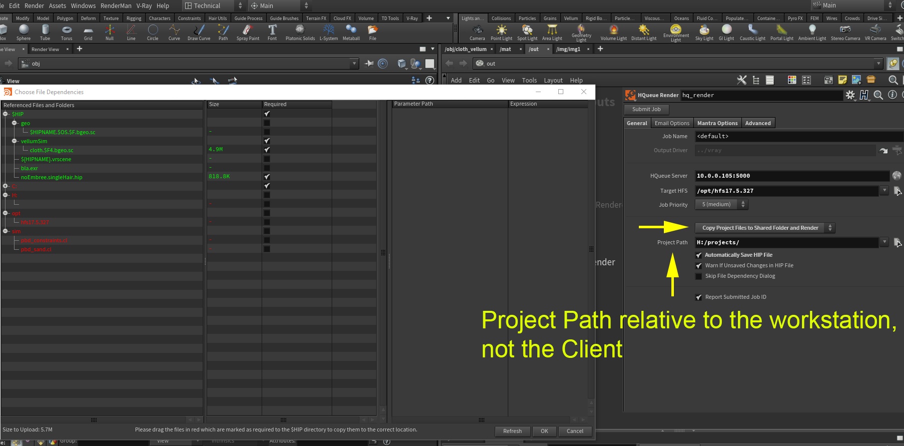

The default Render Current HIP File option expects the scene and all assets to be present in the HQRepository, with correct paths.
Alternatively, you may want to let Houdini take care of the project structure.
By default, setting the HQueue Renderer → General tab → Copy Project Files to Shared Folder and Render option only works with Mantra.

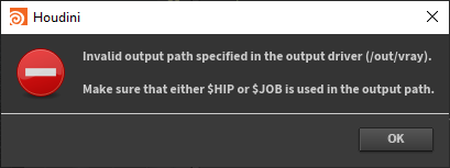

The following error appears if you attempt to Submit Job: "Invalid output path specified in output driver".

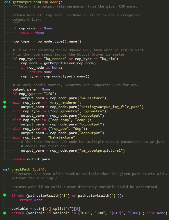

 Until the issue is resolved, a minor modification of a python file inside the Houdini installation folder is required.
To resolve this error, the following file inside the Houdini installation folder needs to be modified:
"C:\Program Files\Side Effects Software\Houdini 17.5.368\houdini\python2.7libs\hqrop.py"
Open the file in a text editor and add the following:
Inside getOutputParm(), under line 87 add:
elif rop_type == 'vray_renderer':
output_parm = rop_node.parm('SettingsOutput_img_file_path')
Inside checkPath(), replace line 139 with:
if not (path.startswith("$") or path.startswith("{")):
Inside checkPath(), replace line 143 with:
return (variable if variable in ("HIP", "JOB", "{HIP}", "{JOB}") else None)
Please make sure you've matched the indentation level!
Houdini should be restarted (if running) for the changes to take effect.
