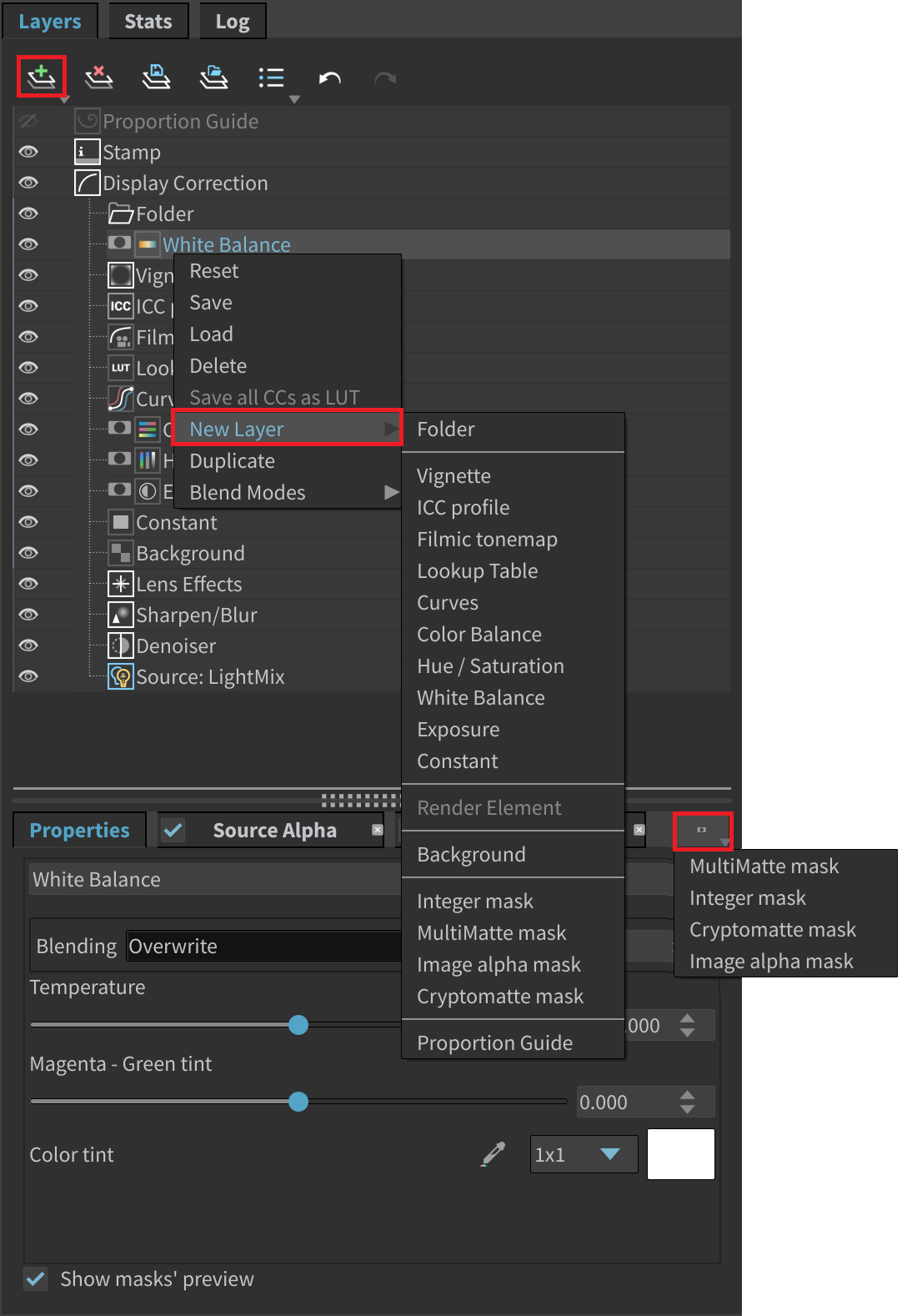

V-Ray Mask can be created using the Add layer button. The same option is available in the right-click context menu of the layer tree under the New layer category. There's also a quick Mask creation button in the Properties area of folders and layers.
When one or more masks are applied to a folder or layer, a mask icon is placed in front of it in the layer tree to signify its presence. The parameters of each mask are available in their own separate tabs to the Properties of the masked layer or folder.
Note that you must select a folder or a color correction layer to use masks. Otherwise, the masks are inactive.

– Allows you to add a new mask layer.
– Shows all tabs of the currently selected color correction layer.
When a mask is added to a layer, the Show masks' preview option is available in the layer's Parameters tab. This options shows a preview of the masks when selected.

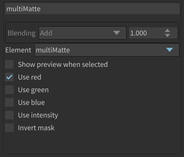

MultiMatte Mask
The MultiMatte Mask is based on the MultiMatteElement Render Element.
Note that this mask may not work on images rendered with older versions of V-Ray.
Use red – When enabled, uses the red channel as a grayscale mask.
Use green – When enabled, uses the green channel as a grayscale mask.
Use blue – When enabled, uses the blue channel as a grayscale mask.
Use intensity – When enabled, uses the pixel intensity as a grayscale mask.

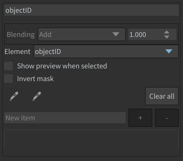

Integer Mask
The Integer Mask is used with VRayRenderID and VRayObjectID Render Elements. You can choose which IDs should be in the mask.
+/- Pick – Allows you to add/remove items by picking them from the Render View. When activated and the mouse is inside the Render View, a red square indicates where the value is exactly picked.
Value – Sows the mask ID on hover over the rendered frame. If you click on a selection in the Render View, the current ID is added/removed from the list below, depending on the Pick mode.
New item – A field to type a mask ID manually and then add it to the current selection with the + button.
+ – Adds IDs to the list.
- – Removes IDs from the list.
Each item in the list has a color icon. The color corresponds to the one saved in the respective render element.
Separate items in the list can be changed by double-clicking on them and editing their names.

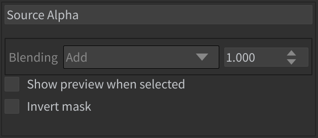

Image Alpha Mask
The Image Alpha Mask is based on the rendered Alpha channel.
Show preview when selected – Shows the preview of the image alpha.
Invert mask – Inverts the mask.

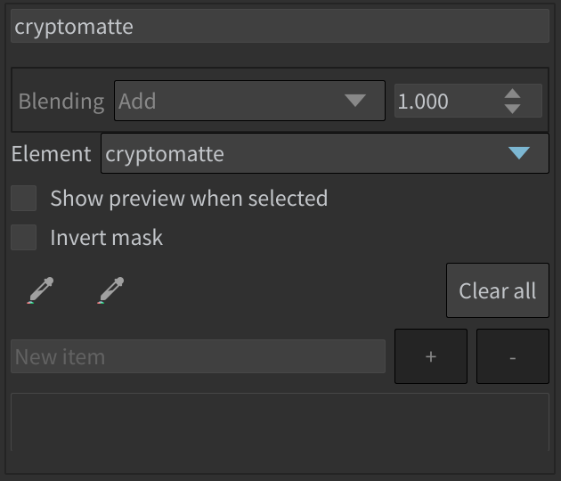

Cryptomatte Mask
The Cryptomatte Mask is based on the V-Ray Cryptomatte Render Element.
Value – Sows the mask ID on hover over the rendered frame. If you click on a selection in the Render View, the current ID is added to the list below.
New item – A field to type in a mask ID and add it to the current selection with the + button. The text is case insensitive.
Wildcards are allowed in the New item field. The following wildcard characters are supported:
* – matches any number of any characters including none (e.g. "Law*" matches "Law", "Laws", or "Lawyer")
? – matches any single character (e.g. "?at" matches "Cat", "cat", "Bat" or "bat")
[abc] – matches one character given in the bracket (e.b. "[CB]at" matches "Cat" or "Bat")
[a-z] – matches one character from the range given in the bracket (e.g."Letter[0-9]" matches "Letter0", "Letter2")
You can create Exclude items via the -Pick button. This is possible when you have wildcard items and then try to -Pick an item that is not present in the list. For example, we can add all boxes from the scene with a wildcard Box* and then exclude only Box001 with an Exclude item. Exclude items have a minus in their icon so they can be distinguished.
