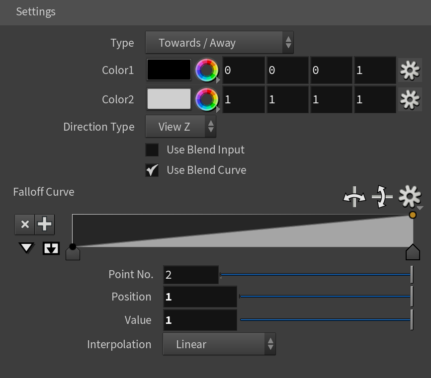

Type – Specifies the type of falloff:
Towards/Away – Based on face normal directions. Faces with normals that point in the Direction Type generate Color 1 while those facing in the opposite direction (180 degrees off the falloff direction) generate Color 2
Perpendicular/Parallel – Based on face normal directions. Faces with normals that point in the Direction Type generate the Color 1 while those facing in a perpendicular direction (90 degrees off the falloff direction) generate the Color 2.
Fresnel – Based on changes to the index of refraction (IOR) over the surface due to Fresnel calculations. Faces with normals that point in the Direction Type generate the Color 1 and those facing in other directions generate varying colors depending on the IOR set by Fresnel Ior
Distance Blend – Sets the falloff range based on distance from the camera, as specified by Distance Near and Distance Far. This option is useful for generating a Z-depth type of map when rendering a very large object such as terrain, where the Falloff Map can be used as a mask to dim distant details. For more information, see the Distance Falloff Type example below.
Color 1/2 – Sets the extreme ends of the range of colors for the Falloff Map's gradient. The specific placement of these colors on the surface is determined by Type and Direction Type.
Direction Type – Specifies the falloff direction to be used by the Falloff Type.
Distance Extrapolate – Enables extrapolate for the distance blend falloff type.
Distance Near – Specifies near distance for the distance blend falloff type.
Distance FarSpecifies far distance for the distance blend falloff type.
Fresnel IOR – Specifies IOR for the Fresnel falloff type.
Use Blend Input – Enables the Blend Input parameter for controlling the blending.
Blend Input – Specifies the final blending amount that is taken from the texture.
Use Blend Curve – Enables the Blend Curve for controlling the blending.
Falloff Curve –  Specifies the falloff direction to be used by the Direction Type:

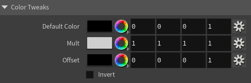

Color Tweaks
Default Color – Specifies the color when there are no valid UVW coordinates.
Mult – Specifies a strength multiplier for the texture color.
Offset – Color corrects the texture by adding the RGB color values specified here to the RGB color values in the texture.
Invert – When enabled, inverts the resulting texture color.

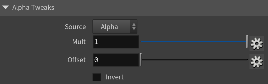

Alpha Tweaks
Source – Specifies where the alpha channel is drawn from:
Alpha – Alpha channel is drawn from the texture.
Color
– Alpha is generated from pixel intensity.
Opaque
– Alpha channel is fully opaque.
Use – Differentiates between textures exported from different applications. You can choose between Color Intensity (3ds Max) and Color Luminance (Maya).
Mult – Specifies a multiplier for the texture alpha.
Offset – Specifies an additional offset for the texture alpha.
Invert – When enabled and Invert from Color Tweaks is also on, the resulting texture alpha is inverted as well.

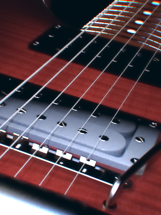

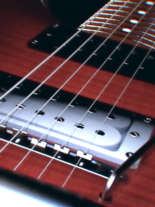

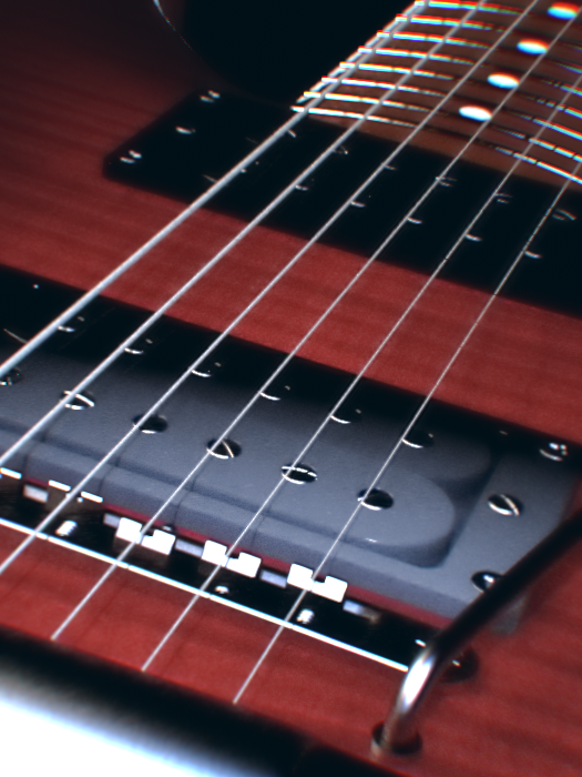

Example: Distance Falloff Type
In the example below, the Type has been set to Distance Blend and mapped to the diffuse color of the V-Ray Material on the humbucker pickups on the guitar.
  Distance Near: 0, Distance Far: 27
Distance Near: 15, Distance Far: 27
 Distance Near: 20, Distance Far: 27

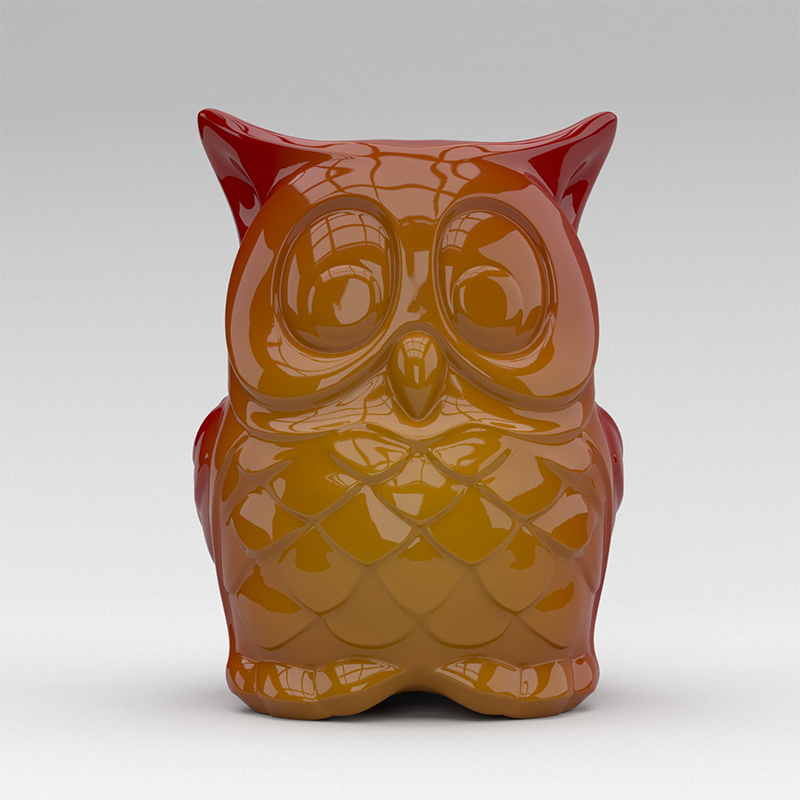

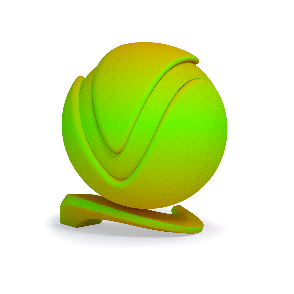

Example: Falloff Colors

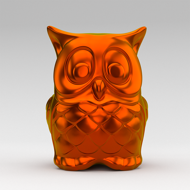

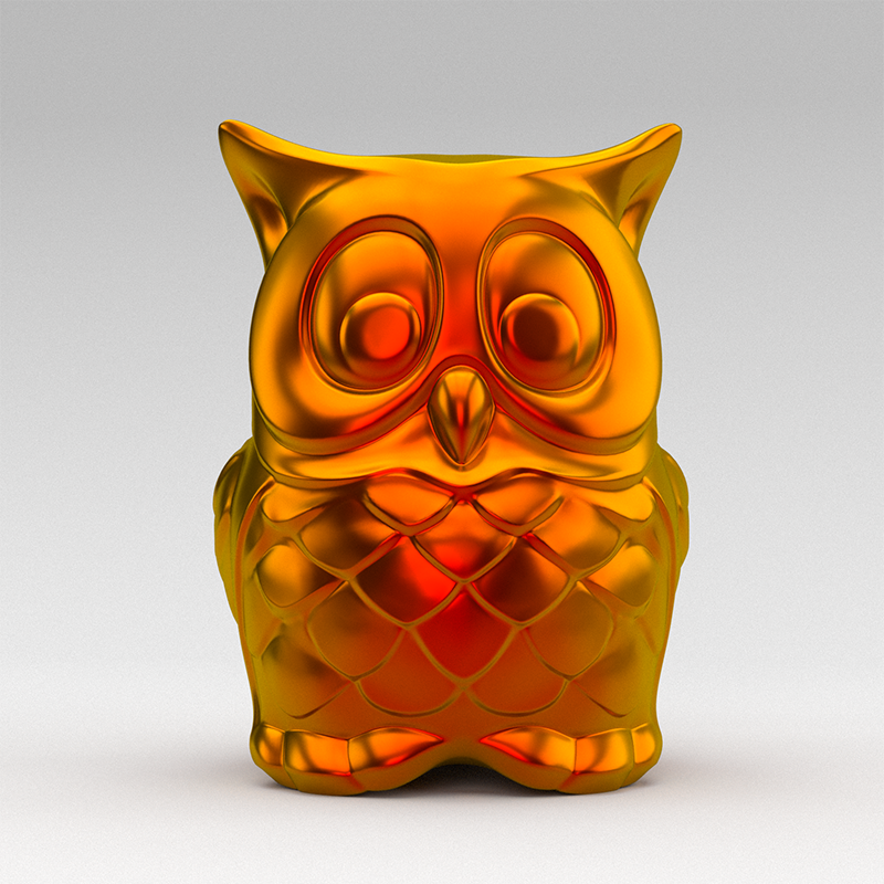

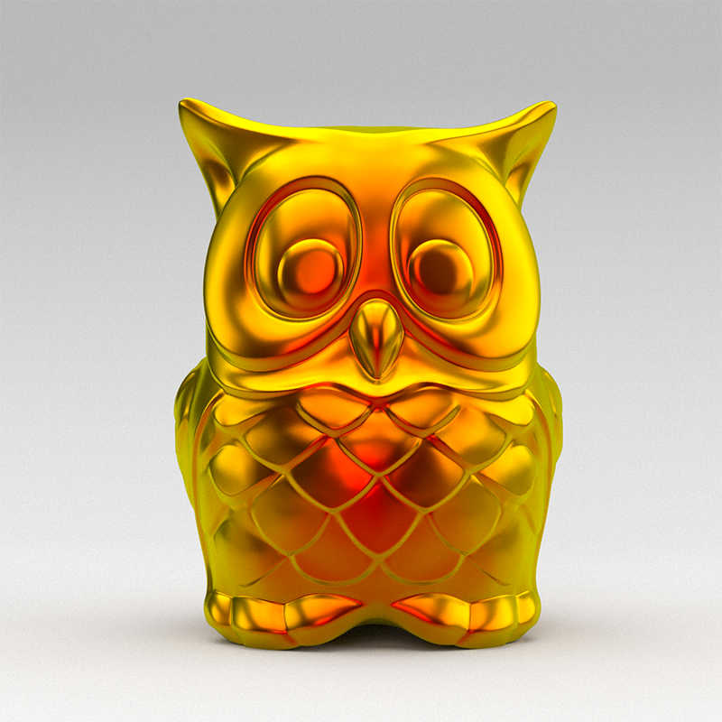

This example shows how Color 1 and control the range of colors for the V-Ray Falloff's gradient when the texture is mapped to the V-Ray Material Diffuse slot. Color 1 is the main color for the object, while Color 2 gives it a tint. The distribution of Color 1 and 2 can be controlled by the Falloff Type and Falloff Direction Type parameters.
Here, we've set red as Color 1 and yellow as Color 2. The Falloff Direction Type is View Z. By changing the Falloff Type, we control the gradient spread.
Type = Towards/Away
Type = Perpendicular/Parallel
Type = Fresnel
Type = Distribution Blend (Distance Far = 5.8)
Move the slider to see the example renders.

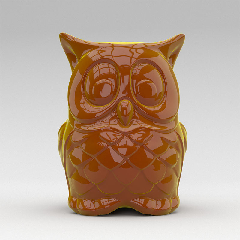

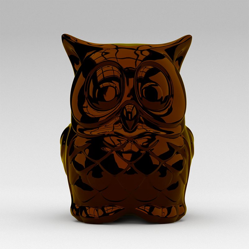

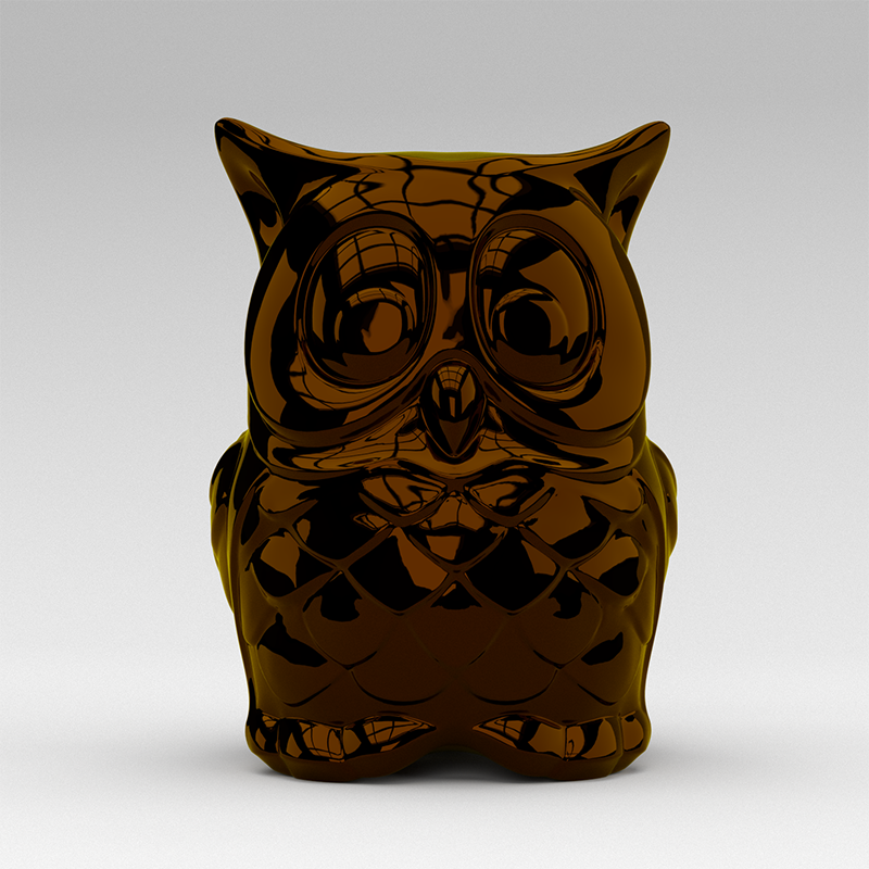

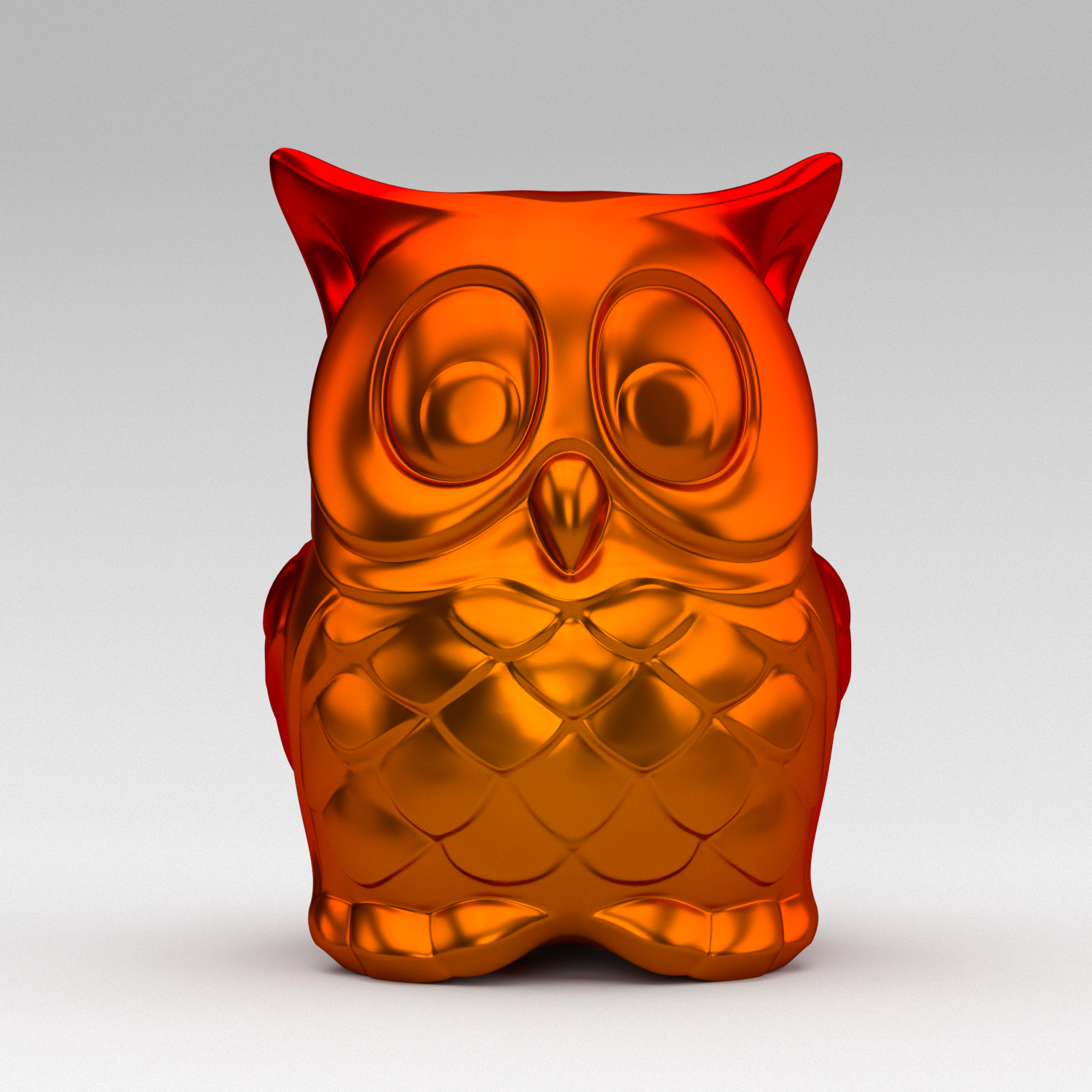

Example: Falloff Type

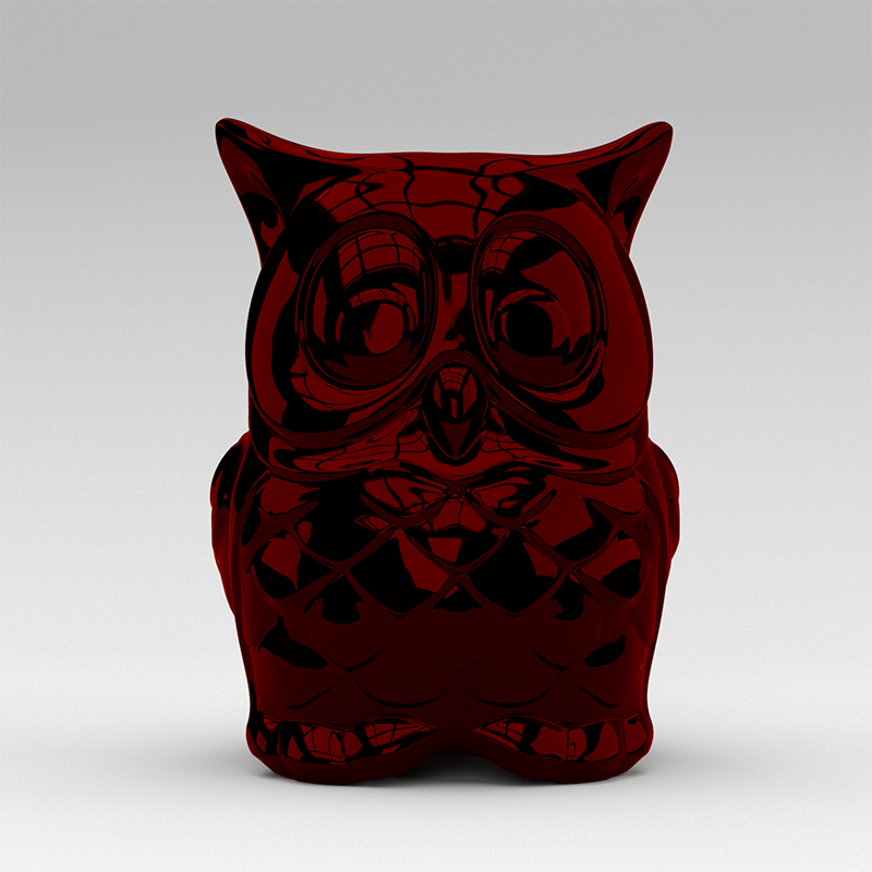

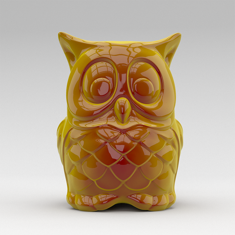

This example shows how the different Falloff types affect the object's reflection.
Here, we have a V-Ray Falloff texture mapped to the Reflection color of a V-Ray Material. The Falloff Direction Type is set to View Z. Red and yellow are set as Color 1 and Color 2.
Type = Towards/Away
Type = Fresnel

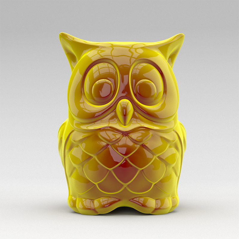

Example: IOR
This example shows how the Fresnel IOR values affect the renderer.
Here, the V-Ray Fresnel texture is mapped to the Reflection color of a V-Ray Material. Color 1 and 2 are set to red and yellow respectively. The Falloff Type is set to Fresnel, and the Falloff Distance Type is set to View Z.
Fresnel IOR = 1
Fresnel IOR = 1.5
Fresnel IOR = 2
Fresnel IOR = 2.5
Fresnel IOR = 3
