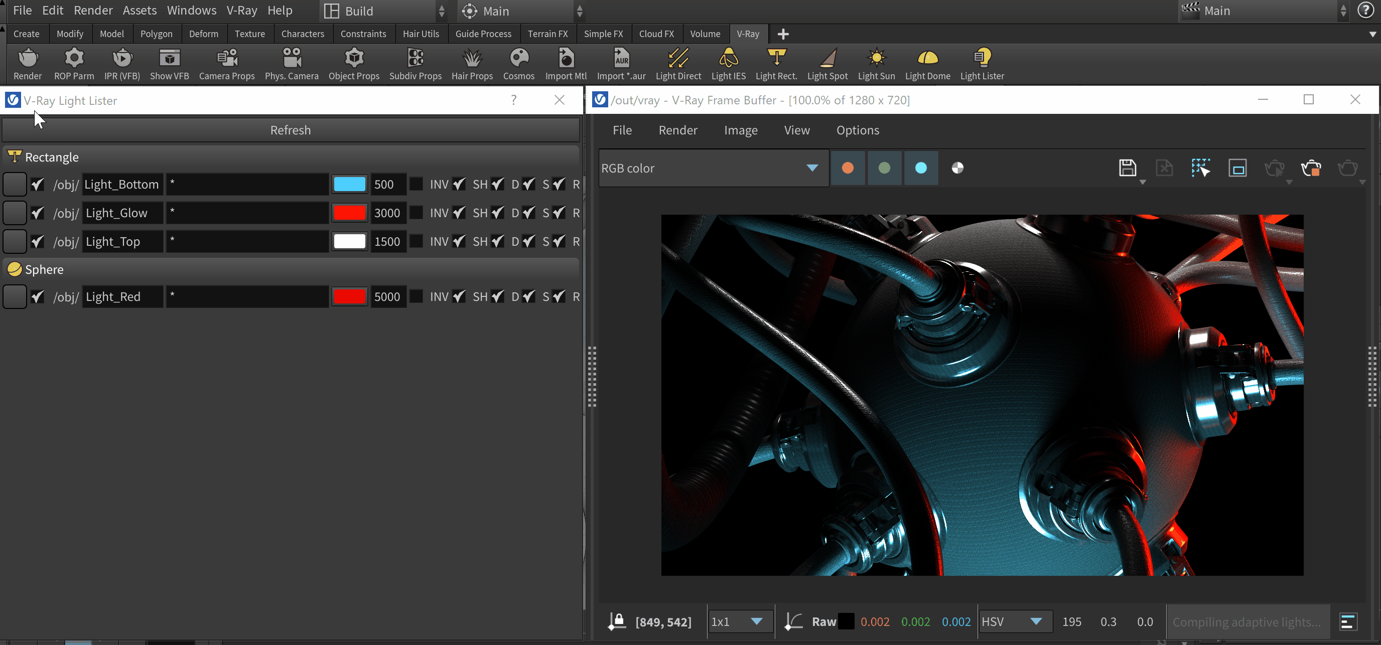

The V-Ray Light Lister window provides an easy way to modify common attributes of all of the lights in the scene.
V-Ray Light Lister window position can be reset from V-Ray menu > Settings > UI > Reset Light Lister Window.

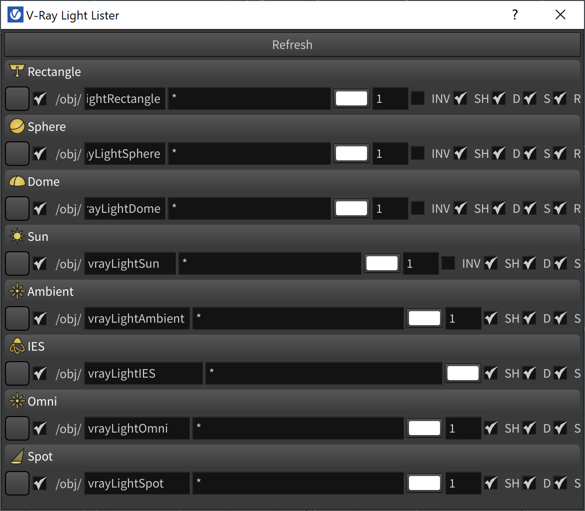

General Light Lister Parameters
Refresh – Updates the listed lights if lights have been added or removed from the scene.
Isolate – When enabled, isolates a single light for IPR. The isolated light is on in the scene, while all other lights are turned off. See the Example below.
Enable – Enables the light in the scene. See the Example below.
Color – Specifies a color for the light.
Intensity – Specifies the intensity of the light.
Invisible – When enabled, the shape of the light source is invisible in the rendered image.
ShadowsWhen enabled, the light casts shadows. Disable this option to turn off shadows for the light.
Affect Diffuse – When enabled, the light affects the diffuse properties of the material.
Affect Specular – When enabled, the light affects the specular of the materials.
Affect Reflection – When enabled, the light appears in reflections of the materials.
