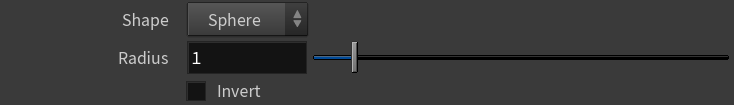

Shape – Specifies the gizmo shape:
Sphere
Box
Cylinder
Radius – Controls the size of the gizmo shape.
Invert – Inverts the volume that is shaded, rendering the part of the scene that is outside the sphere.

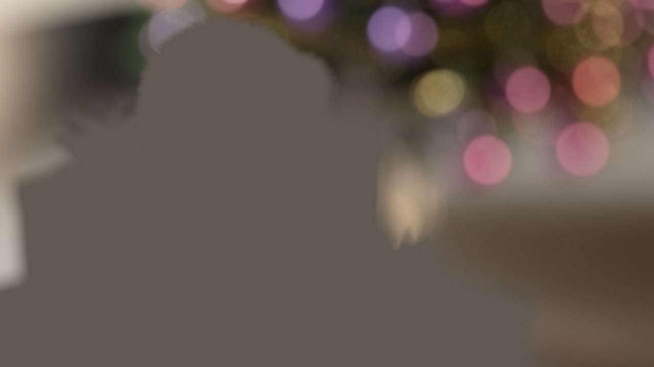

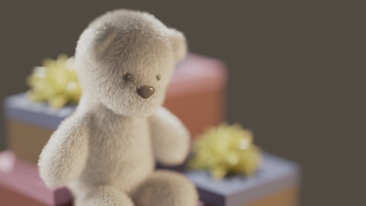

Example: Invert
The Invert can be turned on to only show everything visible in the scene outside of the Sphere fade volume. In the example shown below, a Falloff value of 0.2 has been used.
OFF
ON
