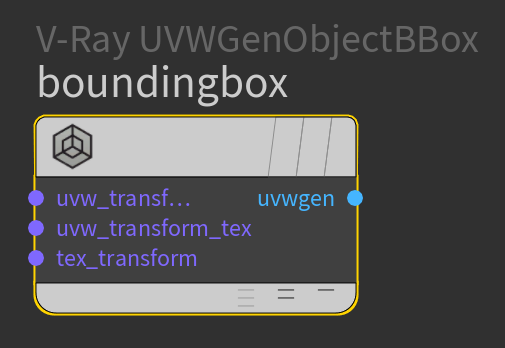

This page provides information on the V-Ray UVWGenObjectBBox node.
The V-Ray UVWGenObjectBBox node allows you to use Bounding Box mapping within the Mat Network.

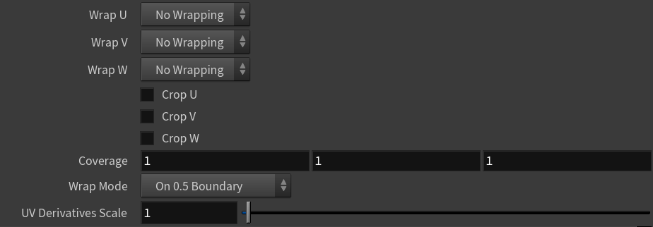

Wrap U / V / W – Specifies the type of wrapping:
No Wrapping
Wrap
Mirror Tile
Crop U / V / W – When enabled, cropping occurs in the specified direction.
Coverage – Specifies the UVW coverage.
Wrap Mode – Specifies one of the following wrapping modes:
On 0.5 boundary
On integer boundary
UV Derivatives Scale – Specifies an additional scale factor for the texture derivatives.
