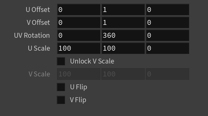

Variances
U Offset – Controls the position of the texture along the U axis.
V Offset – Controls the position of the texture along the V axis.
UV Rotation – Rotates the texture along the U or V axis.
U Scale – Scales the texture along the U axis.
Unlock V Scale – Enables scaling along the V axis. When disabled, the V Scale is the same as the U Scale.
V Scale – Scales the texture along the V axis.
U Flip – Flips the texture on a random principle along the U axis.
V Flip – Flips the texture on a random principle along the V axis.
Hou20_VRay6.2_UVWRandomizer_Variance
