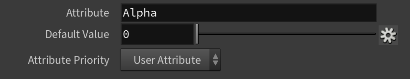

The V-Ray User Float texture allows the user to read and return a single number value from the User-Defined properties of the currently shaded object as a result. This can be useful if the same material or texture is applied to several objects in the scene, but we want to control some of its aspects (i.e. material glossiness, or a blend between two other textures inside a Mix texture etc.) with User-Defined properties.
Attribute – Specifies the name of the user attribute that is looked up and returned from this shading node.
Default Value  Specifies the value to return if the user attribute is not found on the shaded object.
Attribute Priority – Specifies the attribute priority of V-Ray User Float.

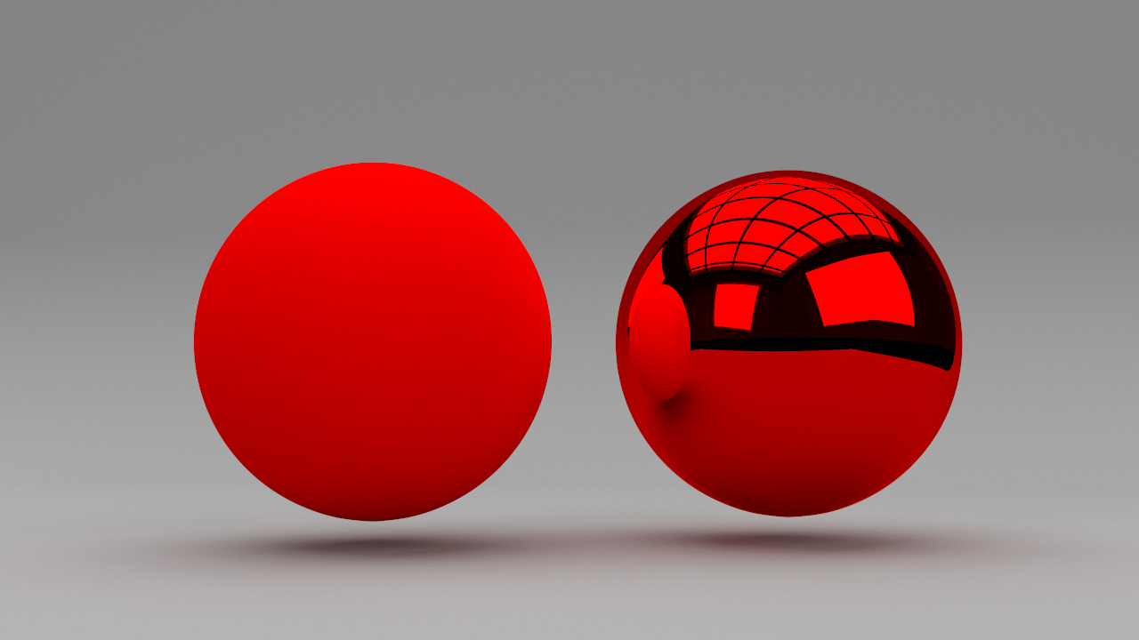

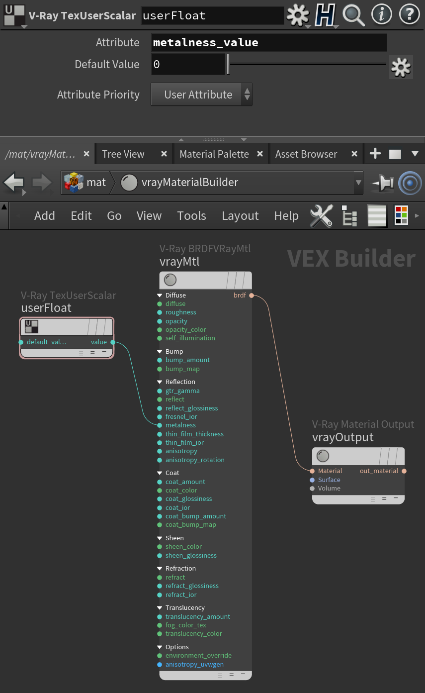

Example: V-Ray Float controlling metalness
This example shows the format for the value of the user attribute and how it is interpreted. The V-Ray User Float texture controls the V-Ray Material Metalness parameter. A user attributed named metalness_value is used to specify different metalness values on two objects.
The same material is applied to both objects. A V-Ray User Float texture passes the values to the shader.

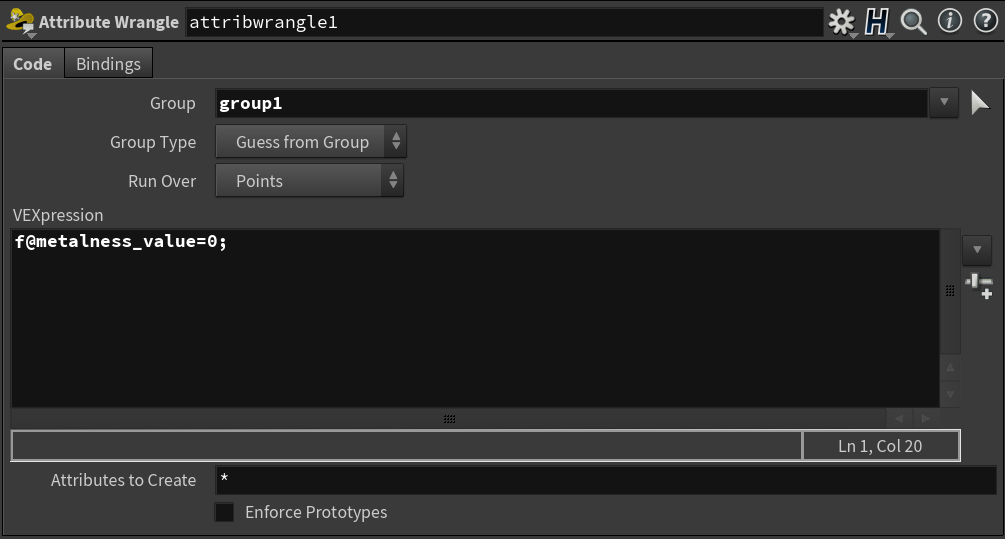

User attribute for the first object
User attribute for the second object
Although the two objects have the same material, the metalness is determined by the user property.

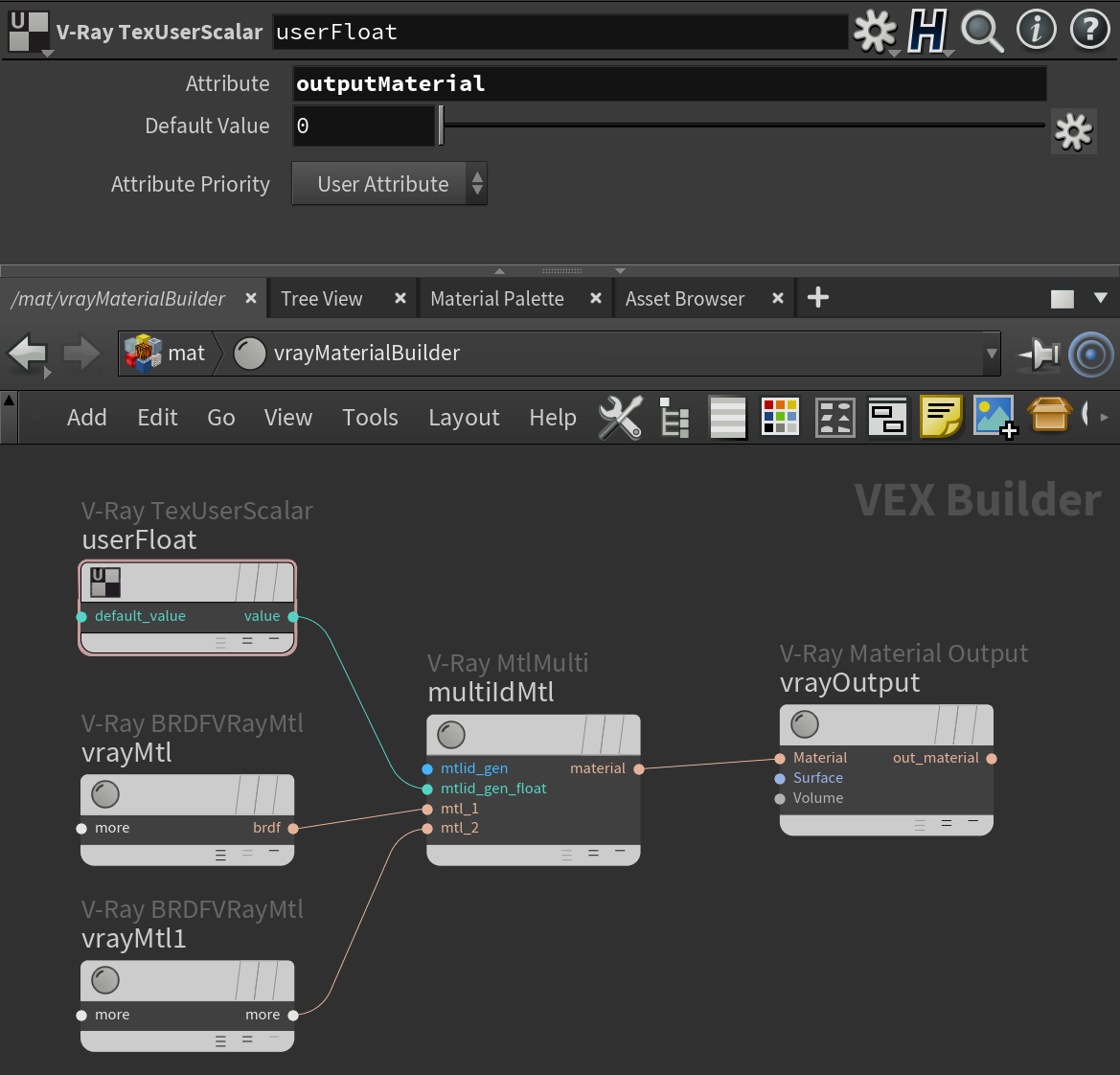

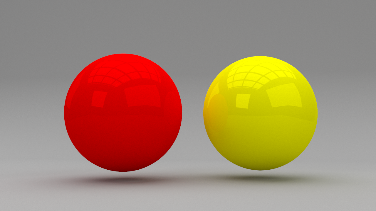

Example: V-Ray User Float with V-Ray Multi ID Material
This example uses V-Ray User Float to control how materials from a V-Ray Multi ID Material are distributed to different objects.
Two different V-Ray Materials are linked as Material 1 and Material 2 in a V-Ray Multi ID Material. A V-Ray User Float is linked to the mtlid_gen_float slot and a user attribute named outputMaterial drives the material distribution.
The same V-Ray Multi ID Material is assigned to two spheres and the V-Ray User Foat texture determines how Material 1 and 2 are distributed between the spheres.

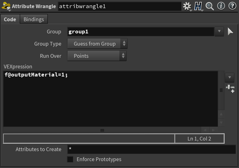

The left sphere received Material 1 and the right sphere received Material 2
