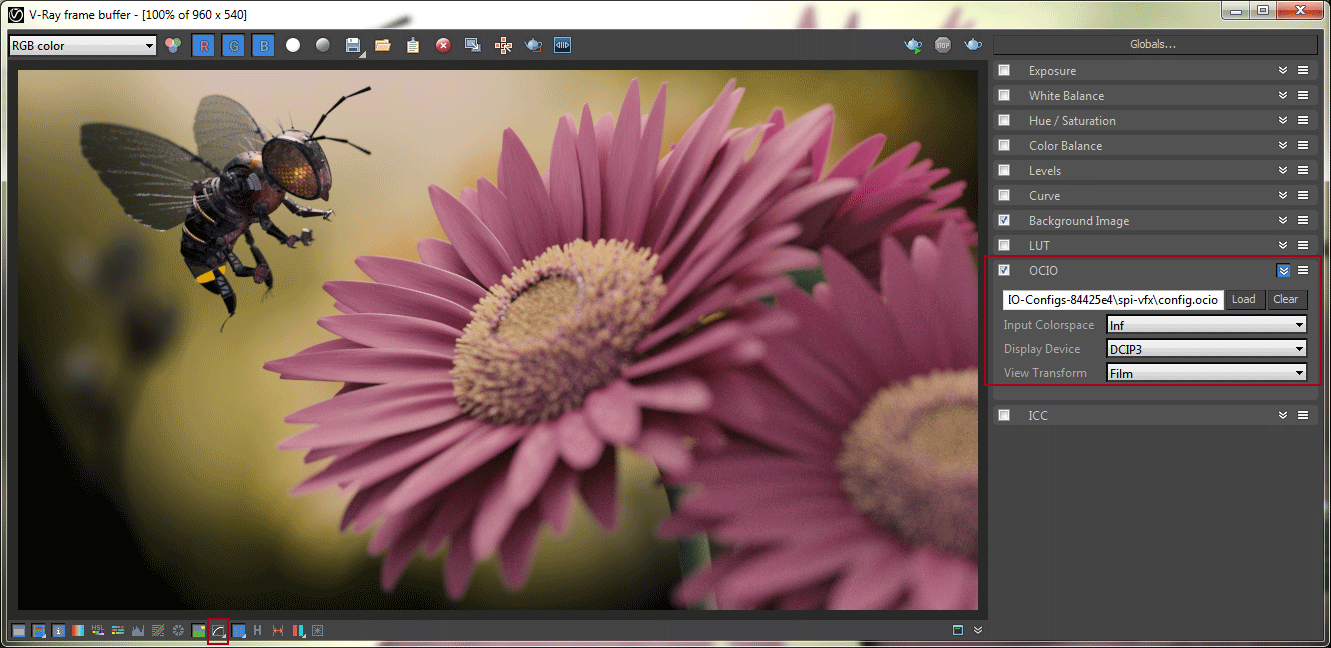

Applying an OCIO in 3ds Max
1.  Open the Correction controls in the VFB.
2.  Turn on Use OCIO Correction and browse for the required OCIO.  (In this case, a spi-vfx OCIO file has been used in the following examples).
3. Ensure that Input Colorspace is set to Inf, Display Device is set to DCIP3 and View Transform is set to Film.
4. Make sure that Display colors in sRGB space is turned off.
3ds Max beauty render with no OCIO applied
The 3ds Max beauty render with the spi-vfx OCIO applied.
