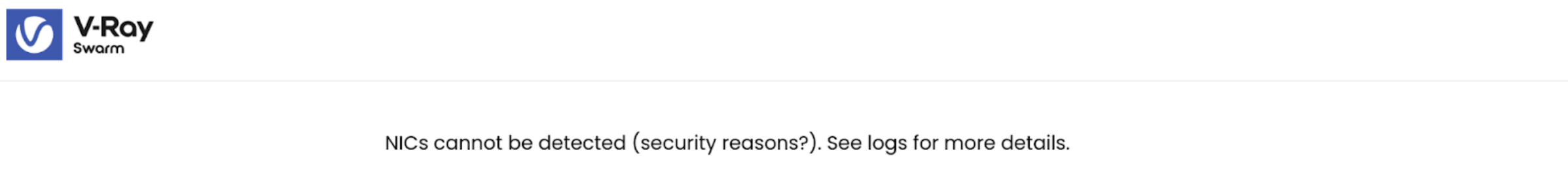

If Swarm still does not locate any NICs, it displays the following message in the http://localhost:1113 Admin panel.
And in the Swarm log displays the following information:
[INFO - app] Running Swarm v2.0.15 7849af98
[WARN - app] Running in fallback mode [NO NICS]
In this case, set NICs manually via the swarm.yaml settings file. Currently, Swarm supports only IPv4.
