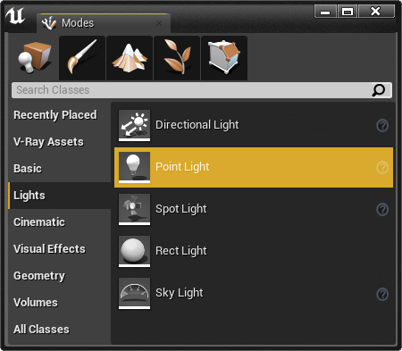

UI Path
||Modes Tab|| > Lights > Point Light
