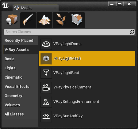

UI Paths
 The VRayLightMeshBlueprint Actor is accessible through the Modes > V-Ray Assets > VRayLightMesh. Select the Blueprint and drag and drop it in the level.
||Modes Tab|| > V-Ray Assets VRayLightMesh

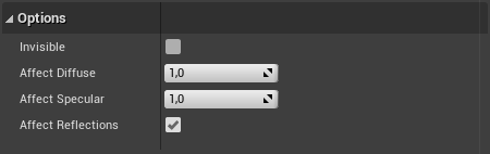

Options
Invisible – Controls whether the shape of the light source is visible in the rendered image. When this option is disabled, the light source is rendered in the color specified by the Color setting. This option only affects the visibility of the light when seen directly by the camera or through refractions.
Affect Diffuse –  Determines whether the light will affect the diffuse portion of the materials. The value controls the light's contribution to the diffuse portion of the materials (No effect in viewport).
Affect Specular –  Determines whether the light will affect the specular portion of the materials. The value controls the light's contribution to specular reflections (No effect in viewport).
Affect Reflections  Determines whether the light source will appear in reflections (No effect in viewport).
