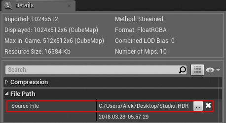

For your materials to work properly at render time make sure your textures have a valid file path (Source File in the texture Details panel). V-Ray loads the textures from that directory during rendering. If the texture is not found at the specified location, V-Ray will automatically export the texture. You can then find it in your project folder > Content > Texture Cache.

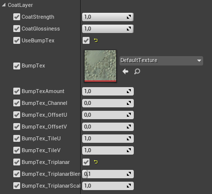

Specifies the properties of the top coat layer of the car paint with additional reflection and bump properties.
  • CoatStrength – Specifies the strength of the Clear Coat layer.
  • CoatGlossiness – Controls the sharpness of reflections of the Clear Coat layer. A value of 1.0 means perfect mirror-like reflection; lower values produce blurry, or glossy, reflections.
  • UseBumpTex – Enables the use of Texture for Bump of the Clear Coat layer.
  • BumpTex – Specifies the Bump Texture for Clear Coat layer when UseBumpTex is enabled.
  • BumpTexAmount – Specifies the bump amount of the Clear Coat layer.
  • BumpTex_Channel – Specifies the UV channel index for the BumpTex of the Clear Coat layer.
  • BumpTex_OffsetU – Specifies the horizontal offset of the BumpTex of the Clear Coat layer.
  • BumpTex_OffsetV – Specifies the vertical offset of the BumpTex of the Clear Coat layer.
  • BumpTex_TileU – Specifies the horizontal repetition of the BumpTex of the Clear Coat layer.
  • BumpTex_TileV – Specifies the vertical repetition of the BumpTex of the Clear Coat layer.
  • BumpTex_Triplanar – Enables triplanar mapping for the BumpTex of the Clear Coat layer.
  • BumpTex_TriplanarBlend – Specifies the blend amount between the different Texture projections. Lower values produce sharper transitions between projections.
  • BumpTex_TriplanarScale – Adjusts the scale of the BumpTex of the Clear Coat layer when BumpTex_Triplanar is enabled.
