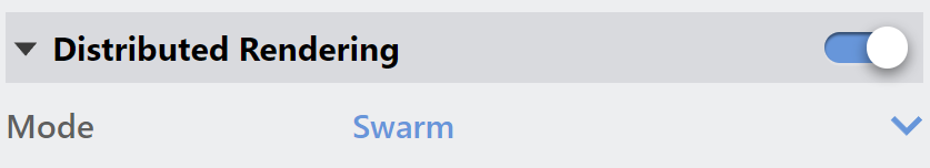

Distributed Rendering
Enabled – Turns Distributed Rendering on and off.
Mode – Selects the Distributed Rendering mode. You can select from Classic DR and Swarm.

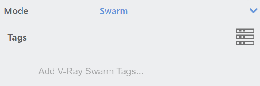

Tags
Tags allow you to tag this node with a descriptor that defines something about the machine, which we can later use to selectively control from inside Revit.
For example, tags can denote whether this machine is one of a few with a powerful GPU or if it is not a workstation or a node on a render farm.
For information on how to use Tags, see the Swarm Configuration page.
Once the render process is initiated, machines marked with the selected tags load the scene and assist with the rendering.

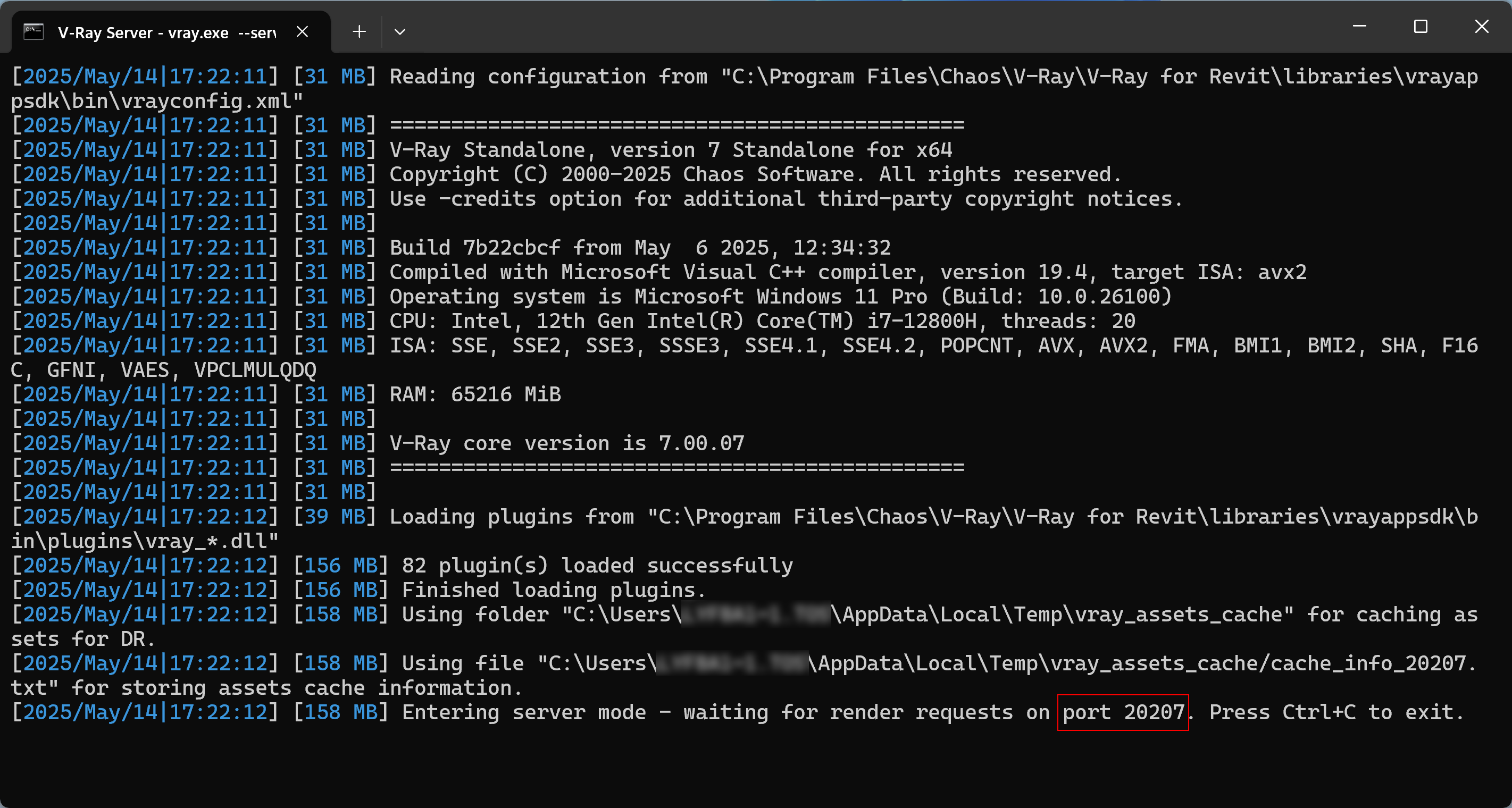

Obtaining Server Port
Start the V-Ray Server and locate the port displayed in the command output.

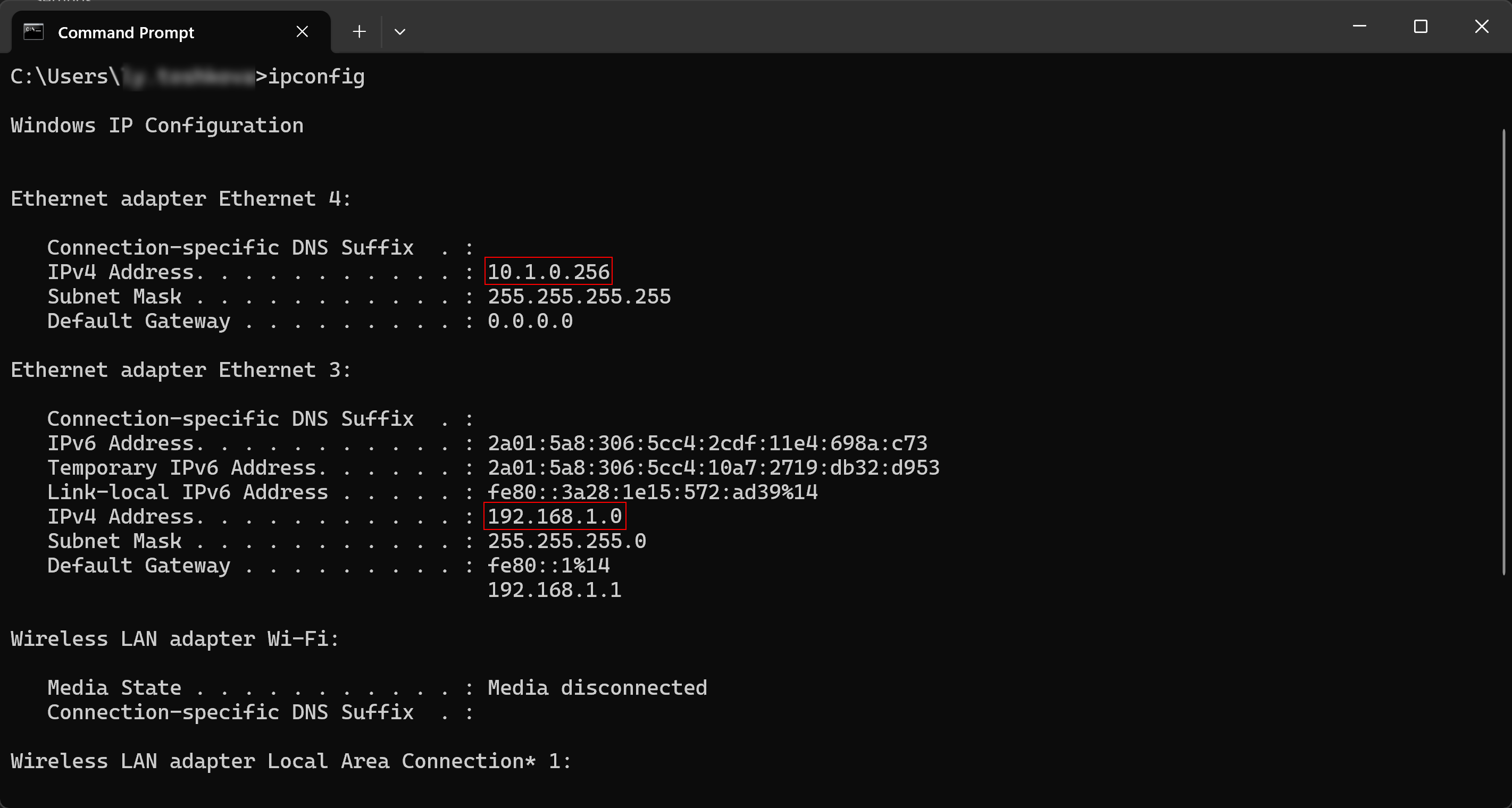

Obtaining Server IP
The IP can be obtained by executing the ipconfig command in a separate Command Prompt. There might be multiple IP addresses depending on the configuration of the machine. Which one to use depends on how the server is accessed (wireless, Ethernet, etc).
