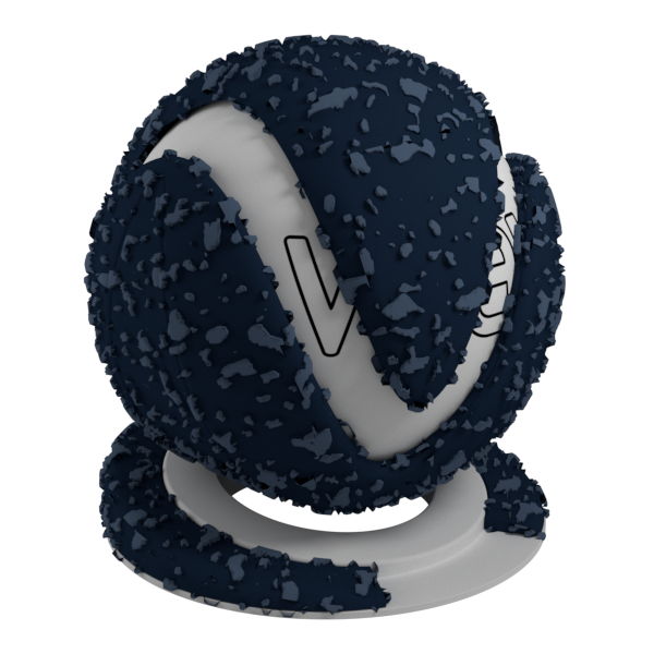

The Splat texture is a procedural texture that mimics a splatter effect similar to the way paint can splatter onto a surface. Both of its two colors channels can be connected to texture maps.

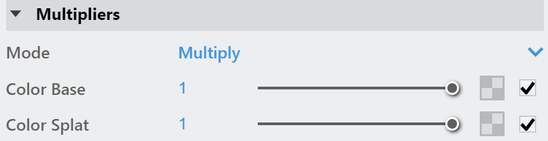

Multipliers
Mode – Specifies the multiplication mode of the colors.
Multiply – Multiplies the RGB numbers for each pixel of the top layer with the RGB number of the corresponding pixel from the bottom layer. The result is a darker picture. The color used for blending is black.
Blend Amount  Takes each pixel from the top layer if present. Otherwise the bottom layer is used. The color used for blending is the one specified in the color slot.
Color Base – Blends between a color and a texture, if specified.
Color Splat – Blends between a color and a texture, if specified.
