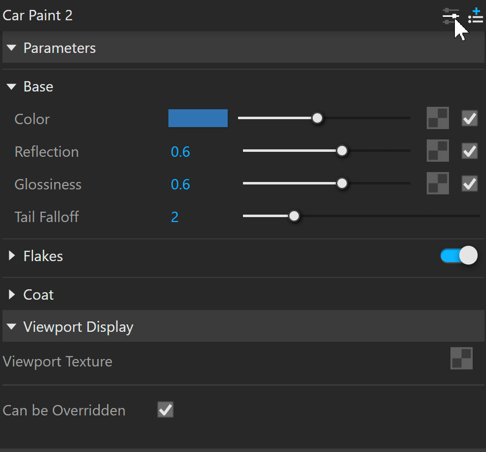

The Car Paint 2 material settings are organized in Basic and Advanced modes. You can switch the mode from the toggle button under the Preview Swatch or globally from the Configuration rollout of the Settings tab.
From the Add Attribute button, you can select additional attributes that can add up to the appearance of the material. For more information, see the Add Attribute section.
Holding down Ctrl while having the Add Attribute or Add Layer menu open, allows selecting multiple entries without closing the dropdown.
The context menu of the Color slot provides options to Copy and Paste, as well as to Reset the color.
A Reset option is provided in the context menu of each Number Slider.
Some parameters are available only in Advanced mode.

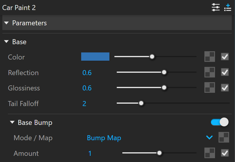

Base
Color – Specifies the diffuse/reflection color for the base layer.
Reflection – Controls the reflectivity of the base layer. The reflection color itself is the same as the Base color.
Glossiness – Controls reflection glossiness for the base layer.
Tail Falloff – Controls the transition from highlighted areas to non-highlighted areas. Higher values make the transition sharper, while lower values make the transition more diffuse.
Base Bump
Mode/Map – Specifies the type of bump map or normal map to apply to the base layer if a map file is specified.
Bump Map – A height map should be used.
Normal Map – RGB normal map should be used. Note that in most cases the normal map bitmap color space should be set to Linear to ensure correct results.
Local Space Bump – A height map should be used. Unlike the standard Bump mode, in this case the height is not measured in scene units. It is only determined by the raw texture values. Scaling objects will not affect the local space effect. This option has to be selected for the round edges effect (Edges texture used as bump).
Amount – A multiplier for the bump/normal effect.

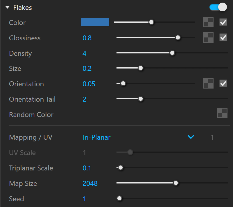

Flakes Parameters
Color – Specifies the color of the metal flakes.
Glossiness – Controls the glossiness of the metal flakes. It is not recommended to set this above 0.9 as it may produce artifacts.
Density – Controls the number of flakes for a certain area. Lower values produce less flakes and higher values produce more flakes. Set this to 0.0 to produce a material without flakes.
Size  Controls the size of the flakes relative to the distance between them. Higher values produce bigger flakes and lower values produce smaller flakes.
Orientation – Controls the orientation of the flakes relative to the surface normal. When this is 0.0, all flakes are perfectly aligned with the surface. When it is 1.0, the flakes are rotated completely randomly with respect to the normal. Values above 0.5 are not recommended as they can produce artifacts.
Orientation Tail Controls the transition from highlighted areas to non-highlighted areas.
Random ColorSets colors from the specified map to the flakes in a random pattern. Only the U (horizontal) axis of the map is sampled for colors (the bottom part of an image).
Mapping/UV – Specifies the method for mapping the flakes.
Mapping Channel – Flakes are mapped using the specified channel.
Triplanar – The material automatically computes mapping coordinates in object space based on the surface normals.
UV ScaleControls the scale of the entire structure, when the Mapping type is set to Mapping Channel.
Triplanar Scale – Scales the entire structure, when the Flake mapping type is set to Triplanar.
Map Size – Internally the material creates several bitmaps to store the generated flakes. This parameter determines the size of the bitmaps. Lower values reduce RAM usage, but may produce noticeable tiling in the flake structure. Higher values require more RAM, but tiling is reduced. Be careful when using the Directional filtering method, as it may quickly take up gigabytes of RAM for larger map sizes.
Seed – Sets the random seed for the flakes. Changing this produces different flake patterns.

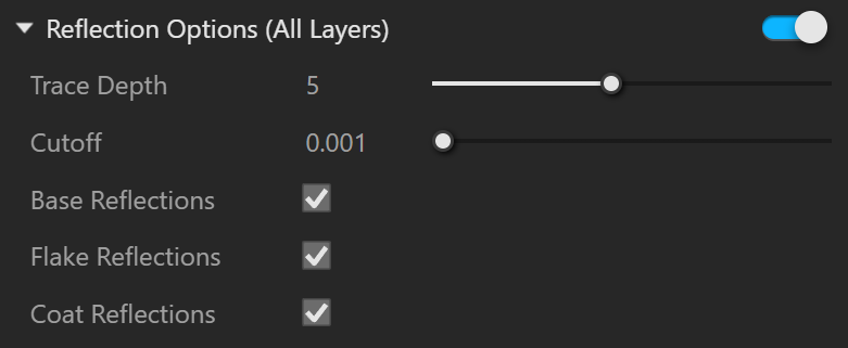

Reflection Options (All Layers)
This rollout is available only in Advanced mode.
Trace Depth – Specifies the maximum number of times a ray is reflected by the material.
Cutoff – Specifies a threshold below which reflections do not be traced. V-Ray tries to estimate the contribution of reflections to the image, and if it is below this threshold, these effects are not computed. Do not set this to 0.0 as it may cause excessively long render times in some cases.
Base Reflections – When disabled, the base layer only produces specular highlights, but no actual reflections are traced.
Flake Reflections – When disabled, the flakes only produces specular highlights, but no actual reflections are traced.
Coat Reflections – When disabled, the coat layer only produces specular highlights, but no actual reflections are traced.

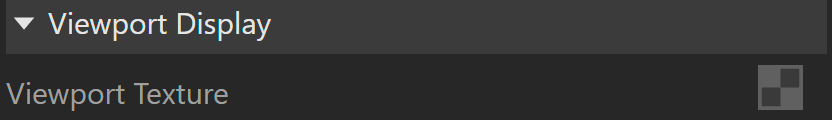

Viewport Display
Viewport Texture – The selected texture is displayed in the viewport.

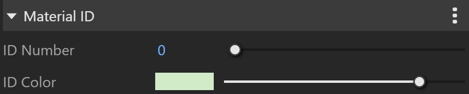

Material ID
ID Number – Isolates objects as an R/G/B mask in the MultiMatte Material render elements.
ID Color – Specifies a color to represent this material in the Material ID VFB render element.
Each material is assigned with an automatically generated ID Color.
