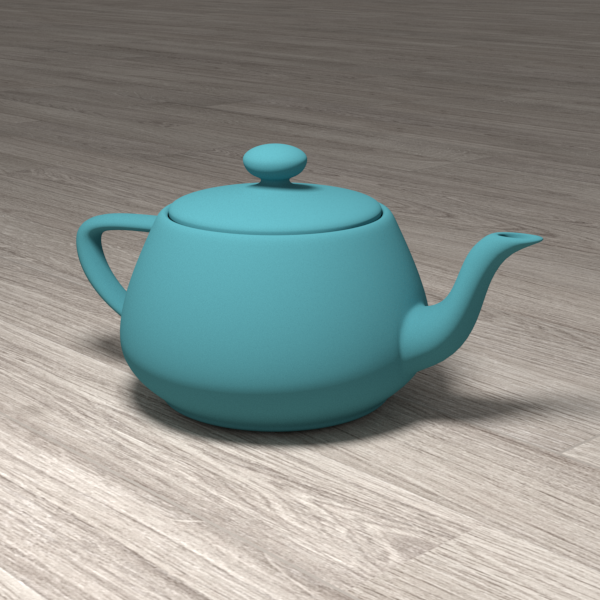

Roughness = 0.0 (regular diffuse material)

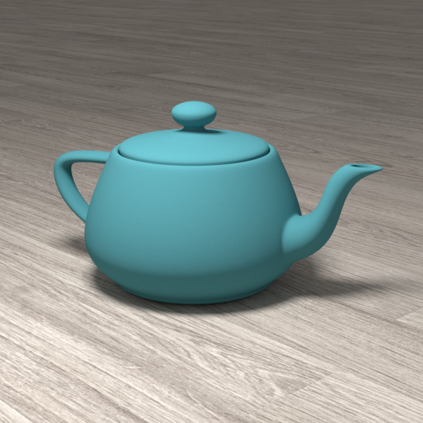

Roughness = 0.3

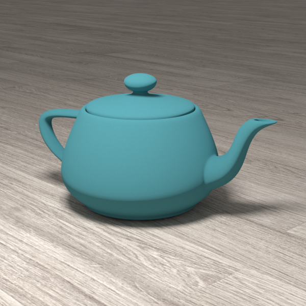

Roughness = 0.6

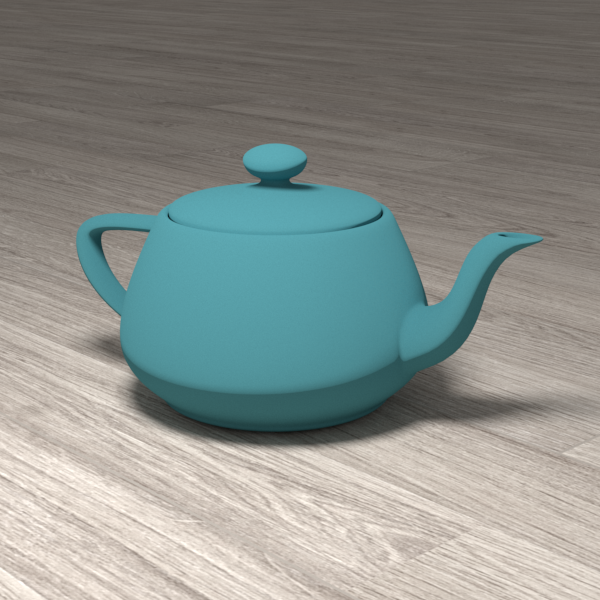

Roughness = 0.8
