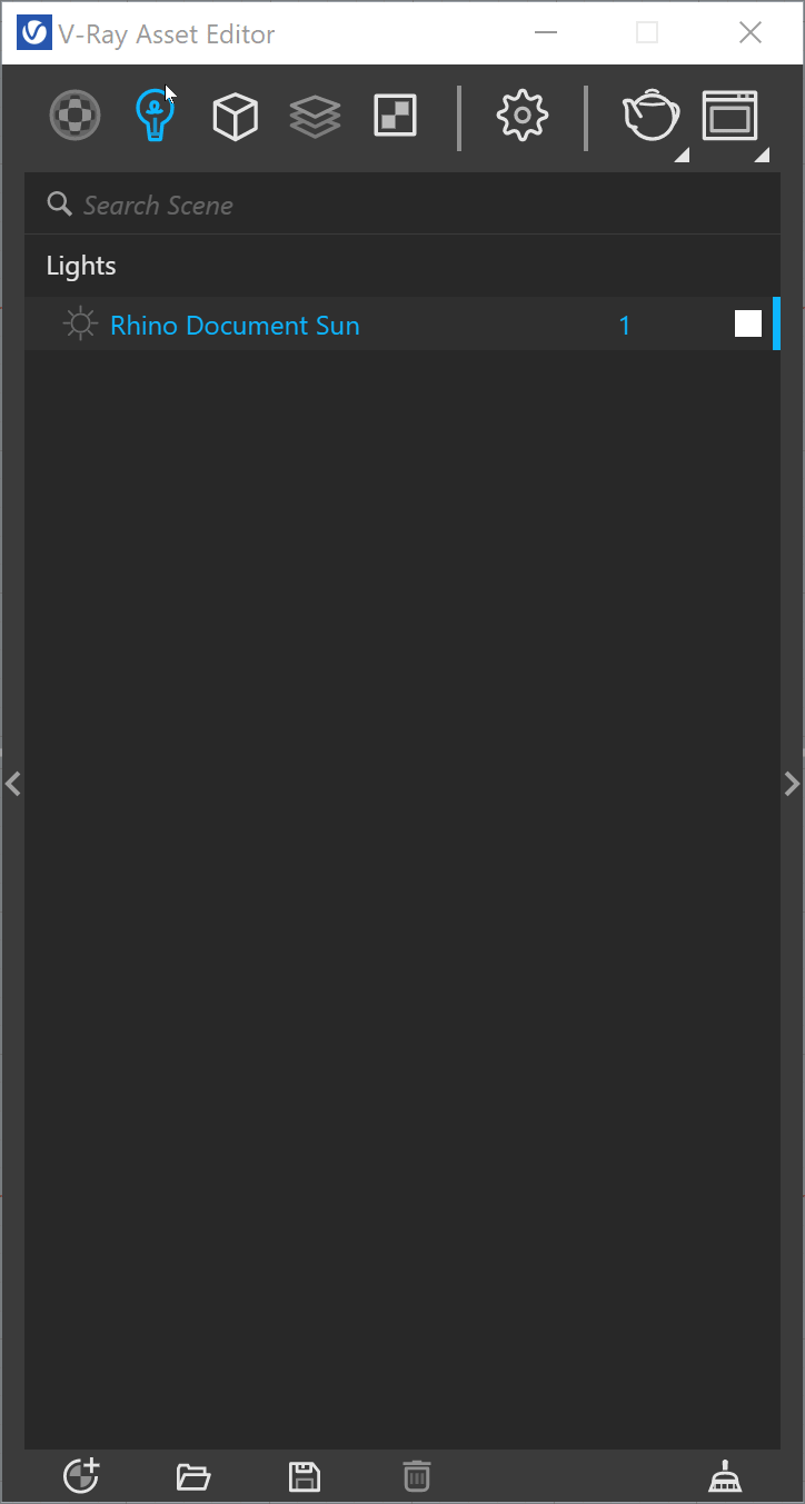

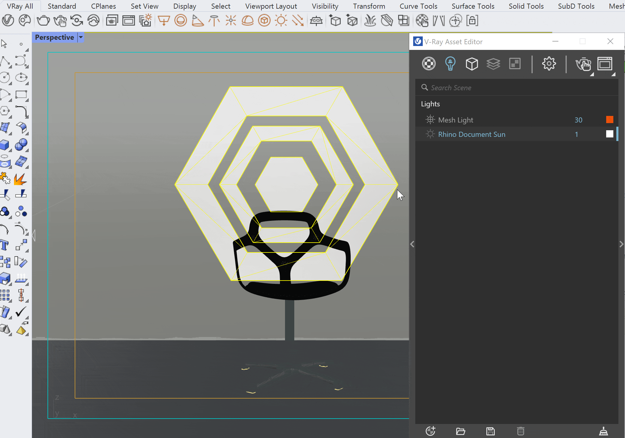

The Asset Editor also offers creation of a Mesh Light from the Lights category. Once the asset is created, use the context menu to apply it to a selection in the scene.
It is possible to override a Mesh Light with another Mesh Light by using the Apply to Selection context menu option. Note that a Mesh Light can be replaced only by same asset type.

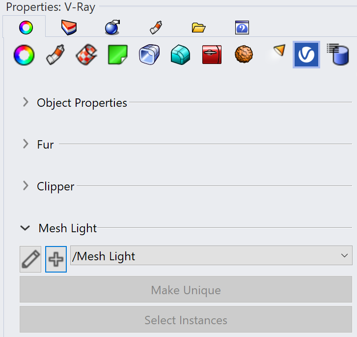

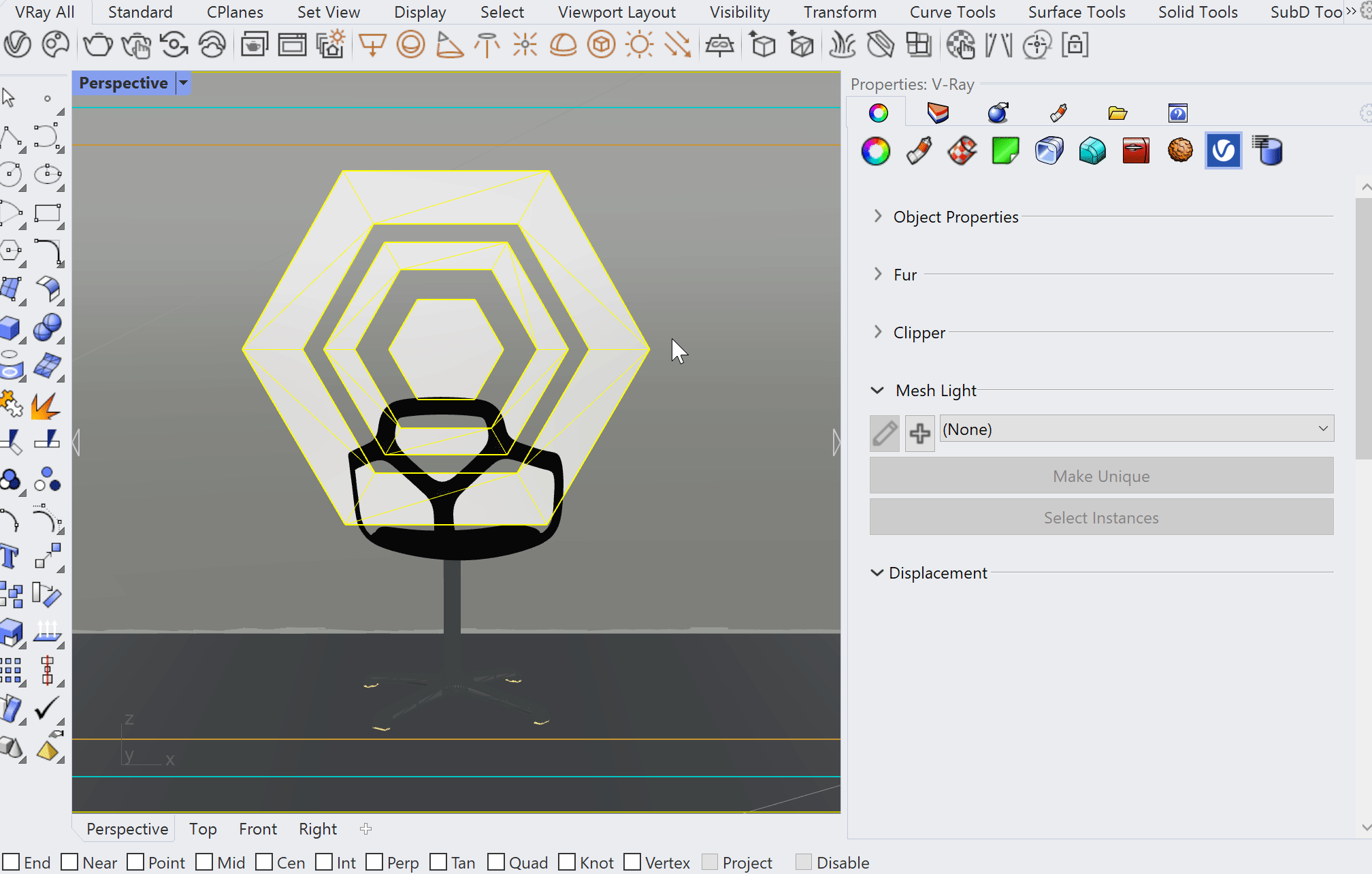

Creating a Mesh Light can be done from the Rhino's Property Panel where the V-Ray Properties reside. Select the object(s) in the scene and press the plus button under the Mesh Light option.

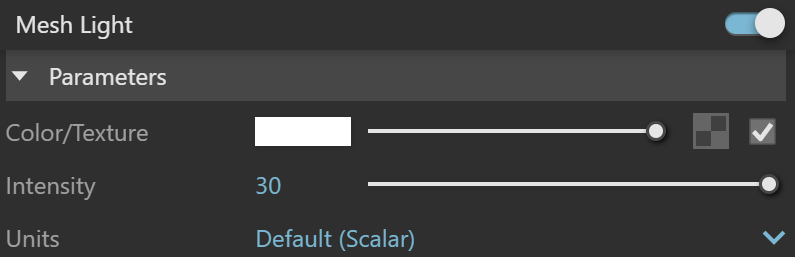

Enabled () – Determines whether or not the Mesh Light emits light in the scene.
Color/Texture – Specifies the color of the light. A high dynamic range texture can be used. Texture is not supported when rendering with V-Ray GPU.
Intensity – Specifies the strength of the light. See Intensity example below for illustration.
Units – Specifies the light unit of measurement. Using correct units is essential when working with physical camera exposure. The light automatically takes the scene units scale into consideration to produce a correct result.

Mesh Light in Rhino's Properties Panel
In Rhino's Properties panel reside several V-Ray rollout controls, one of which is for V-Ray Mesh Light.
The button applies new Mesh Light properties to a selection. A selection can receive already existing Mesh Light properties. The button opens the light property panel of the selected Mesh Light asset in the V-Ray Asset Editor.
Make Unique – Makes unique the selected instance of a mesh light. It creates a new Mesh Light item in the Asset Editor that is linked only to the selected object.
Select Instances – Selects all objects that have an instance of the same mesh light in the viewport.

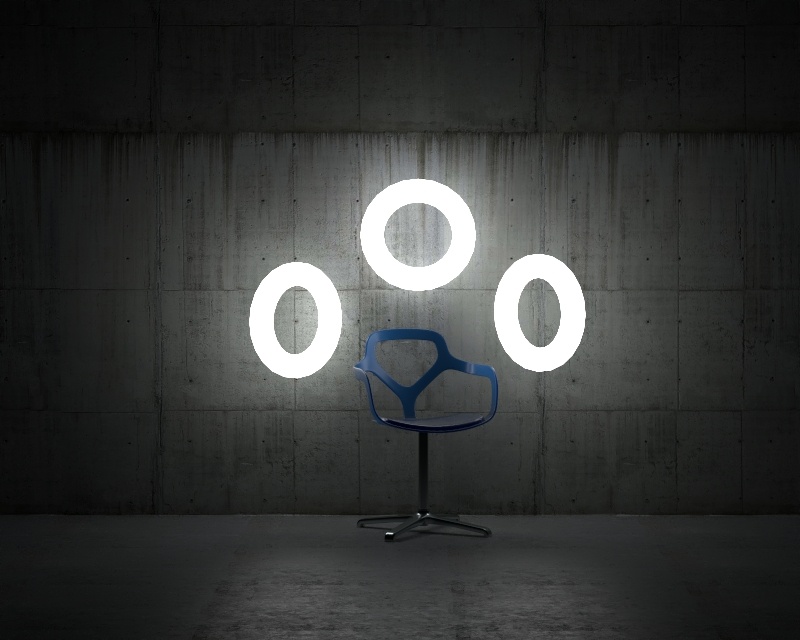

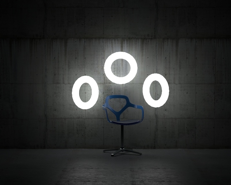

Example: Intensity
This example shows how the light in the scene changes based on the strength value.
Intensity = 15
Intensity = 30
Intensity = 45
Intensity = 60

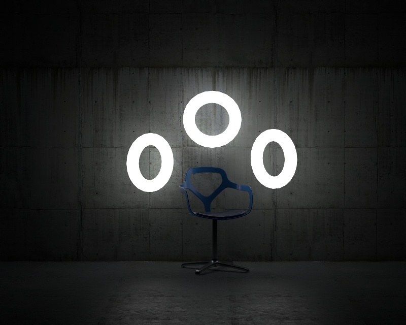

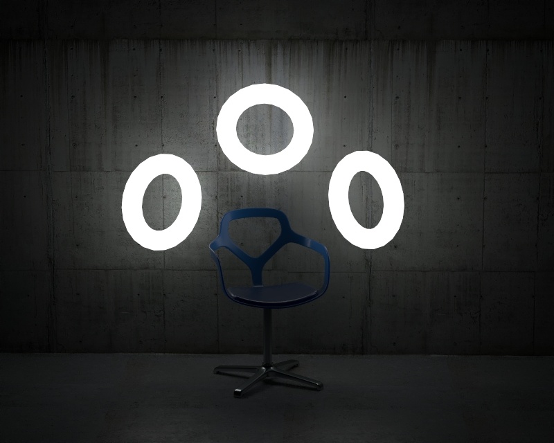

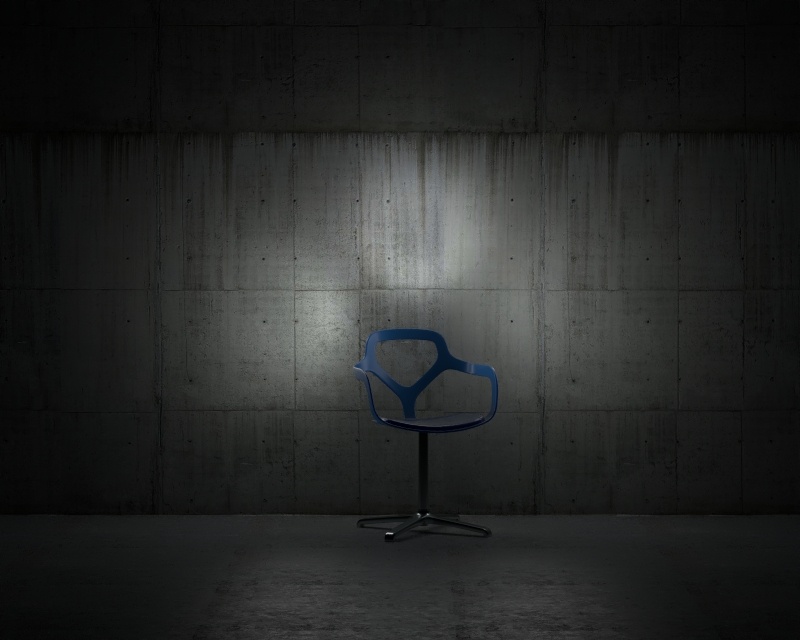

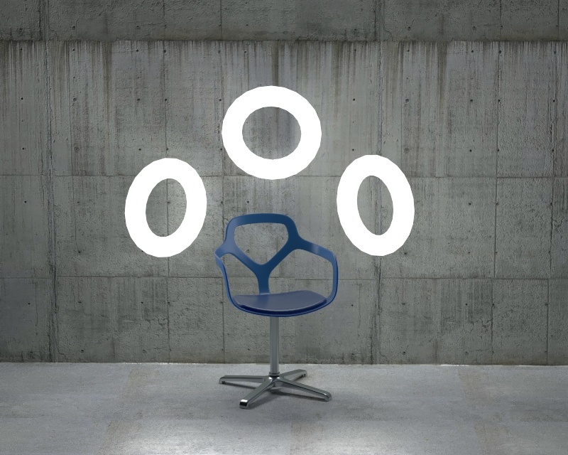

Example: Invisibility
The example below shows the difference between an invisible mesh light and visible mesh light.
on
off

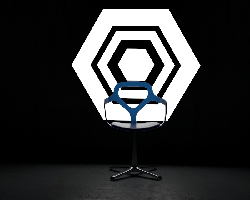

Example: Double-Sided
This example shows the difference between the Double-Sided option enabled and disabled.
off
on
