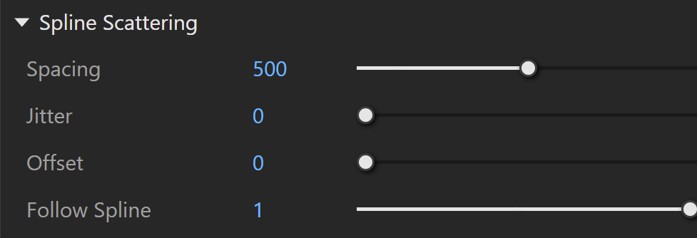

Spline Scattering
This submenu is only available when the scattering mode is set to 1D - On Splines.

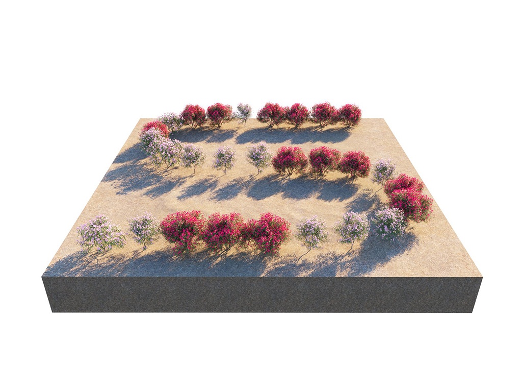

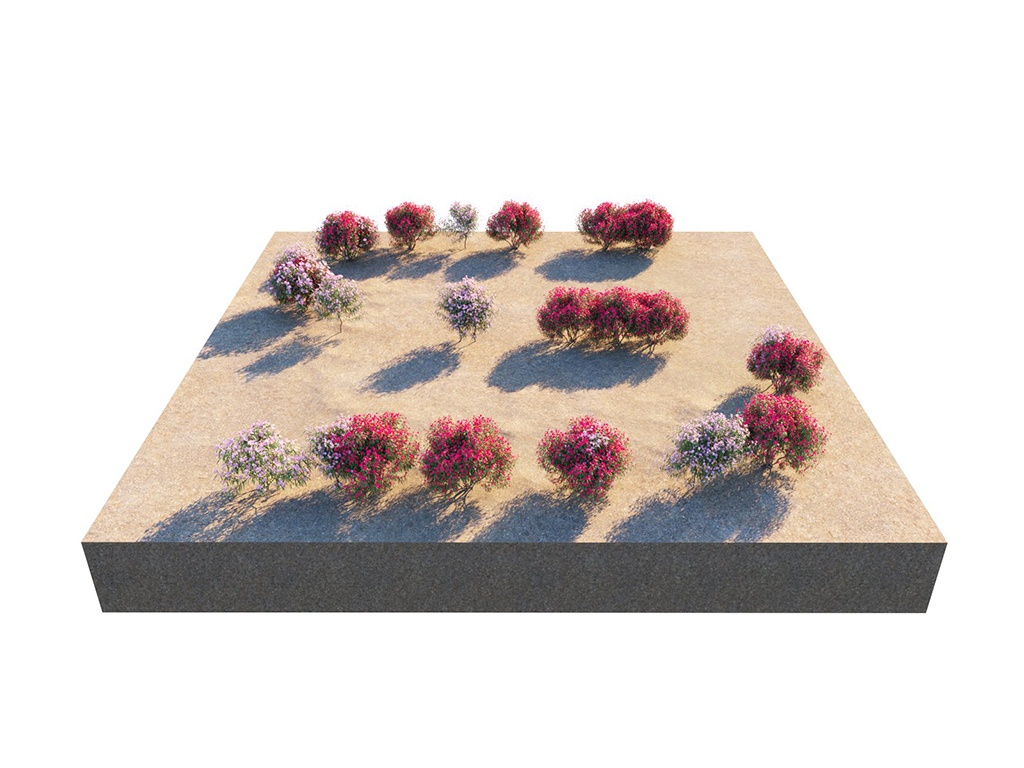

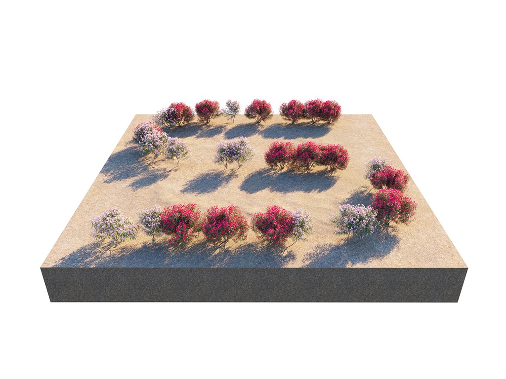

Spacing – Determines the spacing between instances in world units. See the Spacing Example below.

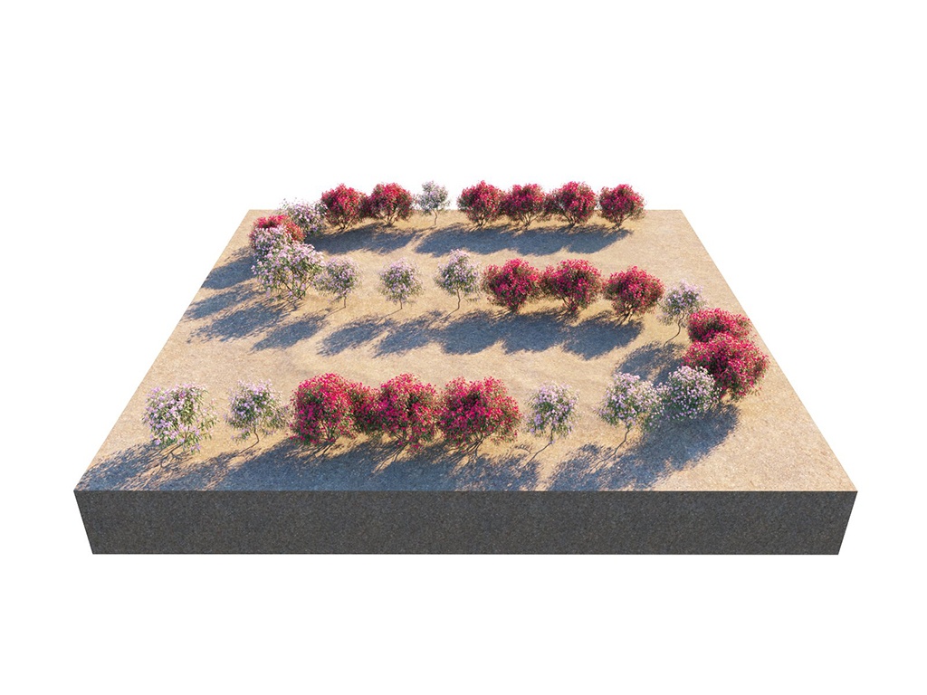

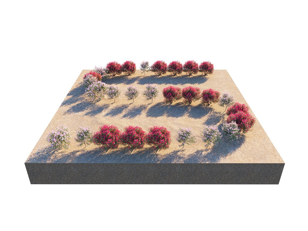

Jitter – Randomly jitters instances along the spline. Each instance has Spacing applied on both sides, except the instances at the end of the spline. The Jitter value is divided between those two Spacings. In order to allow instances to jitter in all their Spacing distance, the Jitter needs to be set to 2. See the Jitter Example below.
Offset – Determines what percentage of the Spacing instances are offset in one direction of the spline. When set to 1, all instances replace the one after them, as the offset is equal to the whole value of the Spacing. See the Offset Example below.
Follow spline – Determines how scattered instances are oriented along the spline. Assigning a value of 1, makes instances follow the spline and are oriented along the local tangent direction. See the Follow Spline Examples below.
Rhino8_VRay6.2_Scatter_Parameters_Spline

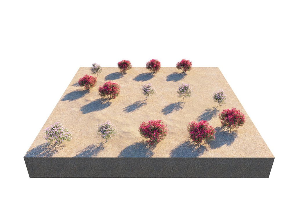

Example: Spacing
This example shows how the Spacing parameter's value affects the distance between the instances. Higher values result in larger distance between instances. The scene for this example is set in inches.

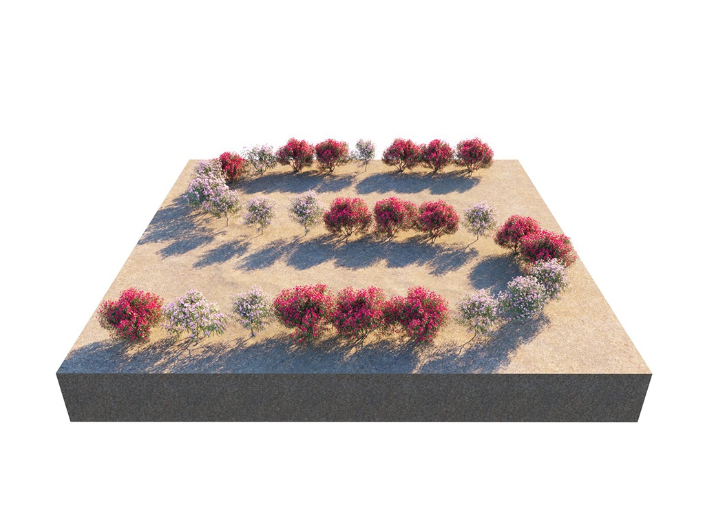

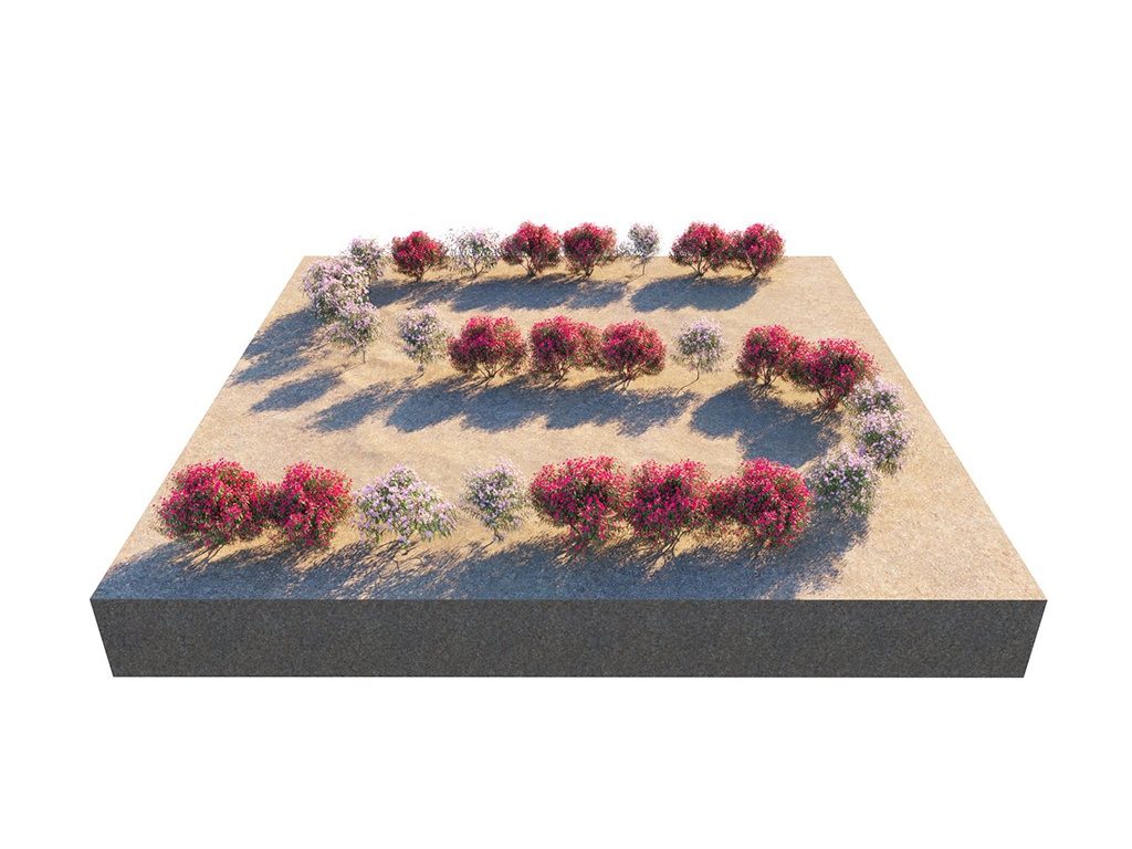

Example: Jitter
 Here, the Spacing is fixed to 200 inches, and the instances are randomly distributed within the spline. The scene for this example is set in inches.
SplineScattering_Spacing_100
Spacing = 100
SplineScattering_Spacing_200
Spacing = 200
SplineScattering_Spacing_400
Spacing = 400
SplineScattering_Spacing_200_Jitter_0
Spacing = 200; Jitter = 0
SplineScattering_Spacing_200_Jitter_1
Spacing = 200; Jitter = 1
SplineScattering_Spacing_200_Jitter_2
Spacing = 200; Jitter = 2
