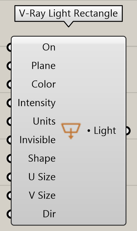

V-Ray Rectangle Light component creates a rectangle light source. This light source can be connected to the V-Ray Render which will automatically add it to the rendered scene. If a list of input Planes is connected to this component, multiple lights are generated. Multiple Size values can also be used.
The Number of Instances tag at the bottom of the component indicates how many times the object is currently being instanced.
The number of input Planes determines the lights count. The number of Size values do not affect the lights count.

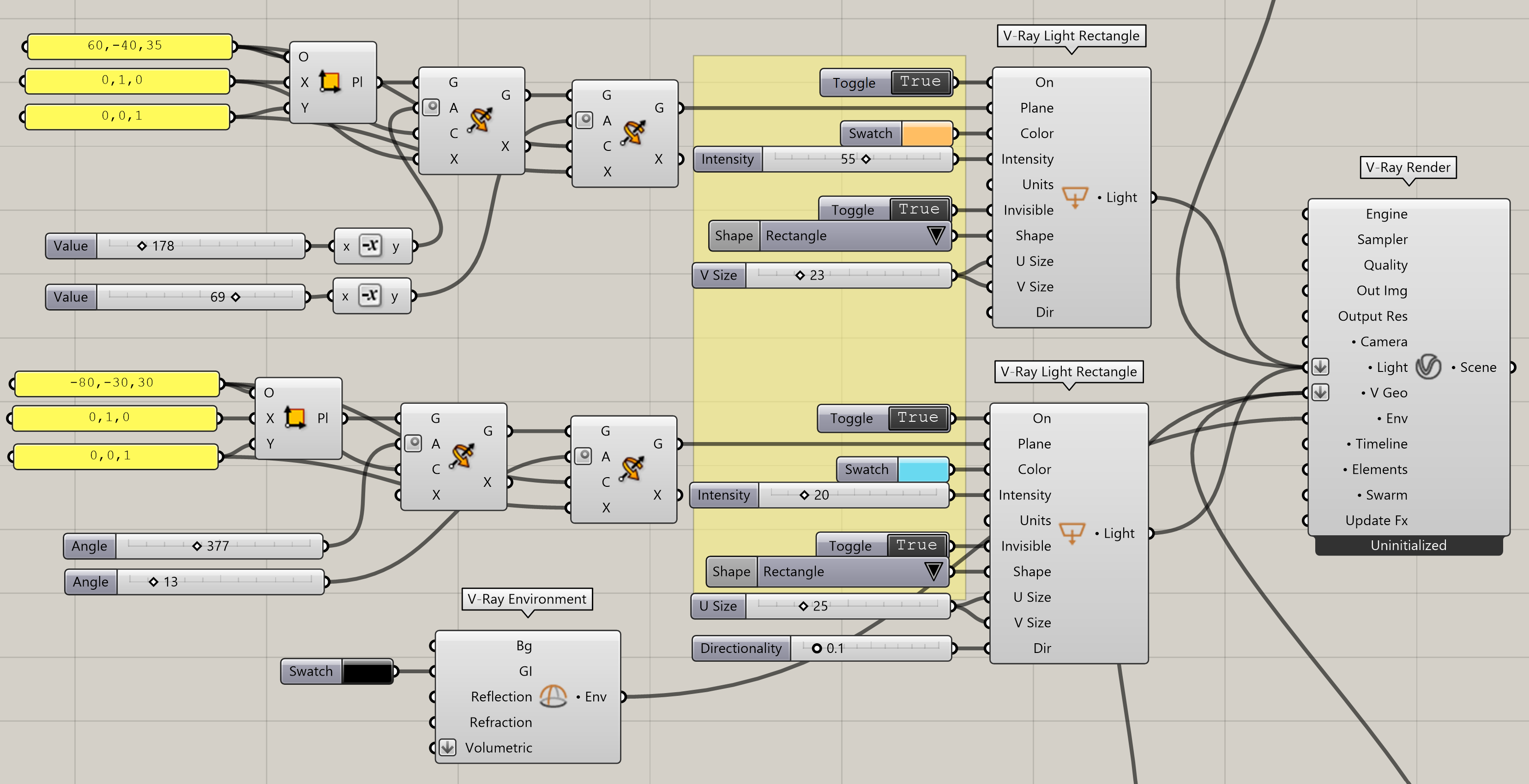

Light Rectangle component connection. Note that an Environment component with a black color plugged in the GI input parameter is used as an override to turn off the default Environment lighting. If there is no Environment input in the Render component V-Ray always creates one internally.
