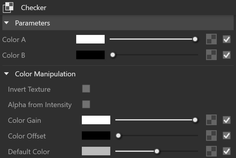

Color A – Specifies a color or texture for what would usually be the white squares on the checkerboard.
Color B – Specifies a color or texture for what would usually be the black squares on the checkerboard.
Color Manipulation
Invert Texture   Inverts the RGB texture values.
Alpha from Intensity – Uses the texture RGB intensity/ luminance as alpha channel.
Color Gain –  Corrects the color of the texture by multiplying the the RGB color values in the texture with the RGB color values specified here. When a texture is selected, it overrides the color as long as the texture checkbox is enabled.
Color Offset  Corrects the color of the texture by adding the RGB color values specified here to the RGB color values of the texture. When a texture is selected, it overrides the color as long as the texture checkbox is enabled.
Default Color  Specifies a default color used for polygons with no valid UVs. In case the map is not tiled, specifies a default color that is used outside the texture square.  When a texture is selected, it overrides the color as long as the texture checkbox is enabled.
