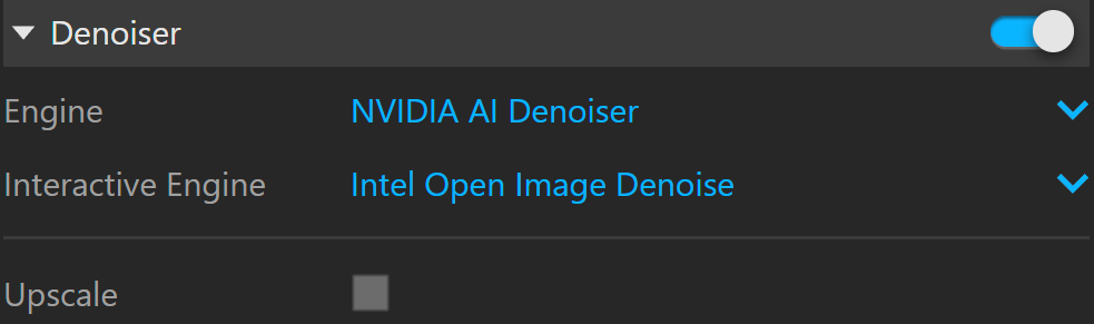

Enable – Turns the Denoiser on or off. When enabled, it automatically adds the Denoiser as a Render Element.
EngineAllows choosing between the default V-Ray Denoiser, NVIDIA AI Denoiser and Intel Open Image Denoise.
Interactive Engine – Determines the denoising engine to be used during Interactive rendering when the Auto denoising mode is selected.

Upscale – (Available for NVIDIA AI Denoiser engine only) When enabled, the image is rendered at half size to speed up its calculation while its denoised output is upscaled to full resolution. This results in cleaner and faster initial updates ideal for interactive rendering. NVIDIA's AI upscaling technology represents an advanced method based on machine learning that provides better results compared to standard image interpolation. Note that render elements without the Denoise option enabled are upscaled using standard interpolation.

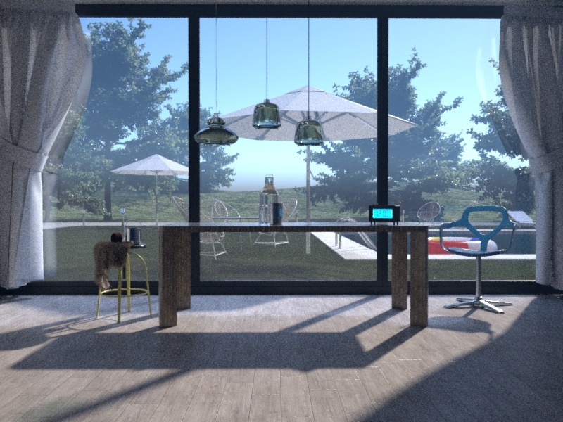

Example: Denoising Presets
The example below illustrates how VRayDenoiser works using the presets. A purposely noisy render was set up using the Progressive Image Sampler Type with Render Time set to only 3 minutes to leave plenty of noise in the render.
RGB Color Render Element prior to denoising
V-Ray Denoiser (Mild Preset)
V-Ray Denoiser (Default Preset)
V-Ray Denoiser (Strong Preset)
V-Ray Denoiser (Custom Preset: strength: 5, radius: 10)
V-Ray Denoiser (Custom Preset: strength:10, radius: 20)
