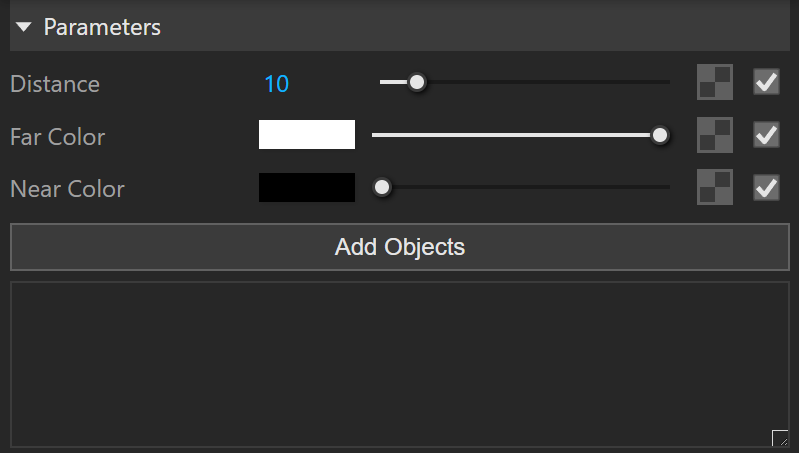

Distance – The map specifies a texture to multiply the distance value. Black colors in the distance map shade the points inside the radius with Far Color. White colors shade them with Near Color. See the Distance Texture example below.
Far Color – The color returned by the texture for points that are at a greater distance than the Distance value from objects specified in the list. Please see the Far Color example below.
Near Color – The color returned by the texture for points that are right at the edges of the object(s) specified in the list. Please see the Near Color example below
For points that are outside or inside the objects but not exactly next to them, the color is determined by blending between the Near Color and the Far Color while the distance serves as a falloff radius.
Add Objects – Adds preselected objects from the scene.

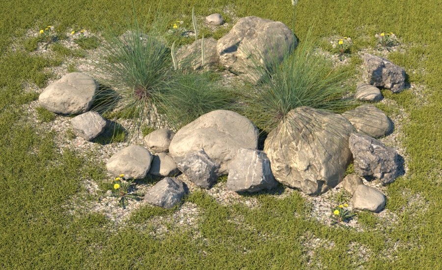

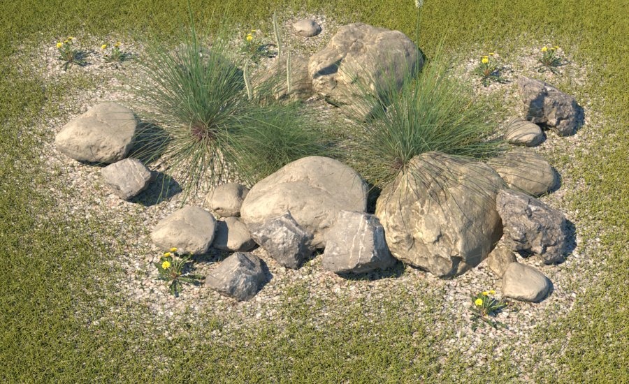

Example: Far Color
Example: Near Color

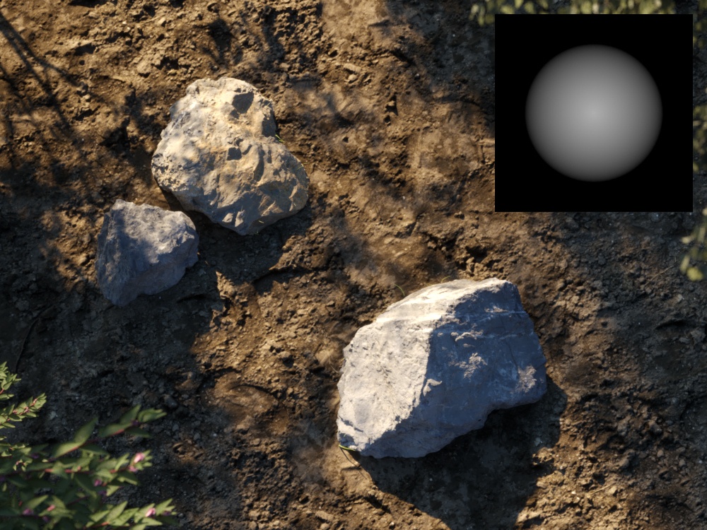

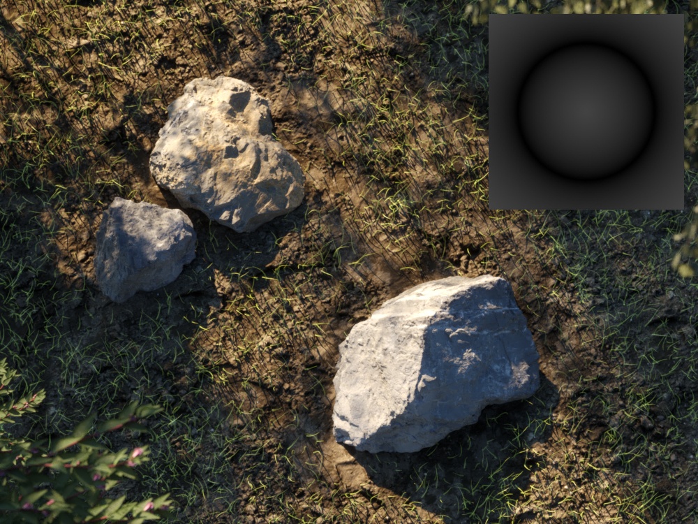

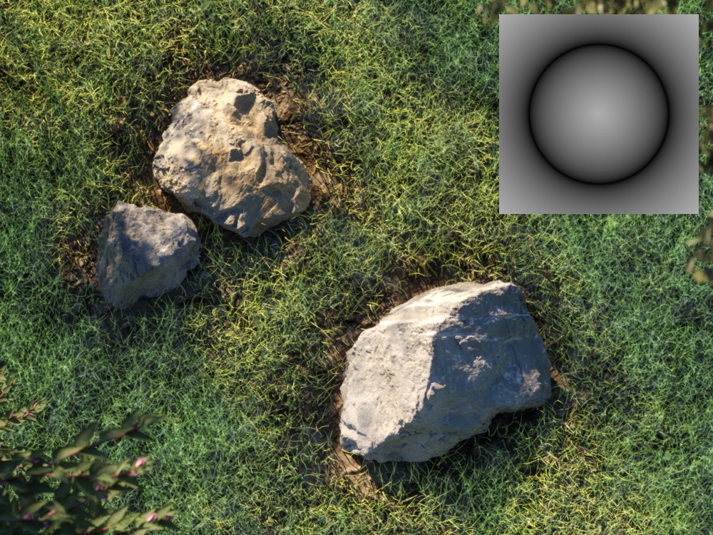

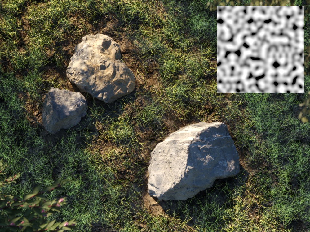

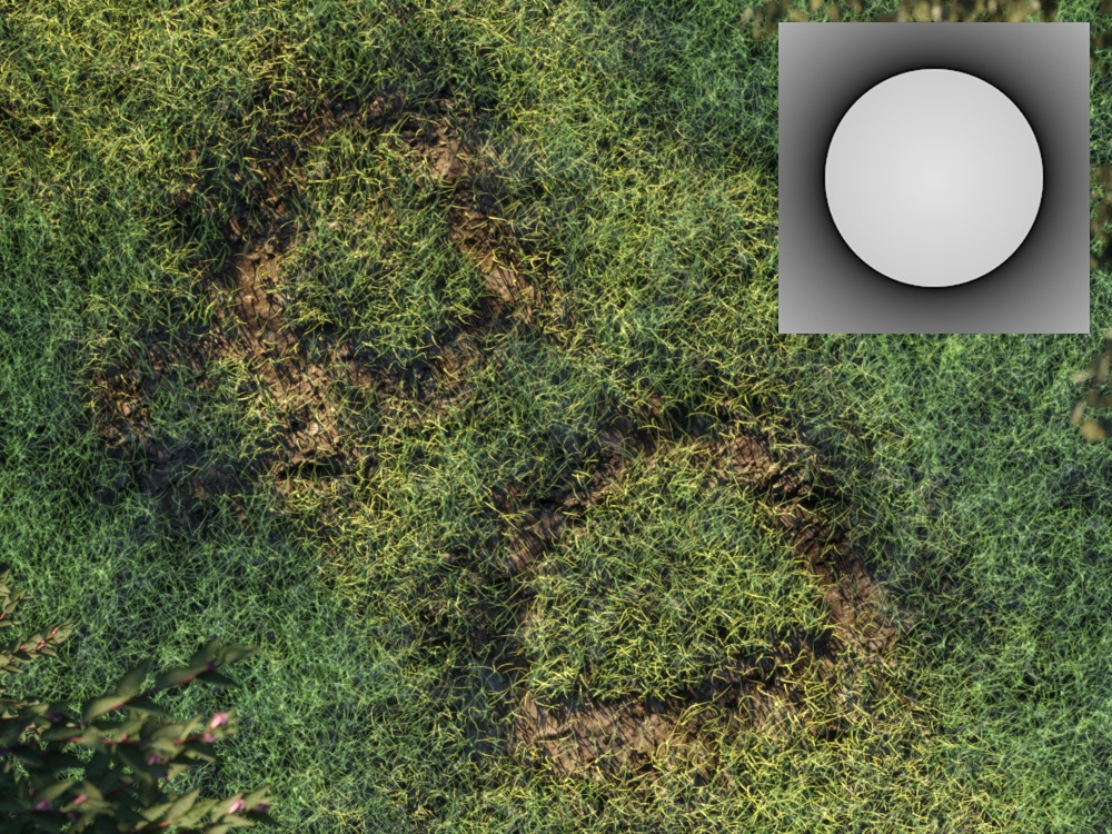

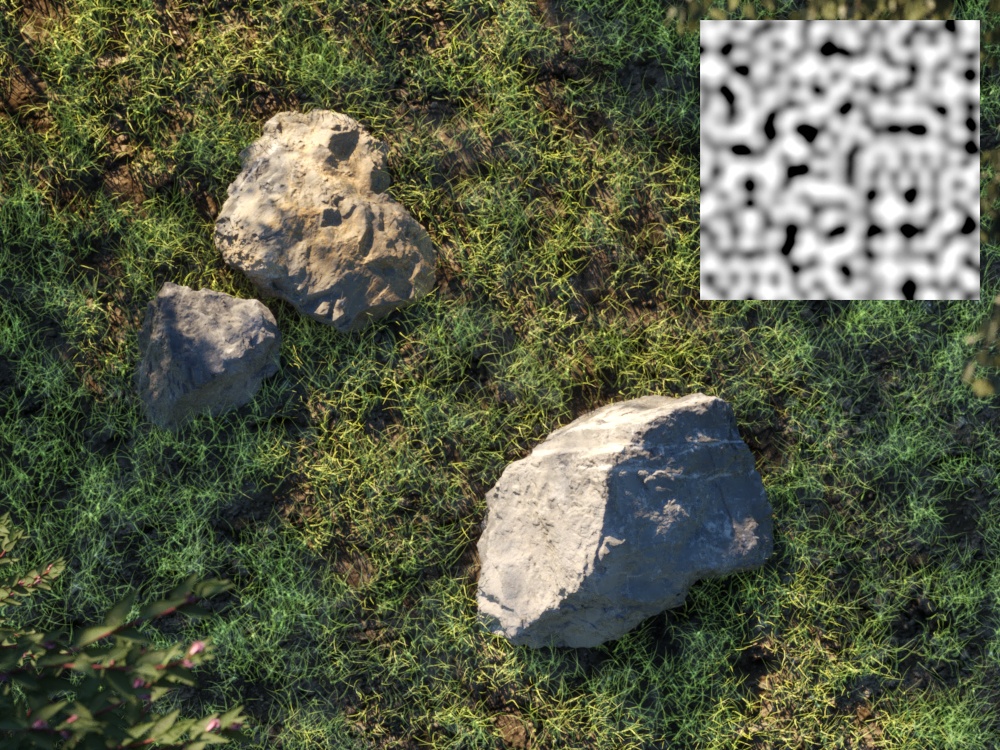

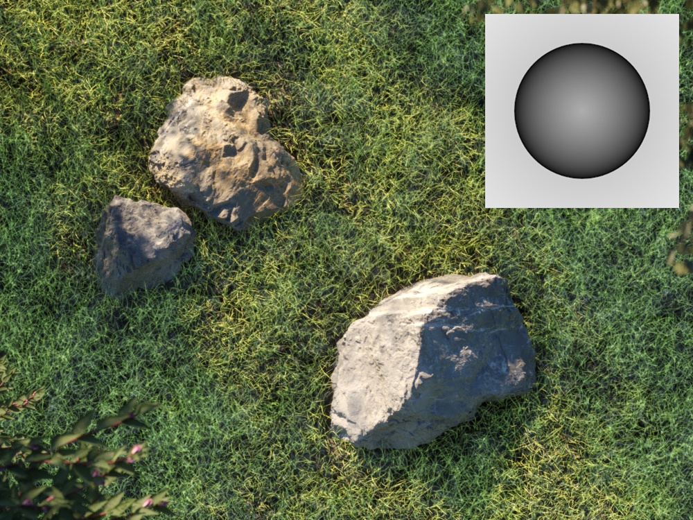

Example: Distance - Noise Texture

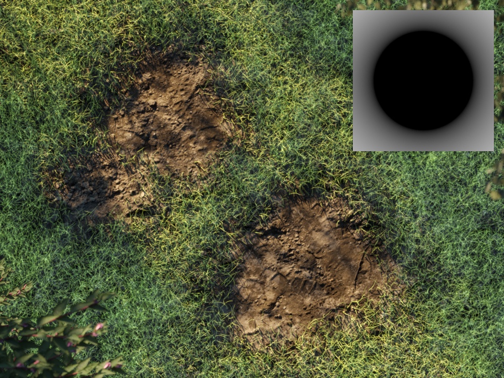

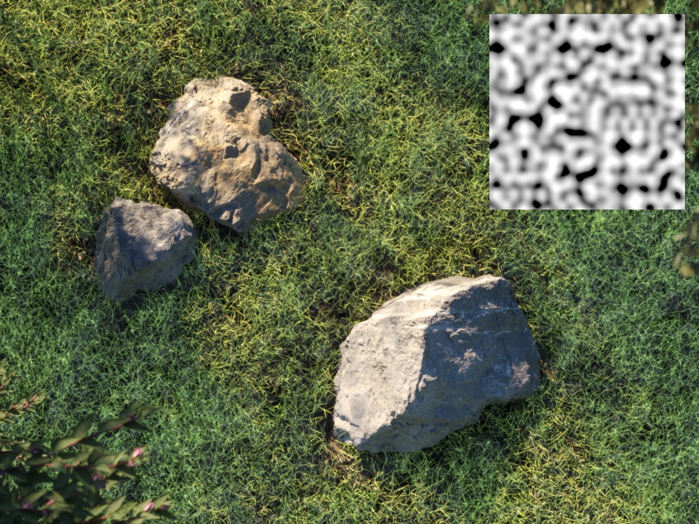

In this example the Fur geometry has a Distance texture used as a Density map. The Distance texture has a Distance value of 60 with a Noise map.
The objects added in the Distance texture Add Objects list are rocks and grass Assets. The Fur geometry has zero Density within the radius of 60 units from the objects
and normal Density (specified in the Fur Count parameter) outside this radius. The Noise texture multiplies the Distance value so that inside the radius of 60 units
of the Noise texture, black points result in zero Fur Density and white points result in normal Density. This gives the grass a more natural look.

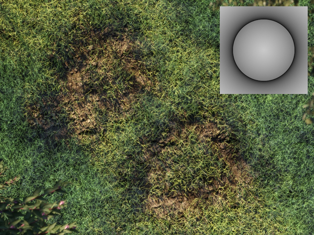

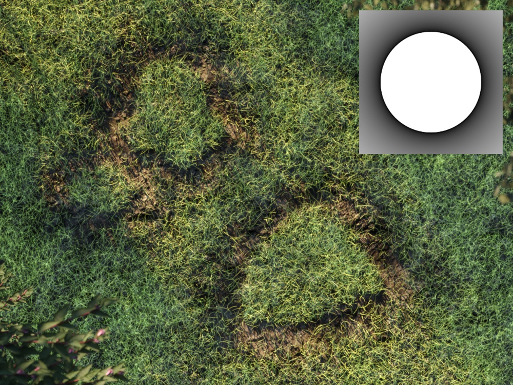

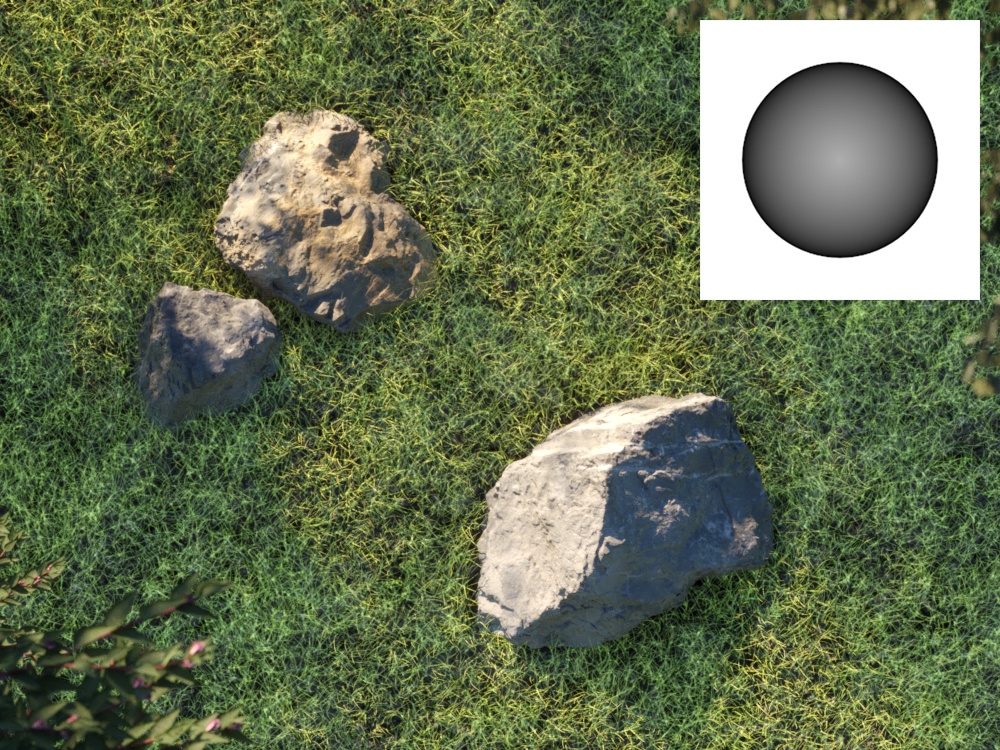

Inside Separate
Inside Separate – When enabled, the Near Color is overridden by the Inside Color value for points that are inside the specified geometry.
Inside Color – The color returned by the texture for points that are right inside the object(s) specified in the list.
For points that are inside the objects but not exactly next to them the color is determined by blending between the Inside Color and the Far Color while the Distance value serves as a falloff radius.
Inside Solid – When enabled, all points inside the specified geometry are given the Inside Color and no blending is performed.
Example: Inside Separate
The stones are made invisible by adding Raytrace Properties Attribute and turning off all the visibility options.
When Noise map is used as a texture for either Inside or Outside colors, the preview swatch does not display the end result distance texture
(no noise is visible in the swatch), so in those particular cases only the Noise texture is showed on the render.

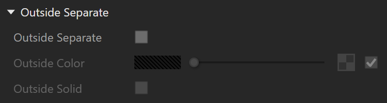

Outside Separate
Outside Separate – When enabled, the Near Color value is overridden by the Outside Color value for points that are outside the specified geometry.
Outside Color – The color returned by the texture for points that are outside the object(s) specified in the list.
Outside Solid – When enabled, all the points outside the specified geometry are given the Outside Color value and no blending is performed.

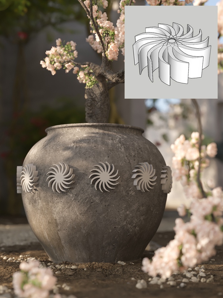

Example: Refine texture placement with Distance texture

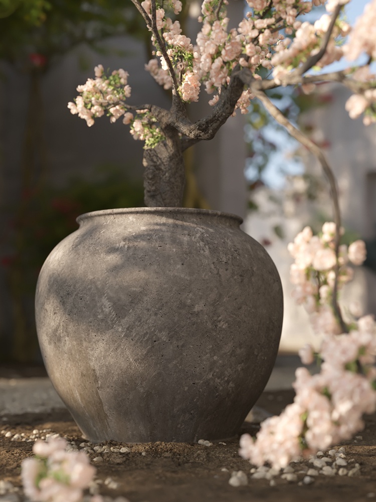

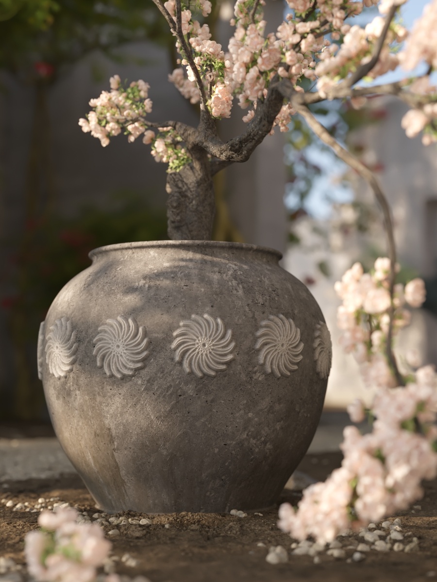

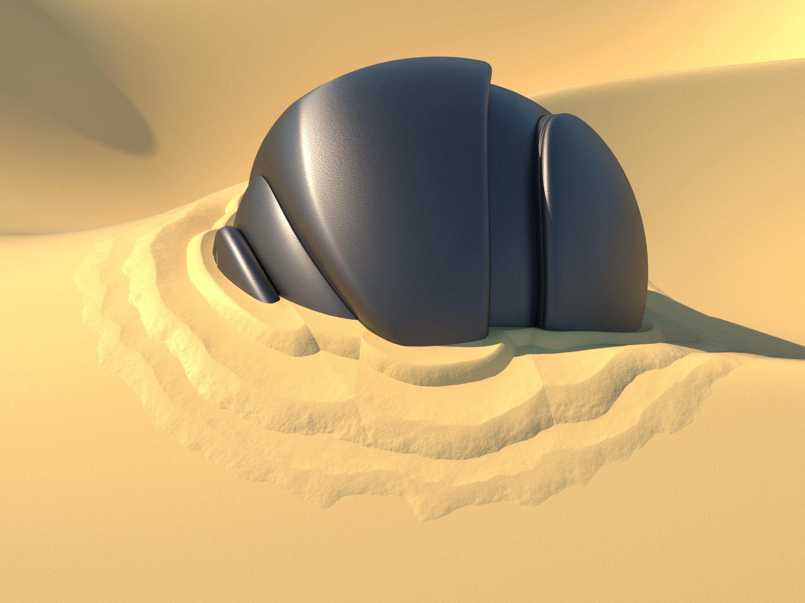

Example: Displacement
The example shows how to use geometry to create the Distance map used for Displacement.
A Displacement geometry tool is added to the pot and the Distance texture created from the intersection is used as Displacement.

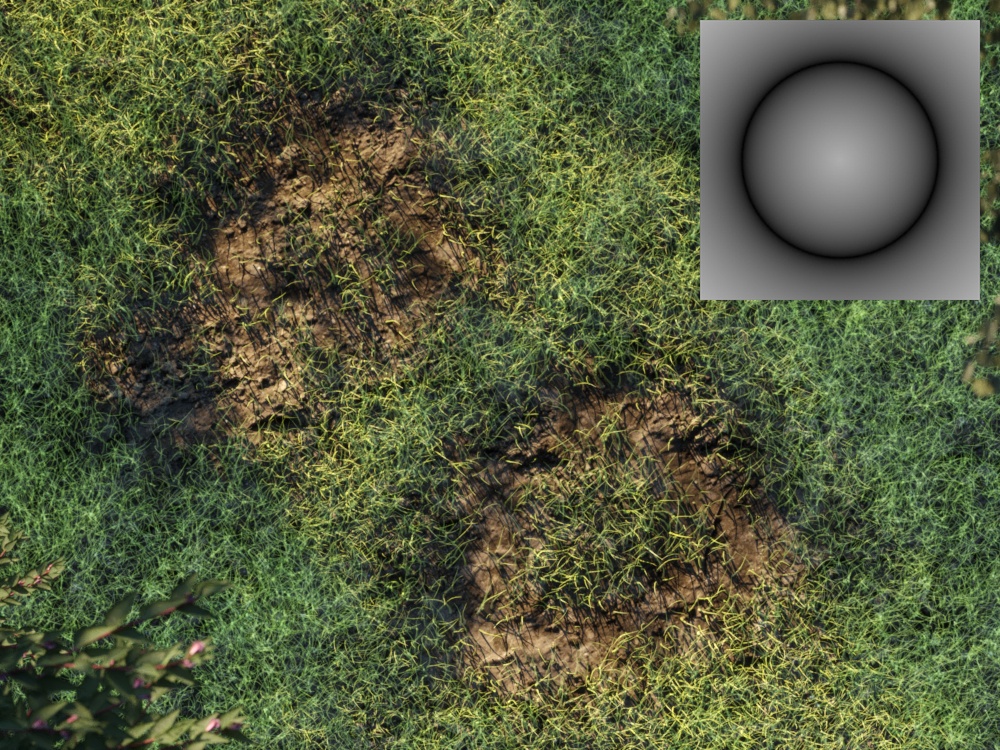

Example: Fur
The Density image shows how the Distance texture can control the density of the grass.
The Inside Separate and Inside solid options are turned On and a black color is used for the Inside Separate parameter.
