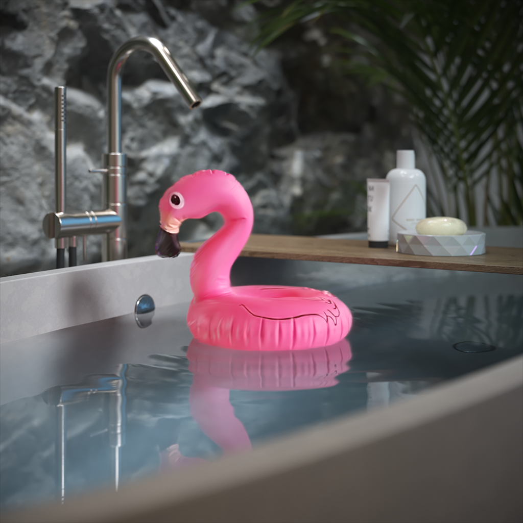

Example: Scale Factor
This example shows Gaussian Splat used as an individual object - the pink flamingo floatable in this scene. It can be scaled as any other object in the scene, using the Scale parameter.
Scale = 0.5
Scale = 1
Scale = 1.5

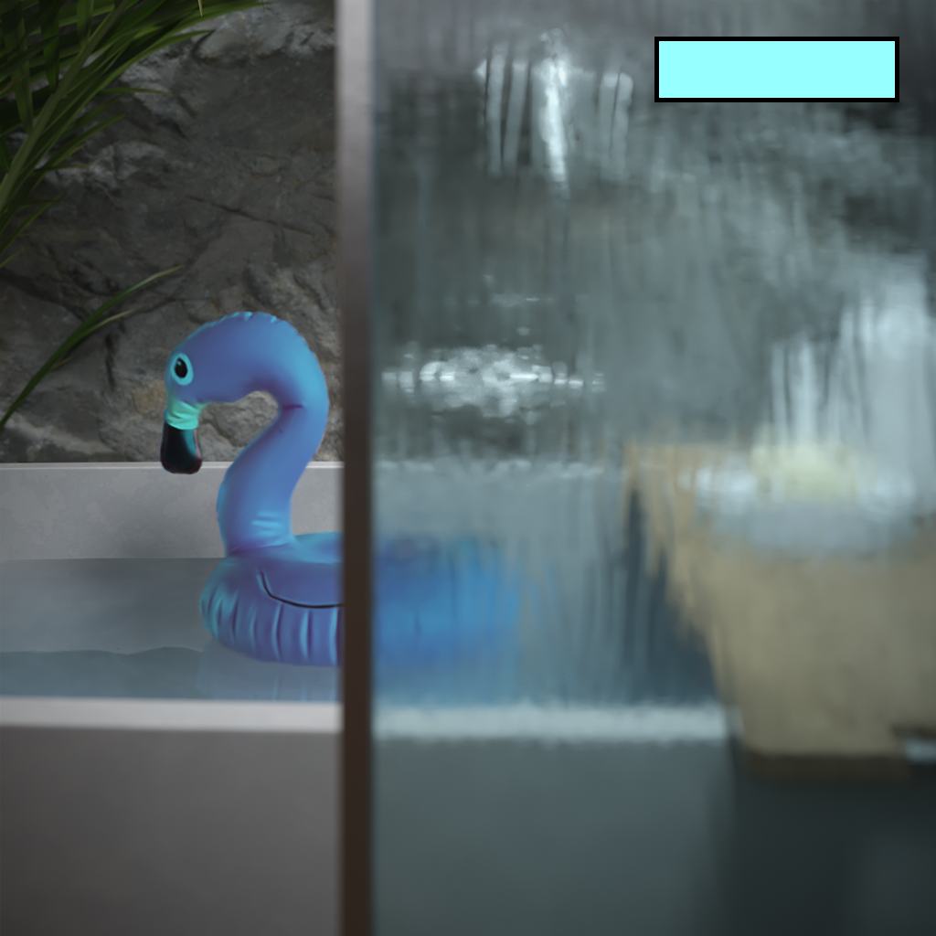

Example: Color
The Color shown on each render as a box is used as a filter for the original Gaussian Splat diffuse color.

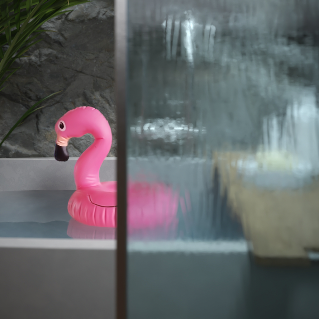

Example: Primary Visibility
The Gaussian Splat object can be hidden from camera, like any other geometry object in the scene by using the Primary Visibility option.
On
Off

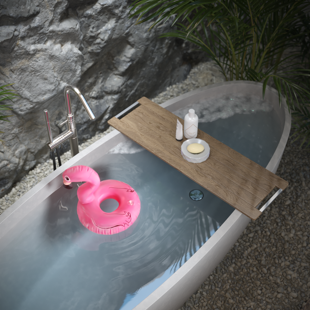

Example: Casts Shadows
This example shows how the pink flamingo can produce shadows when the Casts Shadows option is enabled, and doesn't block light when it's not.
On
Off
