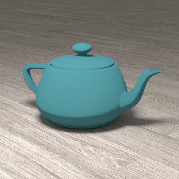

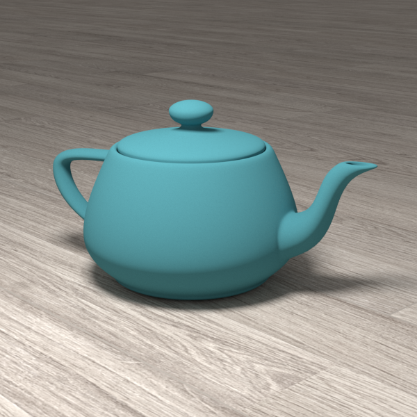

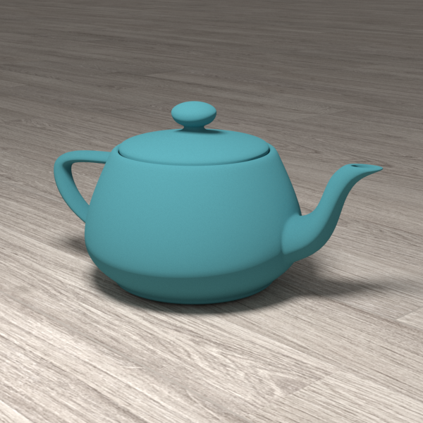

Diffuse Roughness* – Controls the Diffuse BRDF Falloff. It can be used to simulate rough surfaces or surfaces covered with dust (for example, skin or the surface of the moon). Note that this parameter only affects the diffuse portion of non-metallic materials. For more information, please see the Roughness Parameter example below.
Example: The Roughness Parameter
This example demonstrates the effect of the Roughness parameter. Note how, as the Roughness increases, the materials appear more "flat" and dusty.
Roughness = 0.0 (regular diffuse material)
Roughness = 0.3
Roughness = 0.6
Roughness = 0.8
