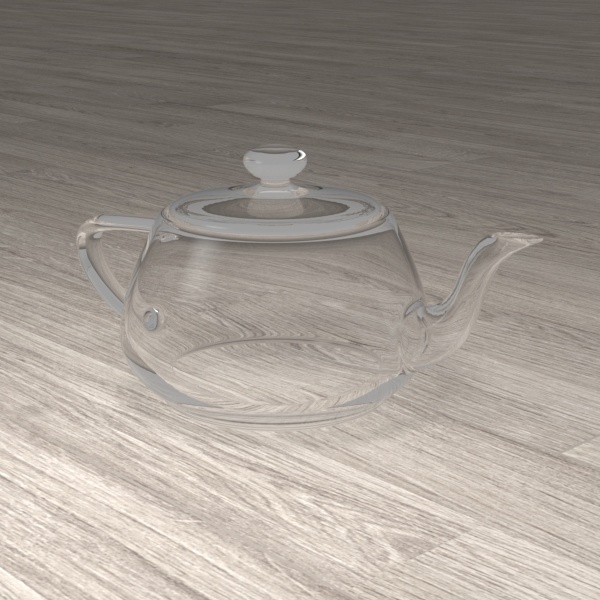

Translucency set to None

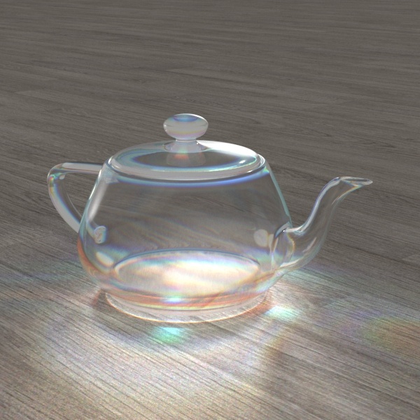

Dispersion
Dispersion – When enabled, true light wavelength dispersion is calculated. For more information, please see the Dispersion example below.
Abbe – Increases or decreases the dispersion effect. Lowering it widens the dispersion and vice versa.

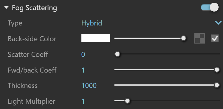

Legacy Parameters
Fog Scattering – Enables Refraction translucency.
Type – Selects the algorithm for calculating Fog Scattering (also called sub-surface scattering). Note that Refraction must be enabled and a Refraction Fog should be different from white for this effect to be visible.
Hard (wax) model  – This model is specifically suitable for hard materials like marble.
Hybrid
– This is the most realistic SSS model and is suitable for simulating skin, milk, fruit, juice, etc.
Back-side Color – Normally the color of the subsurface scattering effect depends on the Fog color. This parameter allows you to additionally tint the SSS effect.
Scatter Coeff – The amount of scattering inside the object. 0.0 means rays are scattered in all directions; 1.0 means a ray cannot change its direction inside the sub-surface volume.
Fwd/back Coeff – Controls the direction of scattering for a ray. 0.0 means a ray can only go forward (away from the surface, inside the object); 0.5 means that a ray has an equal chance of going forward or backward; 1.0 means a ray are scattered backward (towards the surface, to the outside of the object).
Thickness 1 – Limits the rays that are traced below the surface. This is useful if you do not want or don't need to trace the whole sub-surface volume.
Light Multiplier – Multiplies the translucent effect.
Fog Bias – Changes the way the fog color is applied. Negative values make the thin parts of the objects more transparent and the thicker parts more opaque and vice-versa (positive numbers make thinner parts more opaque and thicker parts more transparent).
Example: The Refraction Color Parameter
This example demonstrates the effect of the Refraction color parameter to produce glass materials. The material has a gray Diffuse color, white Reflection color, and the Fresnel option is turned on.

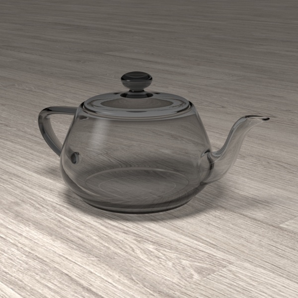

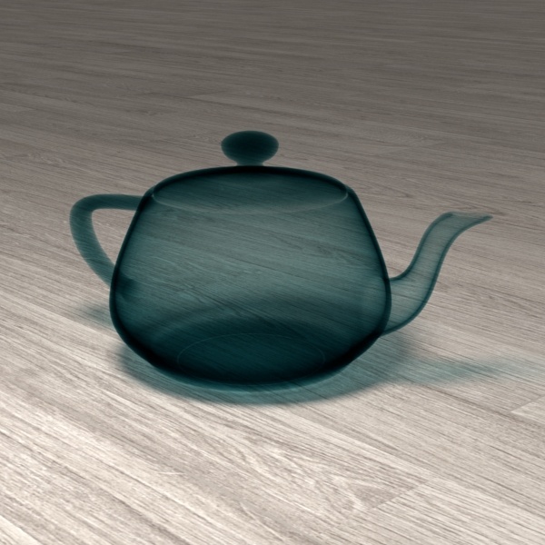

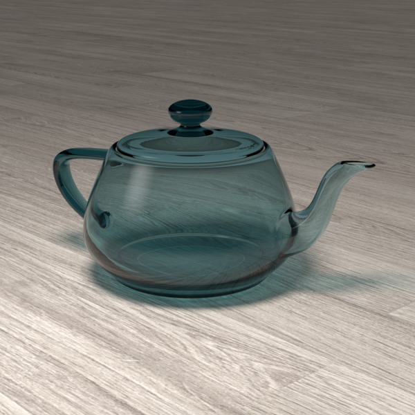

Example: The Fog Color Parameter
This example demonstrates the effect of the Fog color parameter. Notice how the thick areas of the object are darker in the two images on the right because of the light absorption of the fog.
Refraction color = Black (0, 0, 0),  no refraction
Refraction color = Light Blue (192, 192, 192)
Refraction color = White (255, 255, 255)
Fog color = White (255, 255, 255), no light absorption
Fog color = Dark Gray (192, 192, 192)
Fog color = Blue (70, 129, 137)

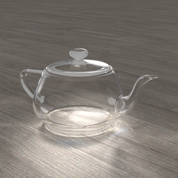

Example: Dispersion
This example demonstrates the Dispersion capabilities of the V-Ray material and the effect of the Abbe parameter.
Refraction depth = 1, Reflection depth = 5
Refraction depth = 2, Reflection depth = 5
Refraction depth = 4, Reflection depth = 5
Refraction depth = 8, Reflection depth = 5
Refraction depth = 8, Reflection depth = 8
Dispersion disabled
Dispersion enabled, Abbe = 50
Dispersion enabled, Abbe = 25
Dispersion enabled, Abbe = 10

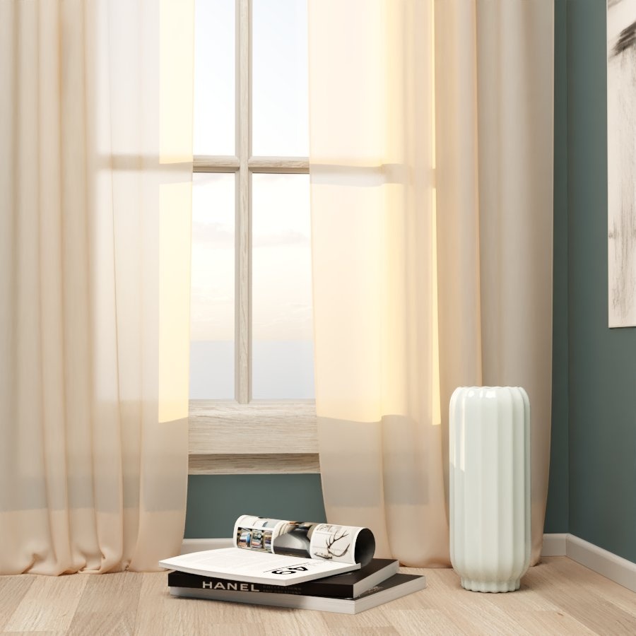

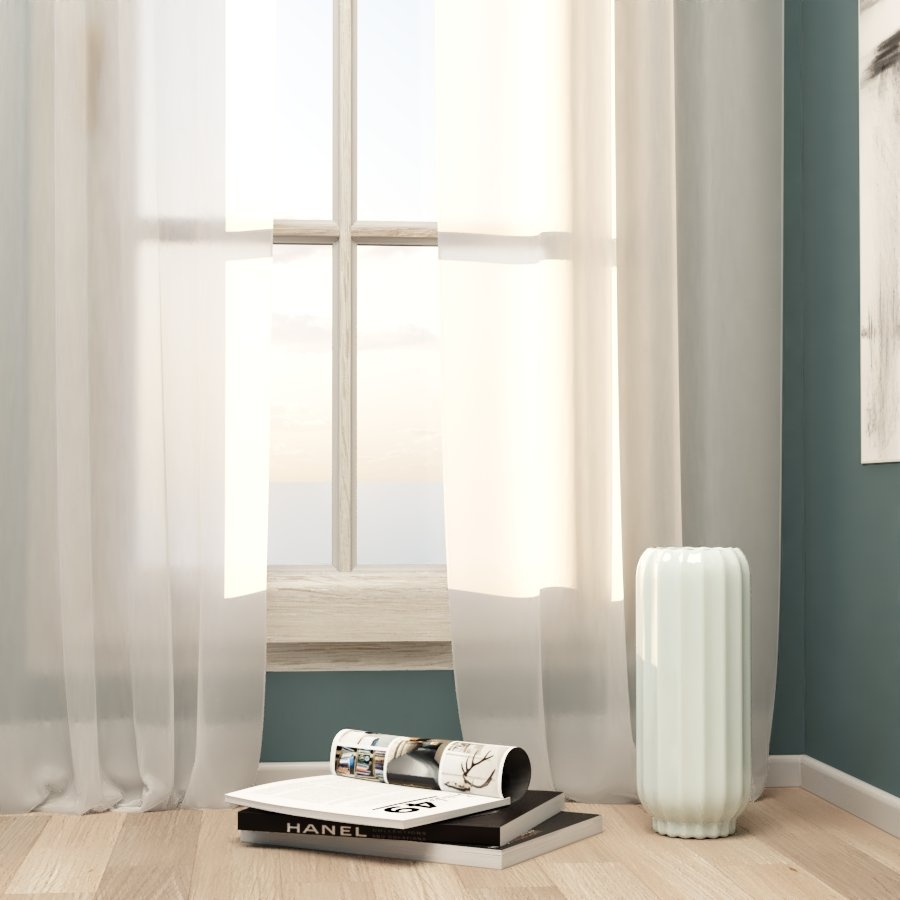

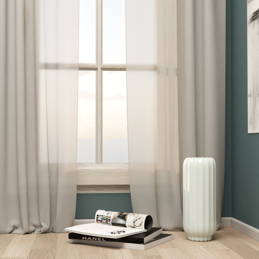

Example: Thin-Walled
This example shows the effect of the Refraction Thin-Walled option.

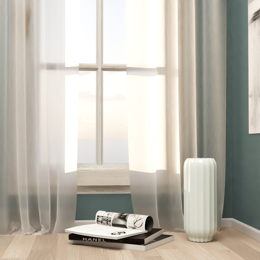

Example: Thin-Walled Color
This example shows the effect of the Refraction Thin-Walled color option.
SSS Amount = 0
SSS Amount = 0.25
SSS Amount = 0.5
SSS Amount = 0.75
SSS Amount = 1
SSS Amount = 0.5, Color = R82 G82 B81
SSS Amount = 0.5, Color = R195 G178 B153
SSS Amount = 0.5, Color = R255 G210 B143
