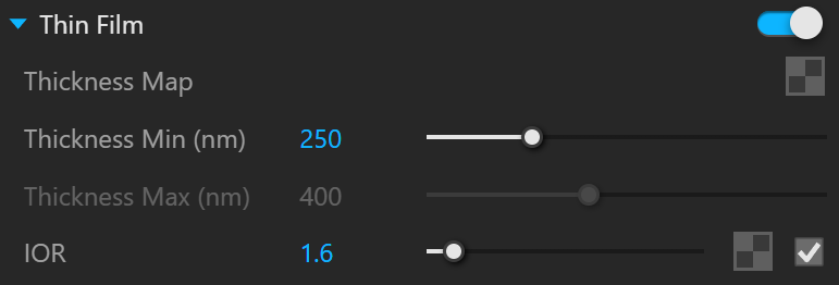

The Thin Film rollout is part of the Generic material's parameters.
The Thin Film recreates the effect of thin film interference on a surface making the material iridescent. Some common uses are soap bubbles and reflective car paint layering.
Thin Film
Available only in Advanced mode.
Thin Film – Turns on/off the thin film effect.
Thickness Map – Specifies the thickness texture. The map blends between the Min and Max thickness values and is expected to be in the range of 0-1. If there is no texture map, only the minimum thickness value is used.
Thickness Min (nm) Determines the minimum thickness measured in nanometers. See the Thin Film Thickness example for more information.
Thickness Max (nm) Determines the maximum thickness measured in nanometers.
IOR Specifies the index of refraction of the medium the thin film is made of.
