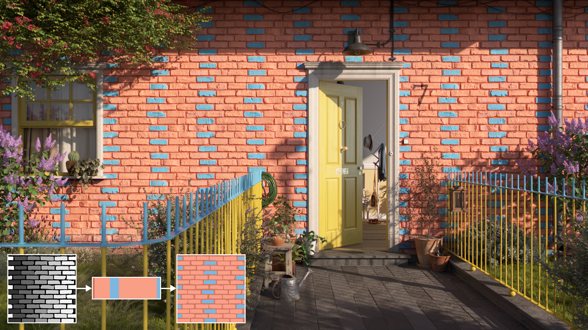

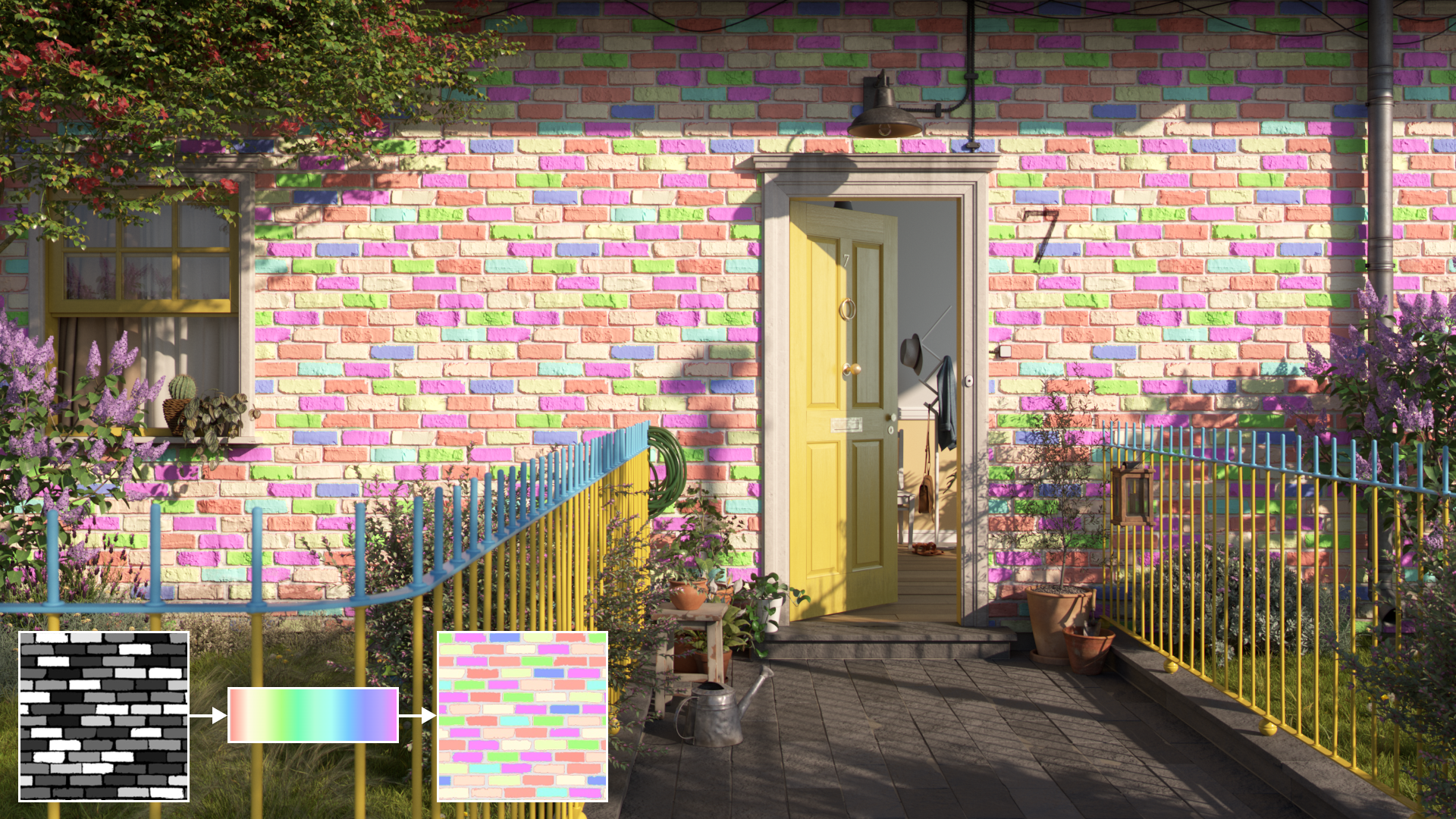

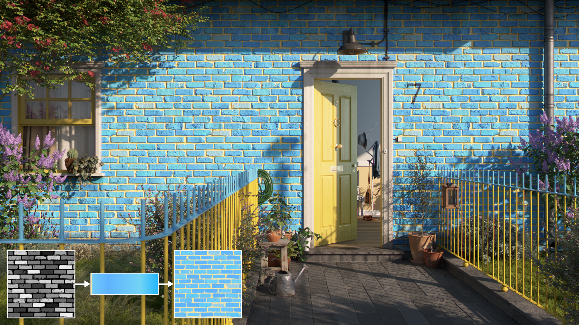

Example: Texture Remapping
This example shows different colorful patterns, where Gradient texture is used for colorization of the bricks. The material has a Gradient texture in the Diffuse map slot. The Gradient texture’s Texture Placement is set to Texture Remapping with UV Texture mode. The black and white brick texture is set in the UV Texture map slot.
