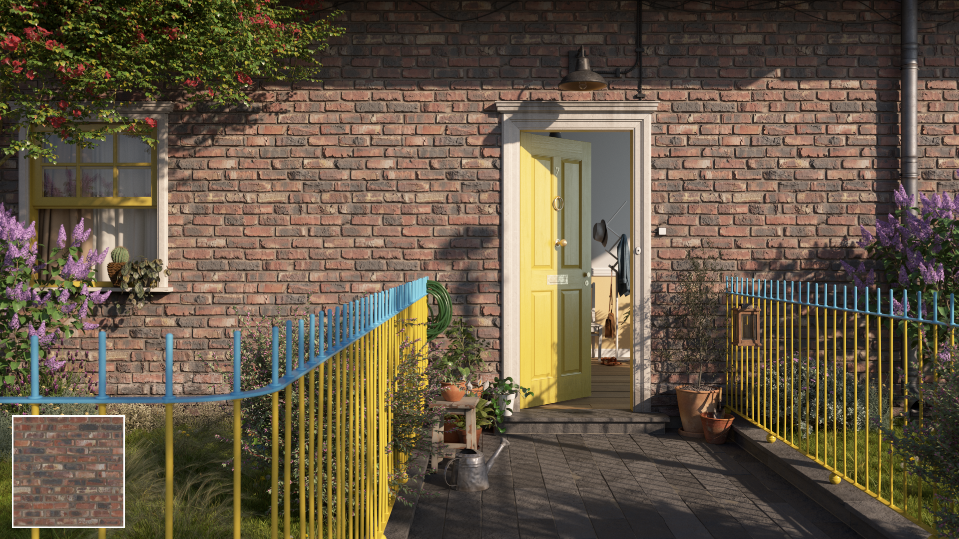

Examples
The following example illustrates a Layered texture used as a Diffuse map in the Brick wall material.
Layered texture with a Base layer only.
Additional layer with a Gradient map
Blending Mode = Color, Opacity = 1
Additional layer with a grey color and an Opacity map
Blending Mode = Darken
Additional layer with Dirt texture
Blending Mode = Multiply, Opacity = 0.85
