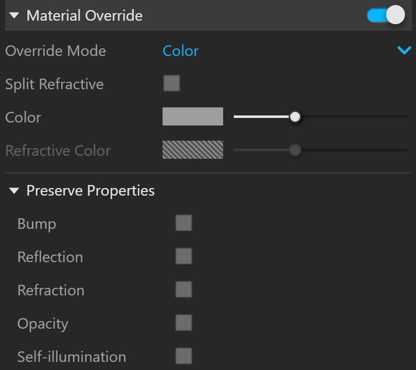

Material Override – When enabled, you can override the scene materials when rendering. All objects are rendered with the override material selected, or with a default material using the Color for diffuse shading.
Override Mode – Determines the override material mode.
Color – A diffuse material with the specified color is used.
Material – The selected scene material is used.

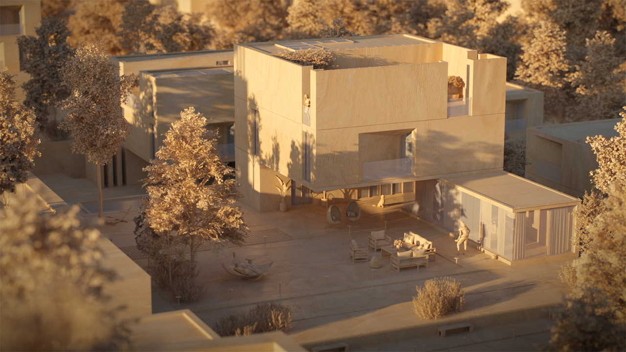

Preset – A predefined material is used. The available presets are: White, Arctic, Clay, Dark Clay, Plastic, and Wood. See the example for a preview.
Split Refractive – Enables a custom override option for all refractive materials.
Color – (Available when Override Mode is Color) Specifies the color of the override material. See the example for a preview.
Material – (Available when Override Mode is Material) Specfies the material to override the original project materials when rendering. All objects are rendered with the selected material applied. Materials with the option Can be Overridden disabled are not affected. See the example for a preview.
Preserving Properties work only when the Override Material is a Generic material type.
Refractive Color – Specifies the color of the material to override the refractive project materials when rendering.
Round Edges – (Available when Override Mode is Preset) When enabled, edge rounding is applied to the override material.
Effects Scale – (Available when Override Mode is Preset) Scales the dirt and edge rounding radiuses as well as the size of the texture/s of the override material. Can be used when the default effects size doesn't work well in the current project.

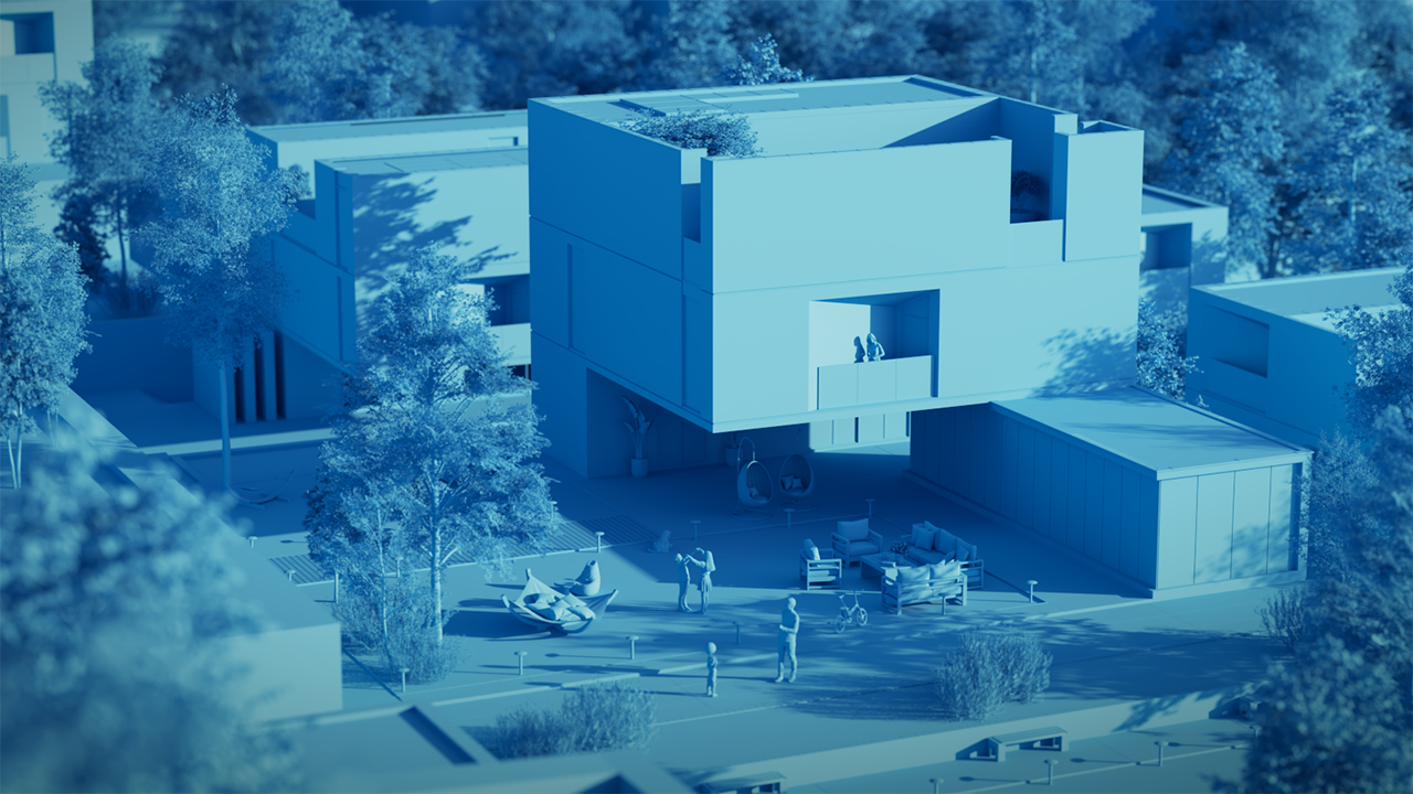

Example: Override Mode Color
This example showcases the different material overrides when the Override Mode is set to Color.
Click on the images to view them in full size.
Color RGB: 110, 175, 215

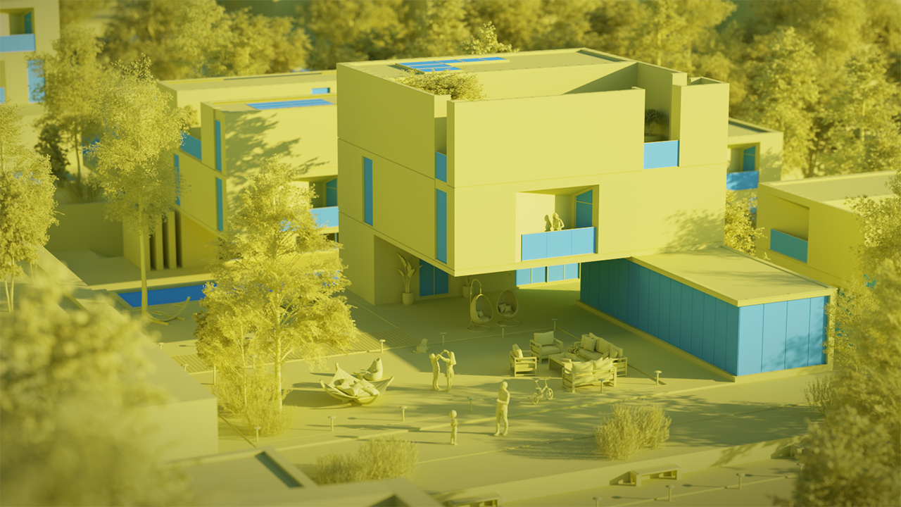

Color RGB: 215, 215, 115
Color RGB: 215, 215, 115, Refractive Color RGB: 110, 175, 215

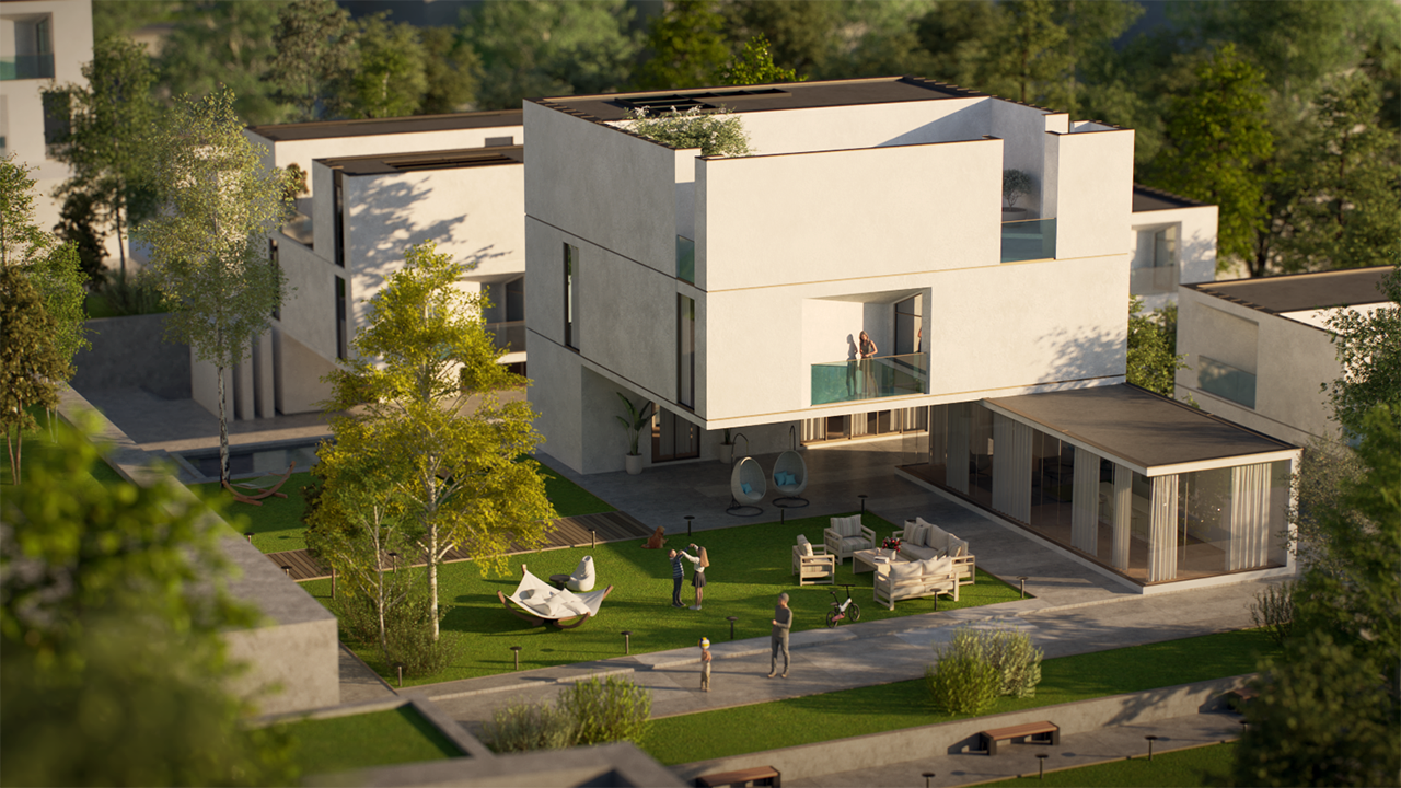

Original Render

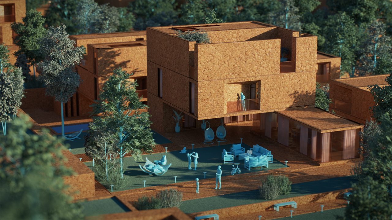

Example: Override Mode Material
This example showcases the different material overrides when the Override Mode is set to Material.

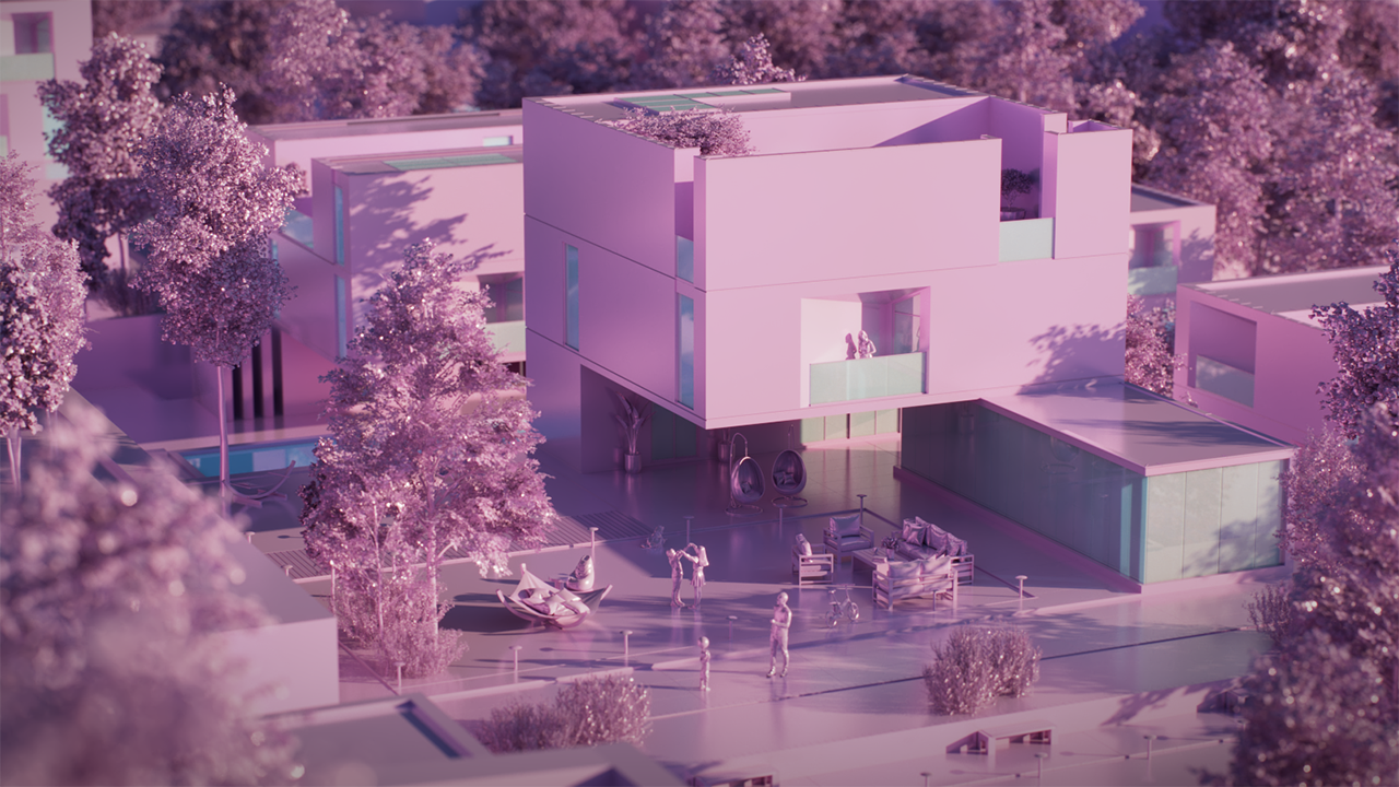

Pain Pink Glossy material, Glass Turquoise Frosted Refractive material

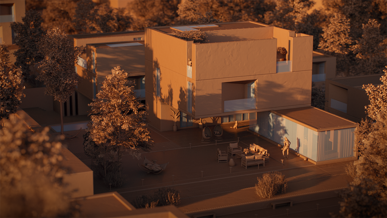

Cork Material, Acryl Tinted Refractive Material
Original Render

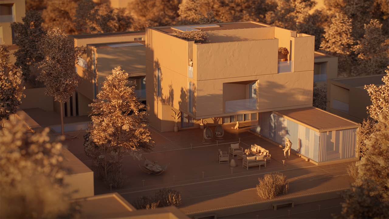

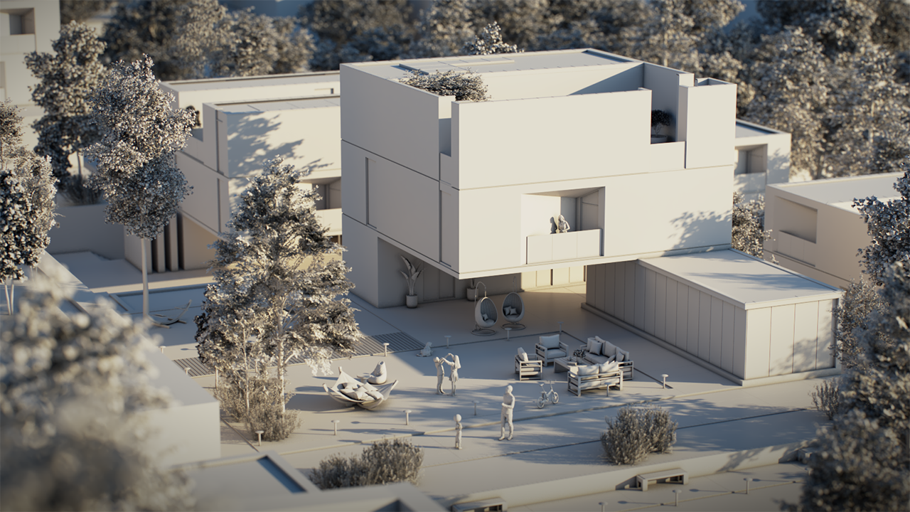

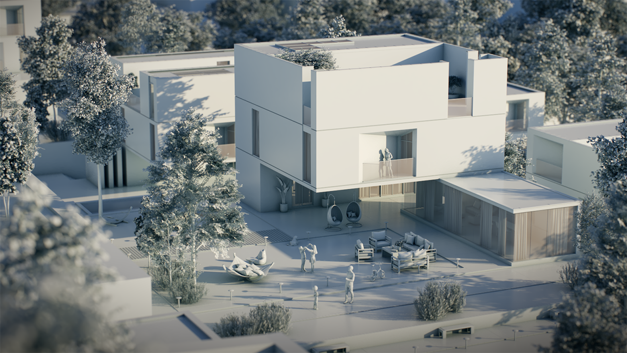

Example: Override Mode Presets
This example showcases the different presets available when the Override Mode is set to Preset.
White
Arctic Preset
Clay
Dark Clay
Plastic

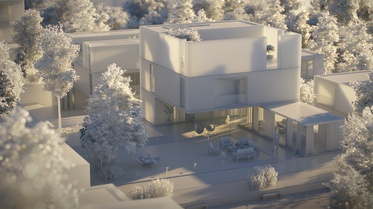

Wood
Original Render

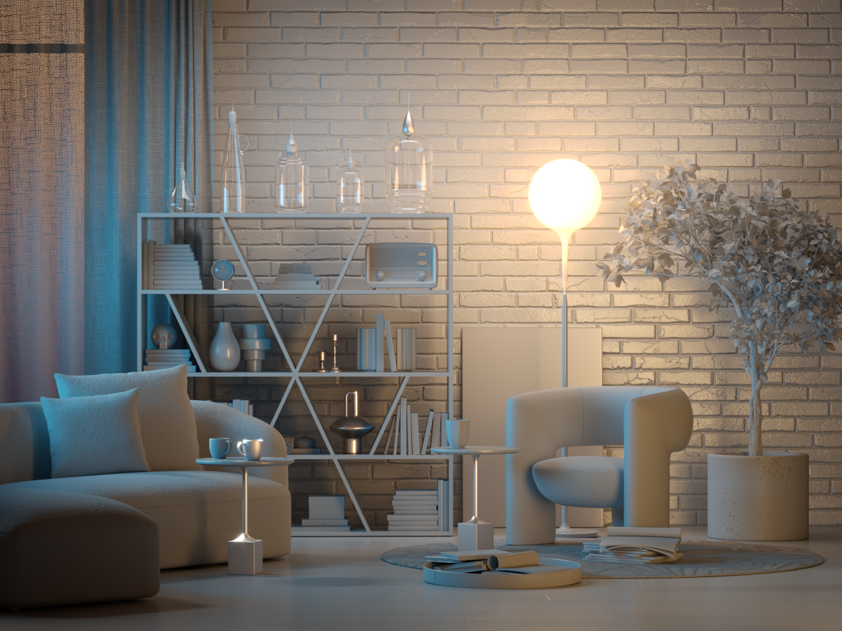

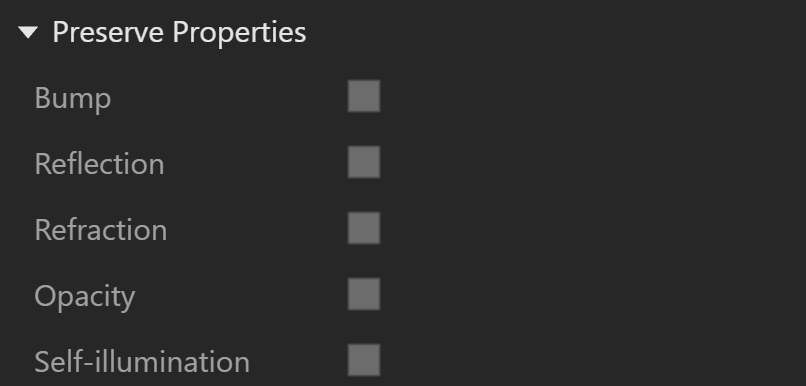

Preserve Properties
Enabling any of the checkboxes under the Preserve Properties rollout, preserves the original appearance of the selected material property. See the example for a preview.
Bump – When enabled, preserves the original appearance of the Bump property.
Reflection – When enabled, preserves the original appearance of the Reflection property.
Refraction – When enabled, preserves the original appearance of the Refraction property.
Opacity – When enabled, preserves the original appearance of the Opacity property.
Self-illumination – When enabled, preserves the original appearance of the Self-illumination property.

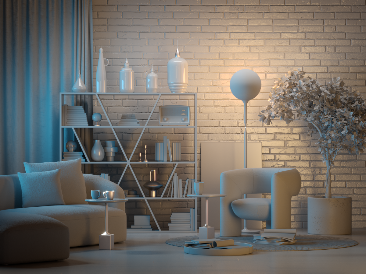

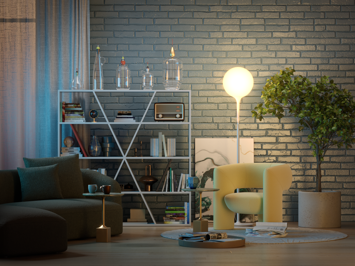

Original Render
Material Override = On; Mode = Color R200; G200; B200

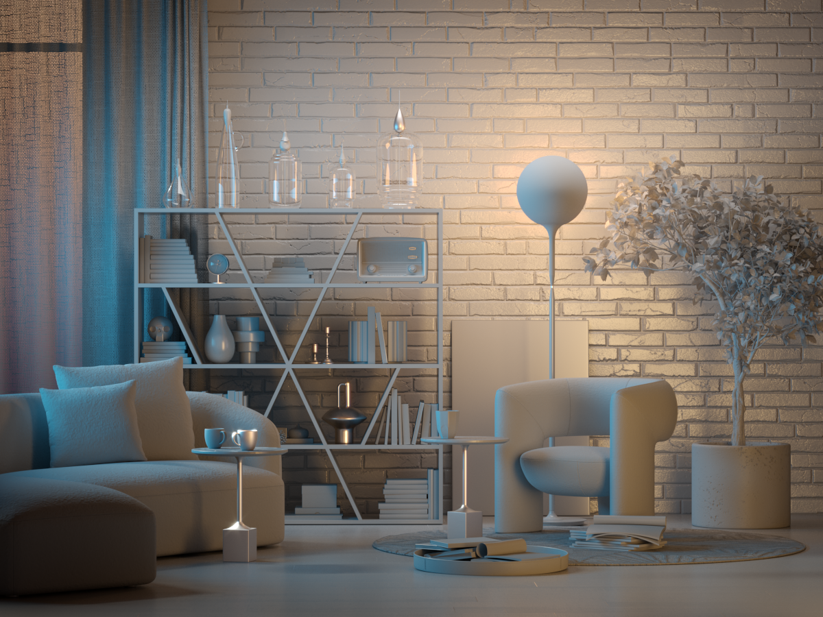

Material Override = On; Preserve Properties = Bump
Material Override = On; Preserve Properties = Bump; Reflection
Material Override = On; Preserve Properties = Bump; Reflection; Refraction
Material Override = On; Preserve Properties = Bump; Reflection; Refraction; Opacity
Material Override = On; Preserve Properties = Bump; Reflection; Refraction; Opacity; Self-illumination
