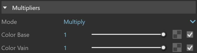

Multipliers
Mode – Specifies the multiplication mode of the colors.
Multiply – Multiplies the RGB numbers for each pixel of the top layer with the RGB number of the corresponding pixel from the bottom layer. The result is a darker picture.
Blend Amount  Takes each pixel from the top layer if present. Otherwise the bottom layer is used.
Color A – Controls the intensity of the first color. When a texture is selected, it overrides the color as long as the texture checkbox is enabled.
Color B – Controls the intensity of the second color. When a texture is selected, it overrides the color as long as the texture checkbox is enabled.
