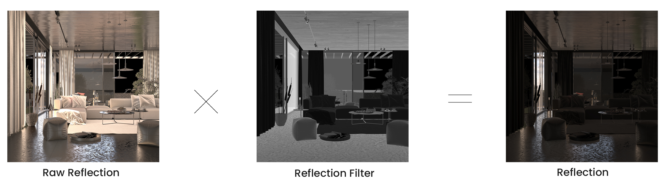

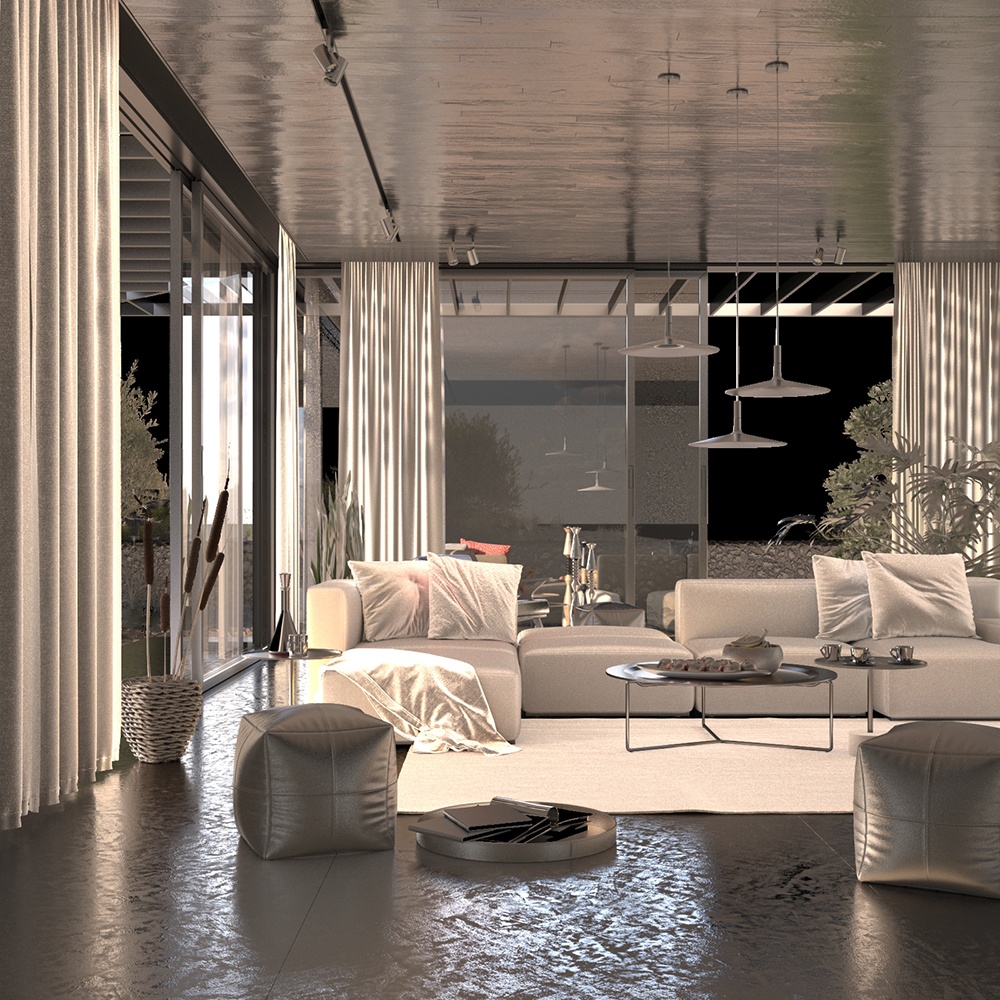

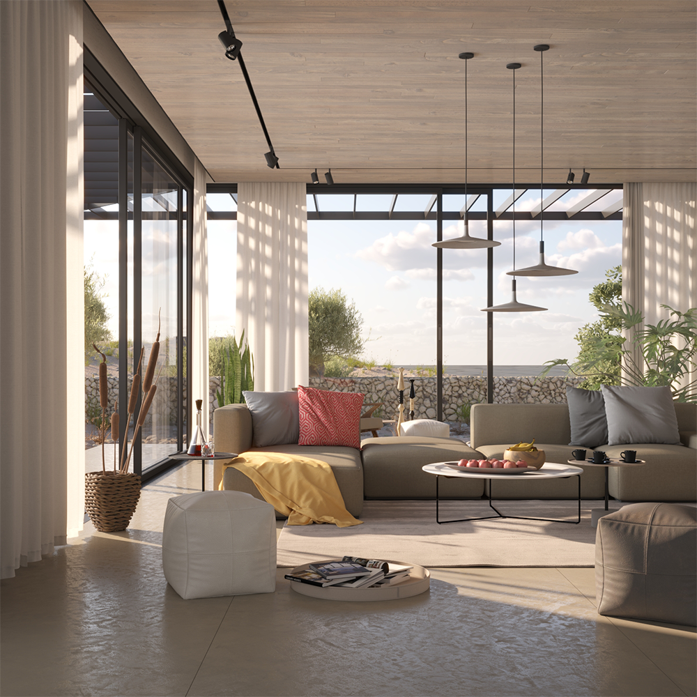

The Raw Reflection Render Element is useful for changing the appearance of reflective scene elements in compositing or image editing software after the scene is rendered. See below how a scene looks before and after post-production. The reflections are reduced by increasing the intensity of the Reflection Filter RE. The result is then multiplied by the Raw Reflection to achieve the full reflections.
Before
After
Compositing
Raw Reflection x Reflection Filter = Reflection
