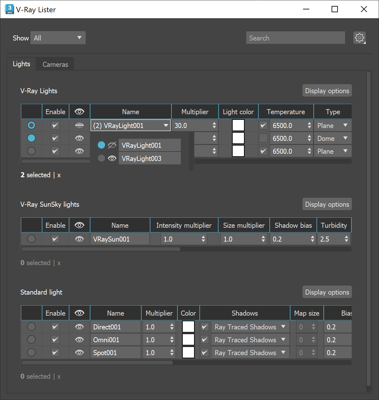

The Lights tab controls common parameters for all lights in the scene.
Lights can be enabled or disabled from the Enable checkbox.
In the Light tab, instanced lights appear as a single entry with a dropdown. Editing any parameters for the entry affects all instances. The dropdown can be used to select a specific instance in the viewport.
For more information on the parameters displayed for V-Ray lights in the Lister, see the respective page for the specific light type.
