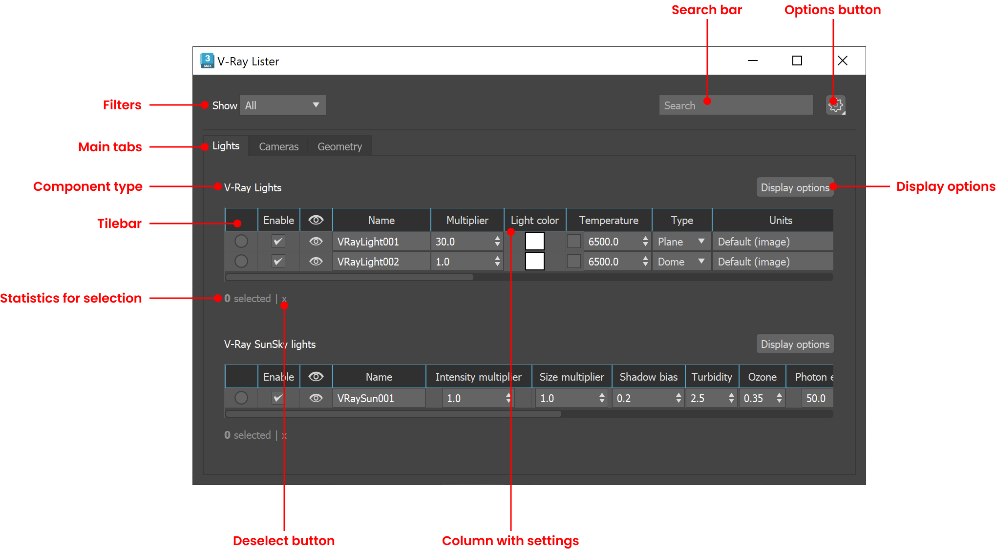

General Settings
Here are the main components of the Lister. They are available for all tabs:
Filters – Filters the objects by Groups, Layers, and Selection sets.
Search bar – Searches for an object. You need to enter at least 3 symbols in the field. If a filter is applied, it searches only from the stack with the filtered objects.
Options – Offers options for loading, saving and resetting layouts.
Load Layout – Opens the Choose settings file to load window and loads a .vrlst layout file. See the Default and Custom Layouts section for more information.
Save Layout – Opens the Choose saved file destination window and saves the current settings as a layout preset in a .vrlst format.
Reset Layout – Resets the layout to its default state.
Display options – Opens the Display options dialog where you can add or remove shown parameters.
Note that some of the additional columns contain settings that should not be modified as the modifications would have no effect. However, V-Ray provides access to them and you can check their default values.
Titlebar – All cells except for the first 4 cells can be rearranged. The first 4 cells are always going to stay in the same order. The Name cell is stretchable, while the rest of the cells are not.
Statistics for selection – Shows the number of selected objects.
Deselect – Deselects all objects.

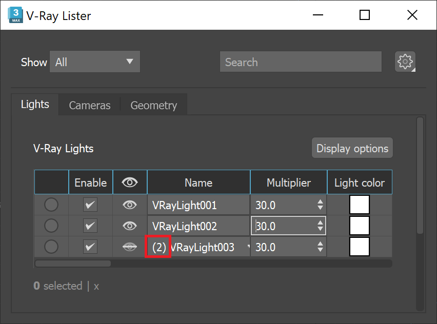

The number of instanced lights or cameras is marked in brackets in front of the object’s name.
Max2024_VRay7Beta_Lister_Numbers
Note that the Lights and Cameras tabs can be rearranged by dragging them.

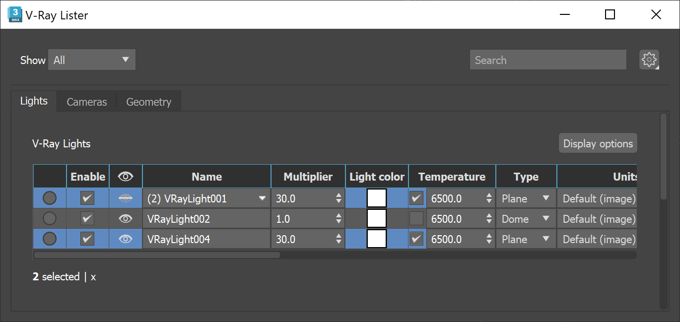

Selection
The following options are available for all tabs:
– Indicates an unselected light, camera, or geometry.
– Indicates a selected light, camera, or geometry.
– Indicates a combination of selected and unselected lights/cameras/geometry under the same row of instances. If all instances are selected, the circle becomes fully blue, and the opposite - if all instanced lights/cameras/geometry are deselected, the circle becomes gray.
Press Ctrl and click the Selection () icon of a to make a multiple selection.
Press Ctrl while clicking on multiple rows without selecting any of the settings, then change a setting and the change will be propagated to all selected lights/cameras/geometry.
Max2024_VRay7Beta_Lister_MultipleSelection
Click on the image to enlarge it.
Max2024_VRay7Beta_Lister_SelectionIcons

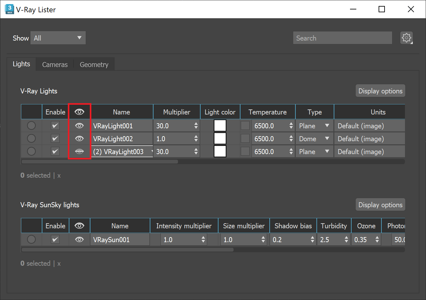

Visibility
– Indicates that the light, camera, or geometry is visible.
– Indicates light, camera, or geometry is invisible.
– Indicates a combination of visible and invisible lights/cameras/geometry under the same row of instances.
Press Ctrl and click the Visibility () icon of an object to make a multiple selection.
Max2024_VRay7Beta_Lister_VisibilityIcons

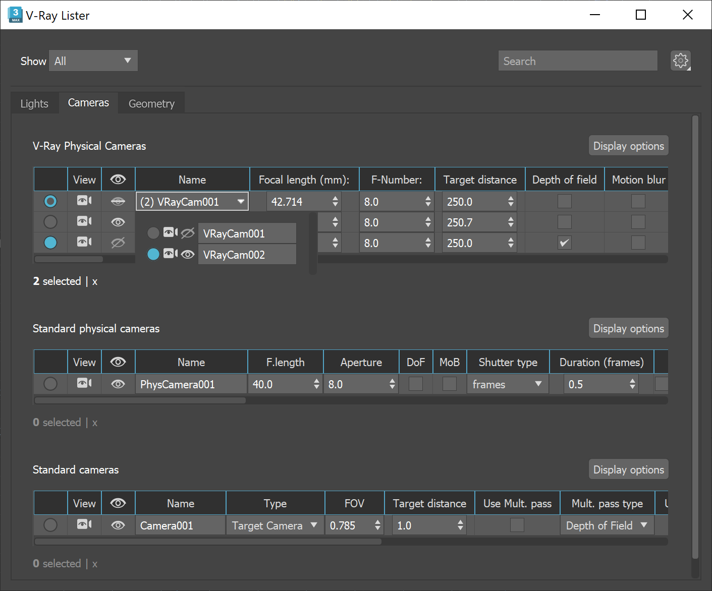

Cameras Tab
The Cameras tab controls common parameters for all cameras in the scene.
The Look through () icon sets the active viewport to look through the specified camera.
For more information on the parameters displayed for V-Ray Physical Camera in the Lister, see the VRayPhysicalCamera page.
Note that changes done to the parameters in the Camera tab cannot be undone from the Edit > Undo menu.
Max2024_VRay7Beta_Lister_CamerasTab

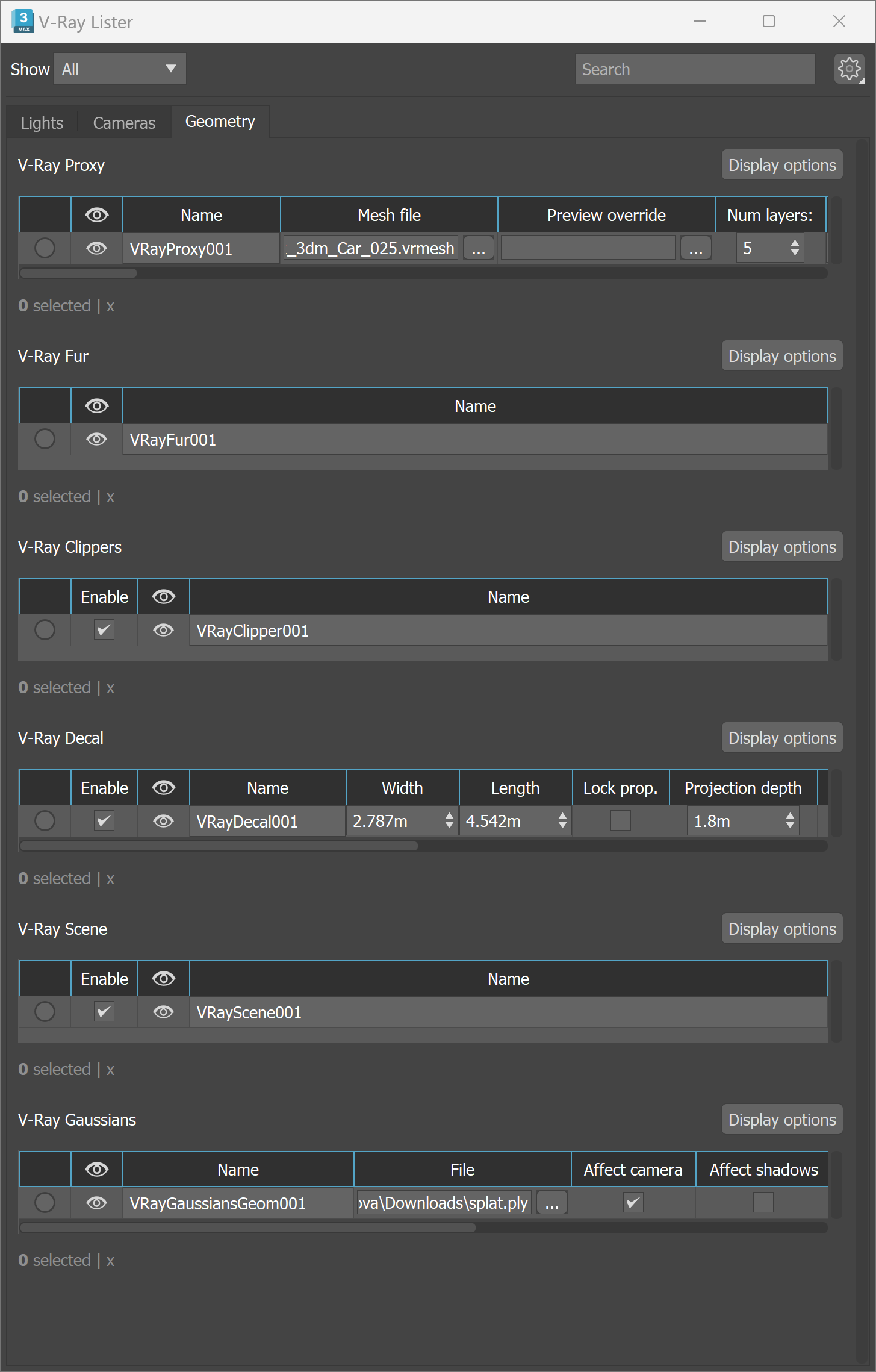

Geometry Tab
The Geometry tab controls common parameters for V-Ray objects in the scene.
Currently, the available geometric objects include VRayProxy, VRayFur, VrayClipper, VRayDecal, VRayScene, and VRayGaussiansGeom
Max2024_VRay7Beta_Lister_Geometry
