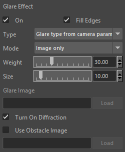

Glare Effect
Image Removed
On – Enables the Glare Lens effect.
Fill Edges – Enabling this option will add pixel data outside the edges of the original image. This will remove the darkening around the edges.
Type – Specifies how the glare is computed. The possible values are:
From image – Takes the image specified in Glare Image as filter kernel.
From render camera – Takes the necessary parameters from the camera used to perform the rendering and automatically generates the filter kernel.
Glare type from camera params – Takes the camera parameters specified in the VRayLensEffects render effect itself and automatically generates the filter kernel.
Mode – Determines if the glare effect will be applied to the final image, stored into a separate render element, or both.
Weight – Specifies the strength of the interpolation between the filtered image and the original image.
Size – Specifies the size of the filter as percentage of the image's width.
Glare Image – Path to the filter kernel. Available if From Image option is selected. You can create filters using the Filter generator tool which comes with the V-Ray for Maya installation.
Turn On Diffraction – Enables the diffraction, producing colored patterns in the glare.
Use Obstacle Image – Enable the use of the obstacle image the path to which is specified in the field below. The obstacle image allows you to draw the aperture shape as wall as any dirt or scratches on the lens which will affect the glare
