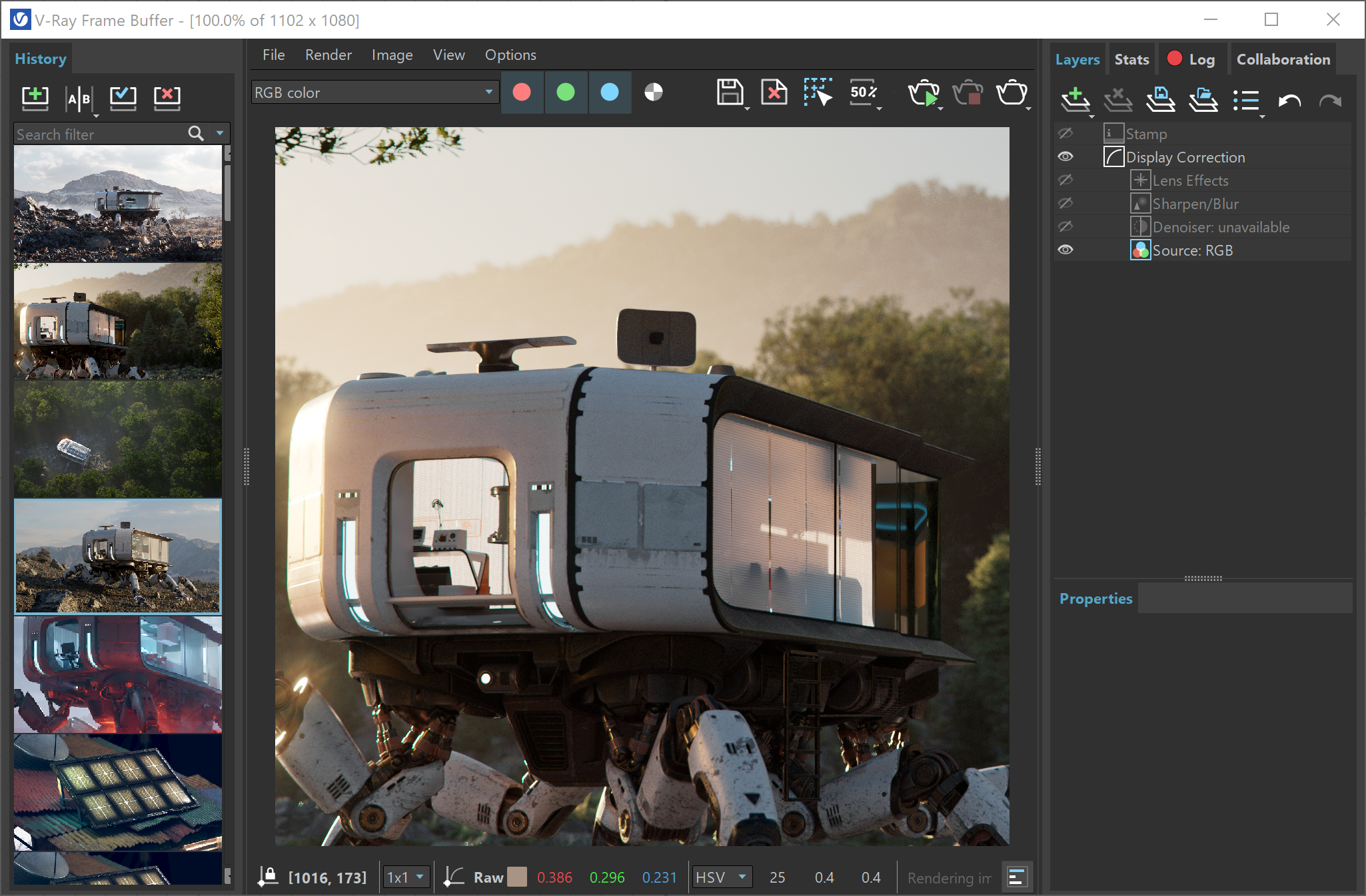

The V-Ray Frame Buffer (VFB) is a second-generation V-Ray virtual frame buffer.
VFB is much more than a render image holder. It provides a higher level of post-processing adjustments and the ability to modify your scene from inside the VFB. Here is a list of benefits you should know:
  • Image preview:
    Loads render channels via a dropdown list;
    Works with display corrections;
    Loads various 8-bit and 32-bit file formats, including V-Ray resumable files;
    Image comparison between 2 or 4 renders;
  • Image management:
    Keeps the rendered image in full 32-bit floating point format;
    Can store history of rendered images with their post-rendering corrections;
    Can save corrected output to various image formats;
  • Image editing and post-processing:
    Set Color Corrections for rendered image and its channels;
    Composite mode for Back to Beauty workflow including layers corrections;
    LightMix control on lights contribution in the rendered image;
  • Scene editing:
    Can modify actual light values by transferring updated intensity and color from LightMix mode;
    IPR camera navigation and focus control from inside VFB;
  • Render management:
    Denoiser control;
    Region rendering control and test resolution;
    Allows you to choose the order in which the buckets are rendered;
    Automatic render resolution adjustment in IPR when the VFB window is resized;

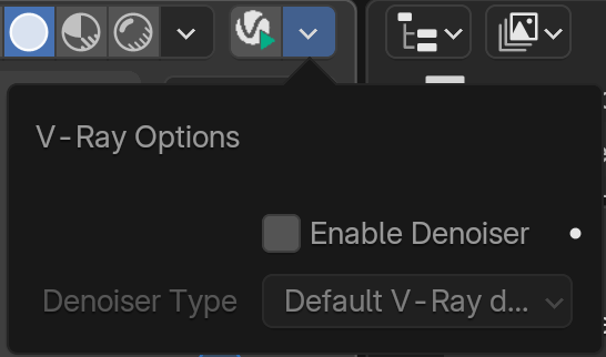

||Viewport|| > Start Interactive Render button. This starts an interactive render inside the V-Ray Frame Buffer.
Clicking on the arrow opens a sub-menu with denoising options, which are applied to the interactive render, when it starts in the VFB.
For information on the different Denoiser types, see the V-Ray Denoiser page.

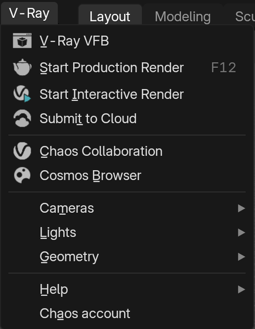

||V-Ray menu|| > V-Ray VFB, Start Production Render, Start Interactive Render

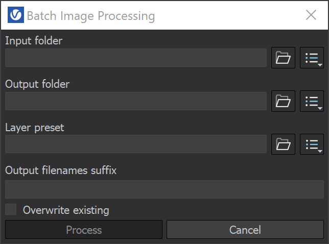

Batch image processing – Allows processing of multiple .vrimg files with the same layer tree changes at the same time.
Batch Image Processing
Input folder – Specifies a path to load images from.
Output folder – Specifies a path for the output images.
Layer preset – Specifies a path to a layer tree corrections preset.
Output filenames suffix – Specifies the suffix added to the output image filenames.
Overwrite existing – Enables overwrite of existing files with the same name in the output folder.

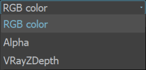

This dropdown gives access to render channels rendered for the scene. The selected render channel is displayed in the VFB. By default, the RGB color and Alpha render channels are available. Any additional render channels that have been added to the scene also appear in the drop-down.

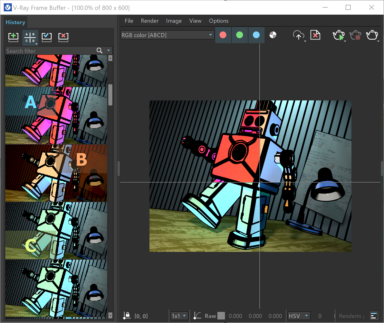

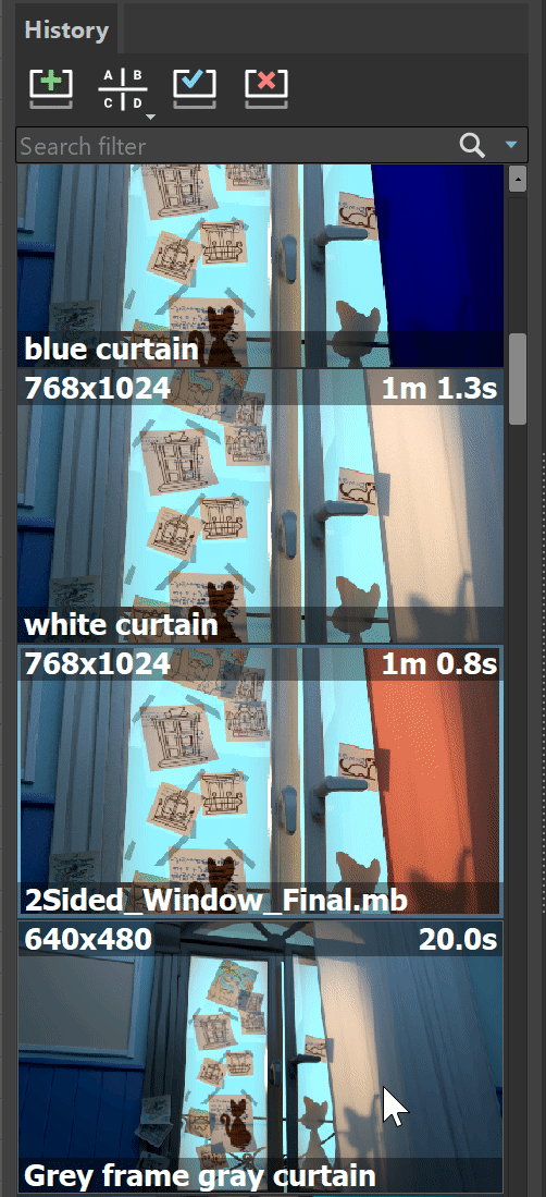

Render History
The V-Ray Frame Buffer keeps a history of previously rendered images and lists each with a number, thumbnail, and textual details in the Render history panel. Up to four images can be called from the history to be compared in the VFB (as shown in this section). History files are stored as .vrimg files in a user-specified folder. Render history settings can be configured in the VFB Settings window.
Saves the current image from the VFB to the render history. The image is placed at the top of the render history list.
Enables or disables image A/B vertical comparison. Select images A and B from the render history. You can switch between comparison modes by holding down on this button or by using the hotkeys.
Enables or disables image A/B horizontal comparison. Select images A and B from the render history. You can switch between comparison modes by holding down on this button or by using the hotkeys.
Enables or disables image A/B/C/D comparison. Select images A, B, C, and D from the render history. You can switch between comparison modes by holding down on this button or by using the hotkeys.
Loads the selected image from the render history to the VFB.
Removes the selected image from the render history.
A search field where you can filter the images based on the scene paths and notes.
The keyboard keys from 1 to 9 can be used to quickly load the first 9 images from the history to the VFB.
Edit note – Allows you to add a text comment to the image; the comment appears below the image.
Set A – Sets the render as A image for comparison.
Set B –  Sets the render as B image for comparison.
Load to VFB – Loads the selected image in the VFB (same as double-clicking on the image).
Delete – Deletes the selected image from history. The image is moved to the system's Recycle Bin and can be restored from there if needed.
Load layers – Loads the layer tree preset of the selected image.
Load V-Ray settings –  Loads the V-Ray settings used for the saved render.
Compare V-Ray settings – Opens the Compare V-Ray settings dialogue, where you can compare the render setups of saved renders.
Image Info – Opens a window containing detailed information about the image, including, but not limited to, Aperture, Camera Far and Near Range, File Path, V-Ray version, render time. Keep in mind that the camera values are saved in system units. Also, the vrayrevison info displayed in the list is not related to the saved .vrimg file but to the current V-Ray build installed for Blender.
Copy scene pathCopies the full path to the scene.
Copy project pathCopies the full path to the project.
Upload image(s) to Chaos Collaboration – Uploads an image to Chaos Cloud Collaboration for sharing and commenting.
Reload history – Re-reads the history image list. This may be needed if the history folder is updated outside of Blender (e.g. from another Blender session).
Manually saved .vrimg files can also be added to the History folder, but they need to be saved with all image channels in one .vrimg file to keep the complete image info.

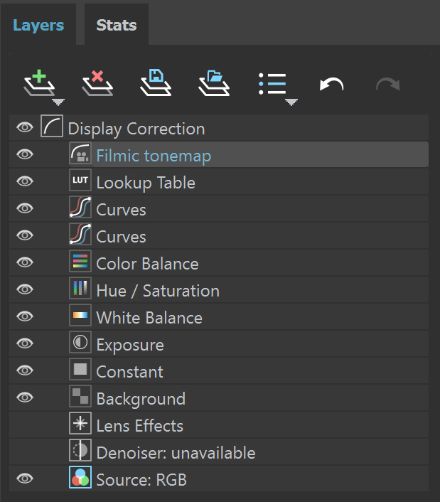

Layers
The V-Ray Frame Buffer includes a suite of color corrections and image-adjusting tools. The tools are added as layers and displayed in a layer tree. You can enable or disable a particular tool using the visibility icon () to the left of its name.
For more information on using the Layers, see the Layers page.
Creates a layer. Multiple layers of the same type can be added.
Folder – Allows grouping multiple layers;
Background – Adds a background color correction layer;
Render Element – Selects a render channel from your image that you can use in compositing. This is only available when the Source layer is set to Composite;
Constant – Adds a solid color that can be used to achieve an effect on another layer (for example to multiply by the constant);
Exposure – Adds an Exposure color correction layer;
White Balance – Adds a White Balance color correction layer;
Hue/Saturation – Adds a Hue/Saturation color correction layer;
Color Balance – Adds a Color Balance color correction layer;
Curves – Adds a Curves color correction layer;
Lookup Table – A Lookup Table layer allows loading a LUT file for color transformations;
Filmic Tonemap – Contains different types of mapping curves and gamma corrections. Also allows selection of a color space.
For more information, see the Layers page.
Deletes the selected layer(s).
Saves a layer tree preset.
Loads a layer tree preset.
Quick access to custom layer presets. You must set the path to it in the VFB Settings.
Undo create layer.
Redo create layer.

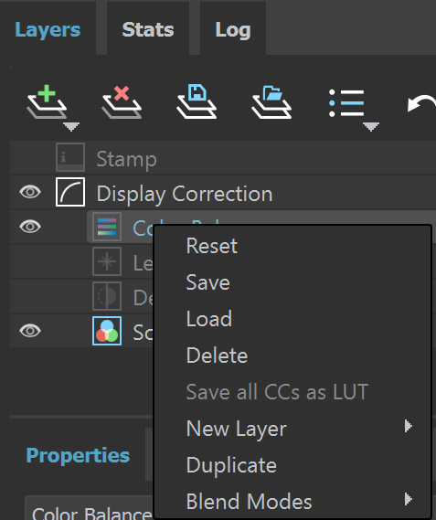

Each layer has a context menu. Right-click to display it:
CommandDescription
ResetResets all changes done to the selected layer.
SaveSaves the layer as a preset.
LoadLoads a preset for the selected layer.
DeleteDeletes the selected layer.
Save all CCs as LUTBakes all the color corrections to a LUT file.
New LayerCreates a new layer.
DuplicateDuplicates the selected layer.
Blend ModesSpecifies how the selected layer blends with the result from all layers below it. See the Layers page for more info on the types of Blend Modes.

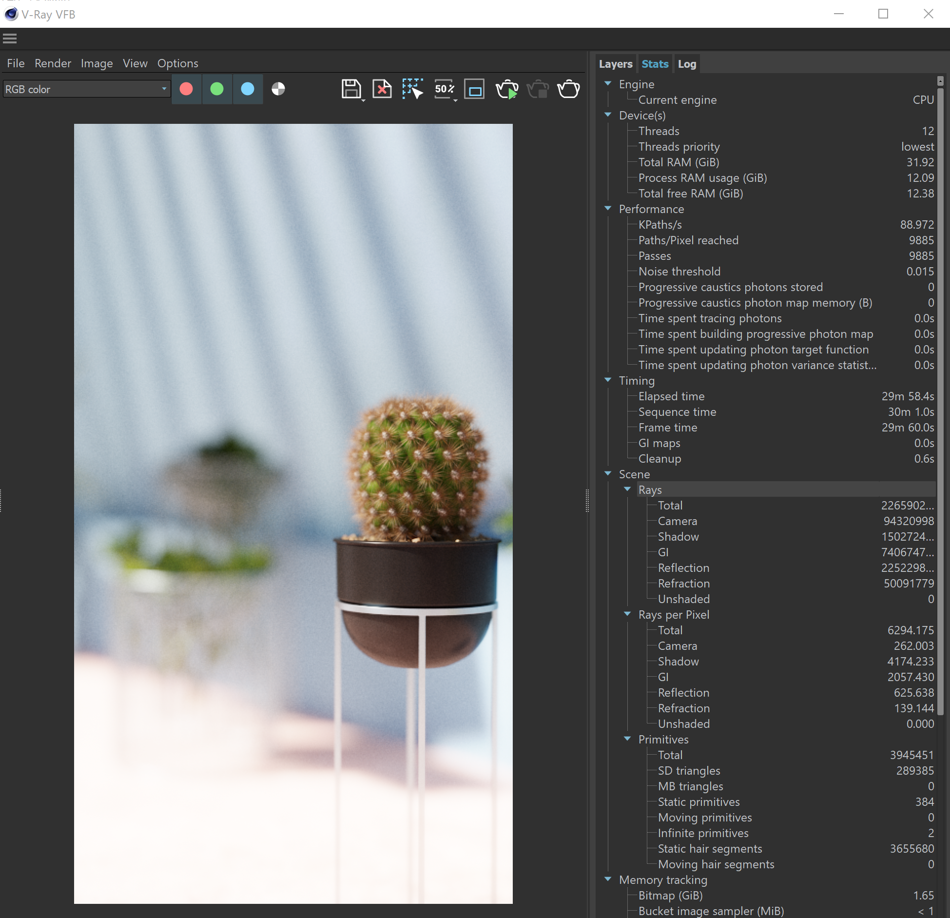

Stats
The V-Ray Frame Buffer allows monitoring of different statistics and information about your scene in the Stats panel. The exact contents of the Stats changes depending on the scene,  the rendering mode (interactive vs. production, bucket vs. progressive), and others.
Right-click to display a context menu, allowing you to copy the Stats values.

QSet history A/B vertical compare mode
WSet history A/B horizontal compare mode
EEnable history A/B/C/D compare mode
1-9Load the respective image from the VFB history
HShow/hide history
Ctrl+LShow/hide the whole right panel
PShow/hide only layers of tree
