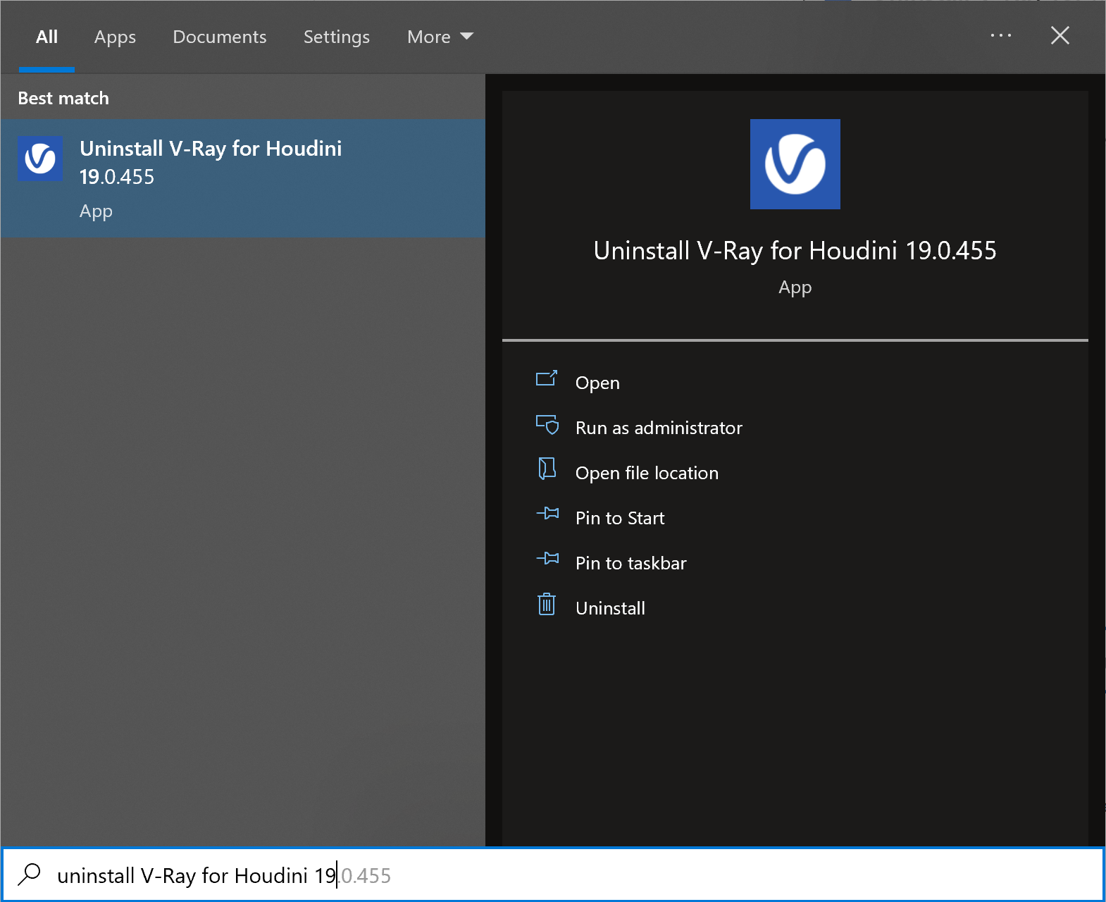

After the uninstall is complete, there may be some leftover files that you need to delete.
$ su
$ /usr/ChaosGroup/V-Ray/Houdini_##.#.###/uninstall/uninstaller
follow the instructions of the uninstaller
$ exit
Note: The uninstaller will does not remove the V-Ray license configuration files or any other files that you have modified manually after the installation.
