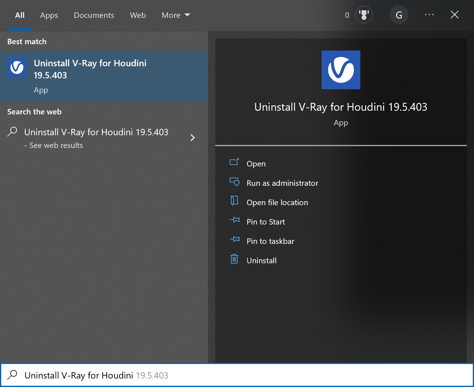

The Uninstaller originally resides in the following location - C:\Program Files\Chaos Group\V-Ray\Houdini ##.#.###\uninstall
To access the V-Ray uninstaller from the Start menu, search for Uninstall V-Ray Houdini ##.#.###.
This starts the V-Ray uninstaller. Follow the on-screen instructions to remove V-Ray from your system and restore any files overwritten by the installation.
