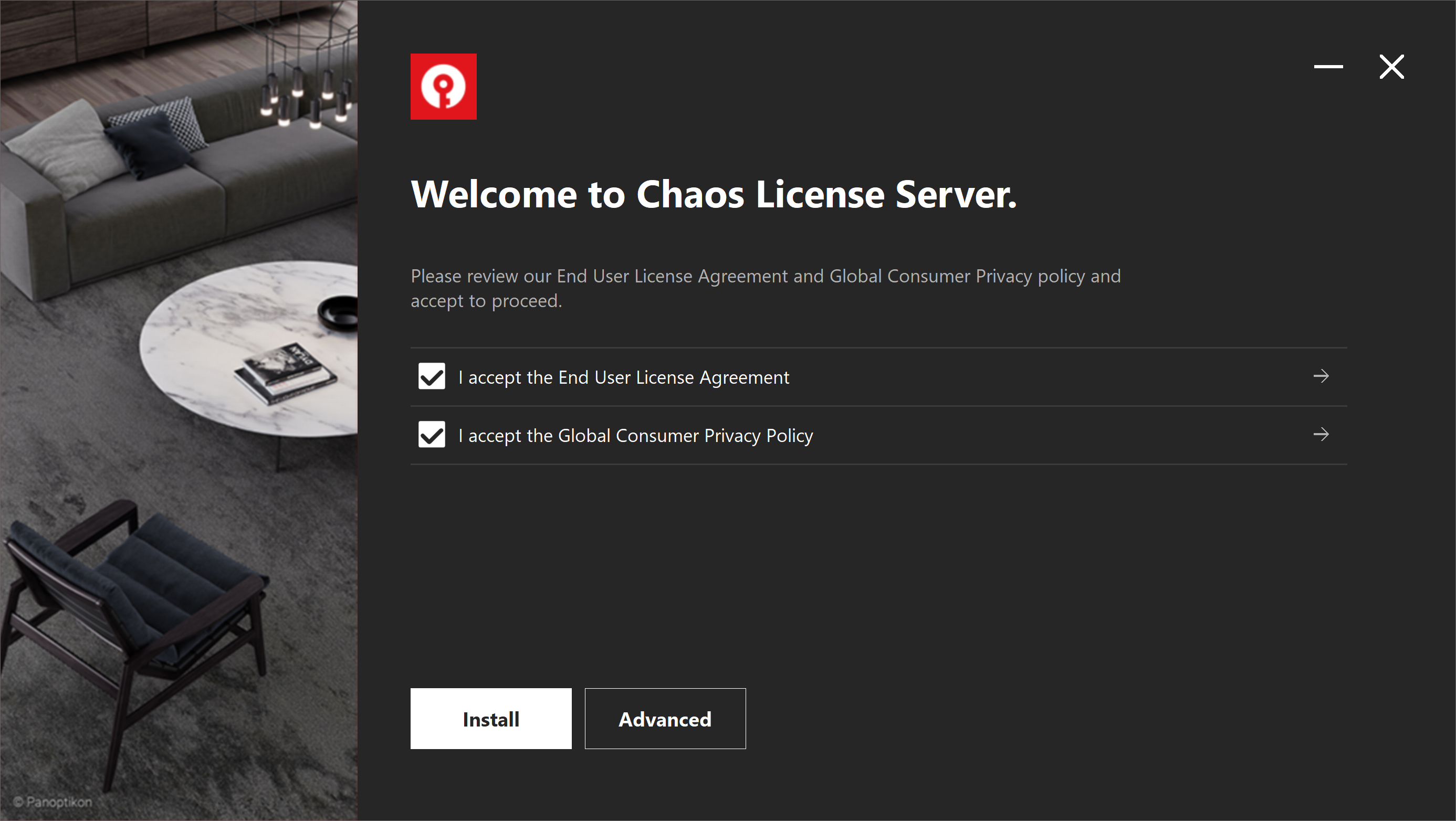

Please read Read carefully and accept the End User License Server Agreement and the Global Consumer Privacy Policy.
Then, click on the Install button. Click on I accept the Agreement when done. Then you can click on Install to start the installation. If you want to modify the installation, click on the Advanced button.
