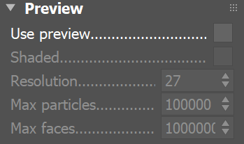

Preview rollout
Section
Column
width60%
This group controls the viewport preview of the metaball surface. Note that the preview uses the particles that are displayed in the viewport by the Particle Flow systems, and this may be different from the number of particles in the rendering, which may lead to the preview looking different. To avoid this, set the Particle Flow system to display 100% of all particles in the viewport.
Use  – previewEnables the viewport preview.
Shaded – Enables shaded drawing of the viewport preview. When disabled, the preview is drawn in wireframe mode.
Resolution – Specifies the maximum grid resolution used to compute the viewport preview. Lower values produce a rougher approximation of the metaballs surface that takes less memory and is faster to compute. Higher values produce more accurate previews at the expense of more RAM and slower calculation speed.
Max particles – Controls the maximum number of particles that are used to compute the viewport preview.
Max faces – Specifies the maximum number of triangle faces in the viewport preview.
