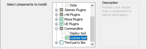

CML: COMMAND-LINE LICENSE
Forces the installer to select the  Command-line License option:

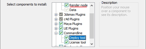

CMD: COMMAND-LINE DEPLOY TOOLS
Forces the installer to select the  Command-line Deploy Tools option:
This option must be used in conjunction with the FRN option because it is only available when used with the Render Node installation.

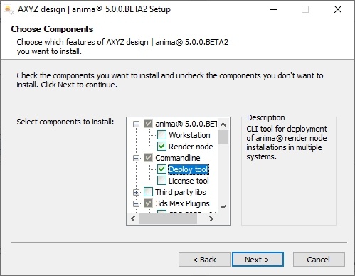

Now you can install the Command-Line Deploy tool using the standard installer. Just make sure to select the Render Node installation and the Command-line component in the list as shown in the image below.

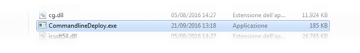

After the installation, the tool can be located inside anima® installation folder, usually “C:\Program Files\AXYZ design\anima“. Running the program will generate a log file (log.txt) that explains the available parameters and summaries of what they do.
