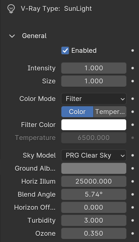

General
Enabled – Turns the sun light on and off.
Intensity – Specifies the brightness of the sun. Since the sun is very bright by default, you can use this parameter to reduce its effect. This option is not available with V-Ray GPU.
Size – Controls the visible size of the sun. This affects the appearance of the sun disc as seen by the camera and reflections, as well as the blurriness of the sun shadows.
Filter Color – Shifts the hue of the V-Ray Sun and Sky system towards the specified color. This option is not available with V-Ray GPU.
Color Mode – This mode affects the way the Filter Color hues the sun and sky light.
Filter – Shifts the V-Ray Sun and Sky hue towards the color specified by the Filter Color.
Direct – Takes the Filter Color for the V-Ray Sun light. In this case, the light intensity is controlled by the Intensity multiplier and it does not depend on the Sun's position in the sky.
Override – Takes the Filter Color for the V-Ray Sun light, however the intensity is controlled by the position of the V-Ray Sun in the sky.
Filter Color –
Temperature –
Sky Model – Determines the procedural model used to generate the V-Ray Sky texture:
Preetham et al. – The VRaySky procedural texture is generated based on the Preetham et al. method.
CIE Clear – The VRaySky procedural texture is generated based on the CIE method for a clear sky.
CIE Overcast – The VRaySky procedural texture is generated based on the CIE method for a cloudy sky.
Hosek et al. – The VRaySky procedural texture is generated based on the Hosek et al. method.
PRG Clear Sky – The VRaySky procedural texture is generated based on the Improved method which has enhanced sunrise and sunset sky.
Ground Albedo – Sets the color of the V-Ray Sun and Sky system's ground. This option is not available with V-Ray GPU.
Horiz Illum – Specifies the intensity (in lx) of the illumination on horizontal surfaces coming from the sky. This parameter is enabled when one of the CIE Sky Models are selected. This option is not available with V-Ray GPU.
Blend Angle – Specifies the angle in degrees where blending occurs between the horizon line and sky. Values close to 0.0 produce a sharper horizon line, while larger values produce a softer horizon line. This option is not available with V-Ray GPU.
Horizon Offset – Allows the user to manually lower the horizon line.
Turbidity – Determines the amount of dust in the air, which in turn affects the color of the sun and sky. Smaller values produce a clear, blue sky and sun similar to what is seen in rural areas, while larger values make the sun and sky more yellow and orange as seen in a big city. This option is not available with V-Ray GPU.
Ozone – Affects the color of the sun light. Available in the range between 0.0 and 1.0. Smaller values make the sunlight more yellow, while larger values make it bluer. This option is not available with V-Ray GPU.

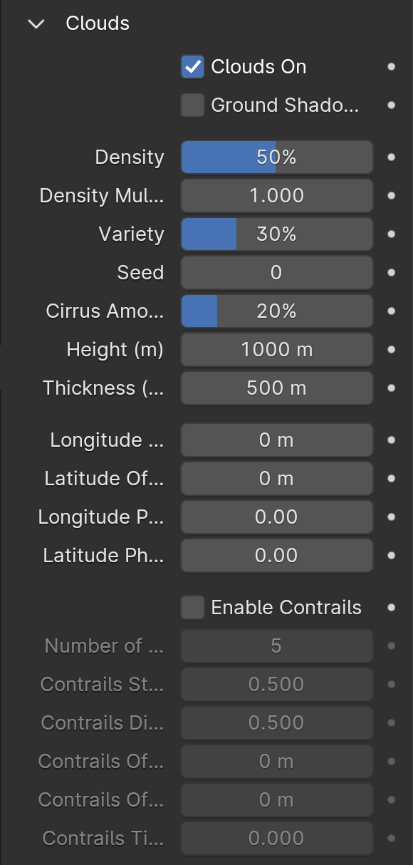

Clouds
Clouds On – Enables the cloud system.
Ground Shadows – When enabled, casts shadows from the clouds. See the Clouds Ground Shadows example for more information.
Density – Controls the density of the cumulus and stratus types of clouds. A value of 1 fills up the sky with clouds. See the Clouds Density example for more information.
Denisty Multiplier –
Variety – Controls the variety of the cumulus and stratus types of clouds. See the Clouds Variety example for more information.
Seed – Generates a random value, based on the given number, to change the pattern of the clouds and the Contrails.
Cirrus Amount – The maximum value of 1 fills the sky with cirrus clouds. Decreasing the value, lowers the presence of such clouds. When set to 0, the cirrus clouds are completely gone. See the Clouds Cirrus Amount example for more information.
Height (m) – Determines the Clouds position in height. See the Clouds Height example for more information.
Thickness (m) – Lower values make the cumulus and stratus types of clouds thin and sheer/lucent, while higher values make them full and heavy. See the Clouds Thickness example for more information.
Longitude Offset (m) – Moves the cloud system by the X axis. See the Clouds Offset example for more information.
Latitude Offset (m) – Moves the cloud system by the Y axis. See the Clouds Offset example for more information.
Longitude Phase (%) – Controls the phase by the X axis, can be used to fine-tweak the cumulus and stratus clouds appearance. The appearance of the clouds loops at 0, 100, 200, etc. This parameter can be animated to resemble natural clouds appearance.
Latitude Phase (%) – Controls the phase by the Y axis. Can be used to fine-tweak the cumulus and stratus clouds appearance. The appearance of the clouds loops at 0, 100, 200, etc. This parameter can be animated to resemble natural clouds appearance.
Enable Contrails – When enabled, plane contrails are simulates in the sky.
Number of Contrails – Determines the number of contrails generated. See the Number of Contrails example for more information.
Contrails Strength – Determines the opacity of the contrails. Lower values create less opaque trails, which look older. See the Contrails Strength example for more information.
Contrails Distortion – Determines the amount of distortion in the contrails. See the Contrails Distortion example for more details.
Contrails Offset Longitude/Latitude (m) – Offsets the contrails by a given value, according to the X or Y axis. See the Contrails Offset example for more information.
Contrails Time – Determines how long along their way the planes are. See the Contrails Time animation for more details.

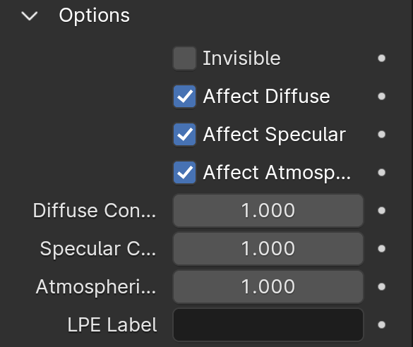

Options
Invisible – When enabled, makes the sun invisible, both to the camera and to reflections. This is useful to prevent bright speckles on glossy surfaces where a ray with low probability hits the extremely bright sun disk.
Affect Diffuse – Determines whether the Sun affects the diffuse properties of the materials.
Affect Specular – Determines whether the Sun affects the specular of the materials. The multiplier controls the sun's contribution to specular reflections.
Affect Atmospherics – When enabled, the light influences the atmospheric effects in the scene. This option is not available with V-Ray GPU.
Diffuse Contribution – Controls the Sun's contribution to the diffuse illumination.
Specular Contribution – Controls the Sun's contribution to the specular reflection.
Atmospherics Contribution – Determines the amount of influence the light has on the atmospheric effects.
LPE Label – Allows a label to be assigned, which can be used to reference the light in a Light Path Expression. This is especially useful when working with the Light Select render element to evaluate custom light contribution in the scene.

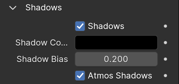

Shadows
Shadows – When enabled, the objects in the scene cast shadows.
Shadow Color/Texture – Specifies a color or a texture map for the shadows. This option is not available with V-Ray GPU.
Shadow Bias – Moves the shadow toward or away from the shadow-casting object. Higher values move the shadow toward the object, while lower values move it away. If this value is too extreme, shadows can "leak" through places they shouldn't or "detach" from an object. Other effects from extreme values include moire patterns, out-of-place dark areas on surfaces, and shadows not appearing at all in the rendering.
Atmos Shadows – When enabled, the atmospheric effects in the scene cast shadows. This option is not available with V-Ray GPU.

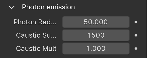

Photon Emission
Photon Radius – Determines the radius of the area in which photons are shot. This area is represented by the cylinder around the Sun's ray vector. This parameter has an effect when photons are used in caustics.
Caustic Subdivs – Used by V-Ray when calculating Caustics. Lower values mean more noisy results but render faster. Higher values produce smoother results but take more time. This option is not available with V-Ray GPU.
Caustic Mult – Used by V-Ray when calculating Caustics. This multiplier controls the brightness of the caustics. This option is not available with V-Ray GPU.
