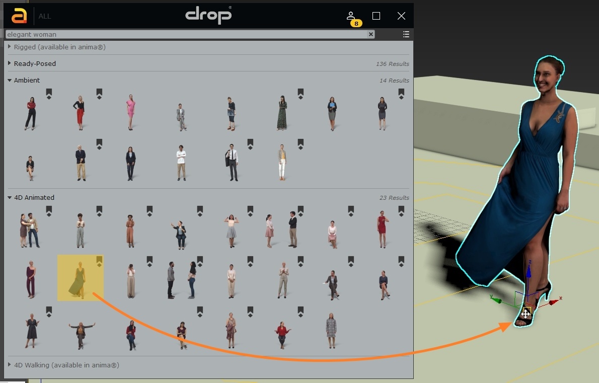

Using the Anima Drop, you can access all your 3D Human assets and start populating your projects directly from 3ds Max, Cinema 4D, Maya, or Unreal Engine with a simple and intuitive interface.
With this panel, you can access all the assets from your library and start populating your scenes with a quick and simple drag and drop gesture (in 3ds Max) or selecting them and clicking the SEND button (in Cinema 4D, Maya or Unreal Engine).

  1. Drag & Drop the models into the app
  2. Place the models using the transformation tools available by default in that application.

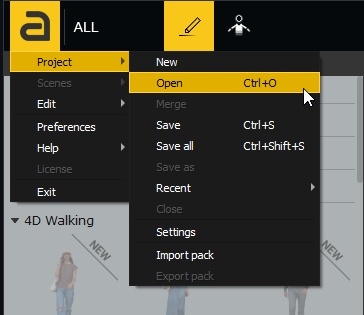

1. Open Anima and load the Drop project (if you have it also opened in Max, Anima will automatically ask you if you want to open it).

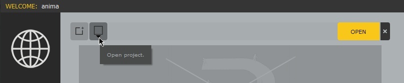

If alive™ is not enabled at that moment, you can browse to where you created the Drop project using this option from the welcome screen:
Or directly going to the Anima Menu > Project > Open.

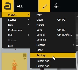

6. Now that one scene from your project is loaded, you have access to the Project Settings dialog. To open it, select the following option from the Project menu:

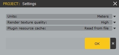

7. Then the following dialog will appear, where you can change the quality of the textures to whatever you may need:
8. At this moment, change the texture quality of your project to whatever you want (for example to “High”).

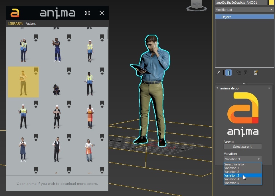

Texture Variations on Dropped Actors
Now you can access the texture variations available for each actor by directly selecting the actor dropped and modifying its variation here.

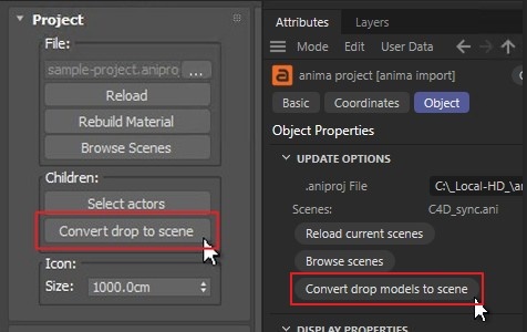

Convert Drop to Scene
It is possible to convert the Drop content added to a scene on the DCC app into a standard Anima scene that can be editable from the Anima Designer standalone application. The process is very simple, just click the following button available in the root anima object from your DCC app.
This can become handy for example when you start populating your scene with Posed, Ambient or 4D models using Anima Drop®, but at some point you realize that you will also need to add Rigged or 4D walking models, which can only be used from the main Anima Designer app.
