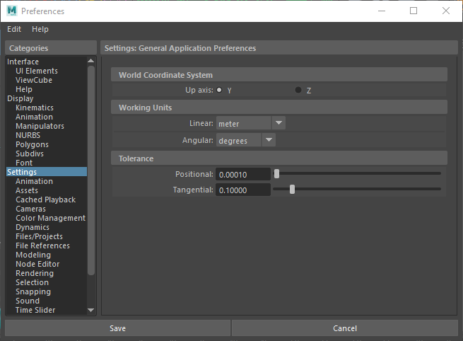

Go to Windows → Settings and Preferences → Preferences → Settings and set the Working Units to Meters

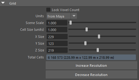

Open the Grid rollout and set the following values:
  • Scene Scale: 1.0.
  • Cell Size: 1.0 m.
  • Size XYZ: [ 229, 123, 219 ].
Use the Size attributes of the Simulator as opposed to simply scaling the Simulator container with Maya's Scale Tool, as that may adversely affect the simulation.

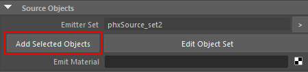

Select the sphere and then shift-select the Source and click Add Selected Objects in the Attribute Editor.
The Object Set of the Source is used to specify the geometry in the scene that will be used to emit fluid into the Simulator.

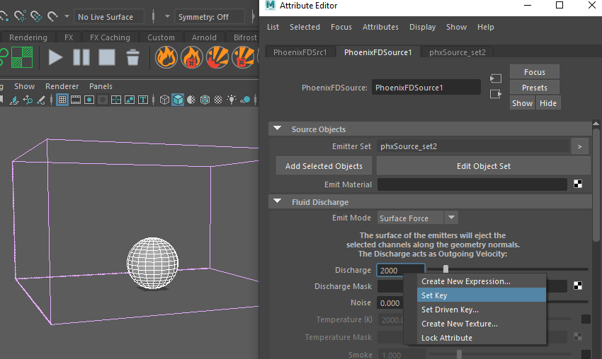

Make sure you're at Frame 0, change the Discharge value to 2000, right-click on the Discharge tab and Set Key.
Then, go to Frame 1, change the Discharge value to 0.0, and set a keyframe.

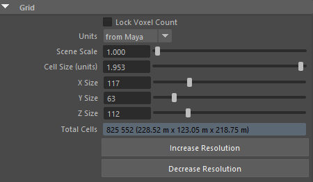

Select the Simulator. In the Attribute Editor under the Grid rollout are located the parameters to control the resolution of the volume grid, which greatly affects the look and performance of the simulation.
Currently, there are about 6 million Total Cells. To save on simulation time during the iteration process, click Decrease Resolution several times until the Total Cells are around 825,000.

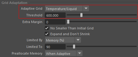

Adjust this in the Grid rollout by turning on Adaptive Grid by Temperature. Lower the Threshold temperature to 600.0 to ensure expansion based on the temperature of the fluid inside when it meets the specified threshold.
If you experience clipping of your smoke, set adaptive to Smoke with a Threshold of 0.02.

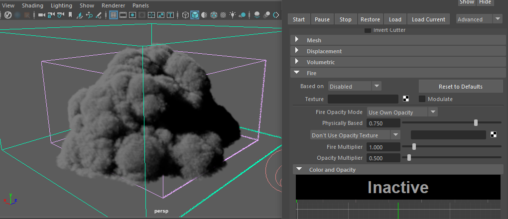

Start the simulation once more. While it is running, select the Simulator and go to the Rendering rollout → Fire tab.

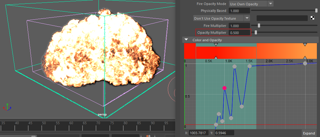

Under the Fire settings, there are a few Fire Opacity Modes available: Use Smoke Opacity, Fully Visible, and Use Own Opacity.
Select Use Own Opacity, and stop the simulation.

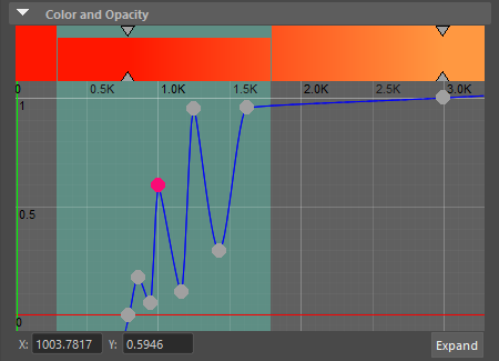

When you use Own Opacity mode, the fire curve will control the opacity of the fire instead of the intensity. The intensity in this mode is controlled by the color gradient and can be boosted or lowered using the Fire Multiplier
The graph here controls only the opacity of the fire. Double-click to add a new point to the curve and drag it down to reduce the opacity of the fire, revealing more of the internal fire content and making it look brighter. Drag the point up to increase the opacity and hide more of the internal structure. Add points in the middle for a gentle curve.
Click the Expand button for a larger graph to work with.
You can further adjust the opacity with the Opacity Multiplier above the graph. For this example, we will lower this value to 0.5, and notice how the fire increases in brightness.
The Physically Based setting blends between artistic and physically accurate results. Change Physically Based to 0.75 and observe the more "fiery" look in the simulation. This parameter balances between how much of the fire intensity comes from the color gradient plus the fire multiplier versus how much is calculated using the physically-based black body shader.
To change the color of the fire, double-click on the carrots above the graph and select a new color. Select Cancel to return to the previous color.

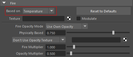

In the Fire rollout, remember to set the Fire's Based on parameter back to Temperature before restarting the simulation.

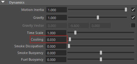

The explosion is starting to look good, but it stays hot for too long. We need to increase the cooling of the fire by going to Dynamics rollout and increasing Cooling to 0.3.

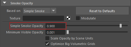

Our smoke looks very thin. In the Rendering rollout, expand the Smoke Opacity tab and increase Simple Smoke Opacity to 0.9.
Simple Smoke Opacity: 0.5
Simple Smoke Opacity: 0.9

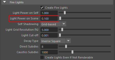

Notice some areas of the floor are too bright. You are able to control this in Rendering → Fire Lights rollout.
Set the Light Power on Scene value to 0.5 and re-render the frame. By reducing this value, the light is more evenly distributed.

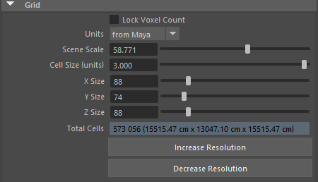

Select the Simulator and change the Cell Size to 3.0. This will decrease the Total Cells to around 573,000 and will save you time during the iteration process.

Select the red barrel pCylinder2, shift-select the duplicated Source and click Add Selected Objects.

Go to the Rendering → Fire Lights tab and change the Light Power on Scene to 0.1.

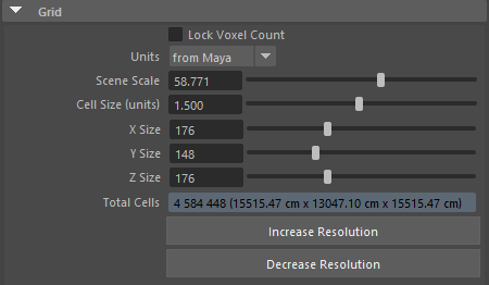

To make the final simulation, go into the Grid rollout and increase the Cell Size to 1.5. This will increase the Total Cells to about 4.5 million.
Set the Adaptive Grid to Smoke and the Threshold to 0.002.
