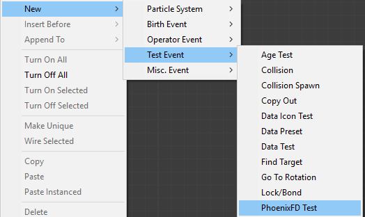

||Particle View window|| > Event Display right click menu > New > Test Event > PhoenixFD Test
