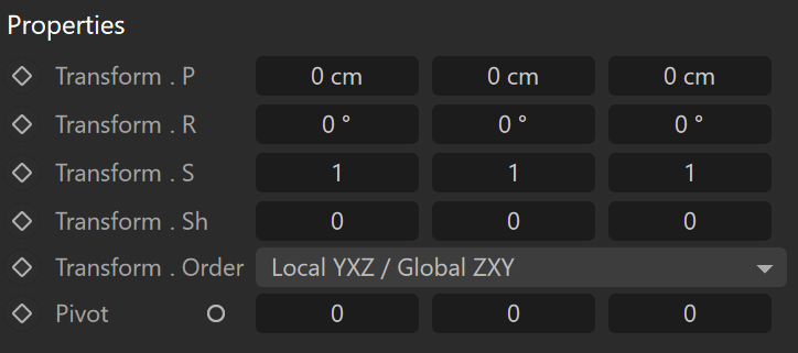

Properties
Transform . P – Controls the map position along the X, Y, Z axes.
Transform . RControls the map rotation along the X, Y, Z axes.
Transform . SControls the map scale along the X, Y, Z axes.
Transform . ShControls the map sheer along the X, Y, Z axes.
Transform . Order – Specifies the order of the X, Y, Z controls:
Local YXZ/ Global ZXY
Local XYZ/ Global ZYX
Local ZXY/ Global YXZ
Local XZY/ Global YZX
Local YZX/ Global XZY
Local ZYX/ Global XYZ
Pivot – Determines the coordinates of the pivot point, around which the texture is rotated. By default, the pivot is placed in the bottom-left corner of the texture, assigning a different value moves it along the U, V or W coordinates, respectively. Negative values can also be assigned.
