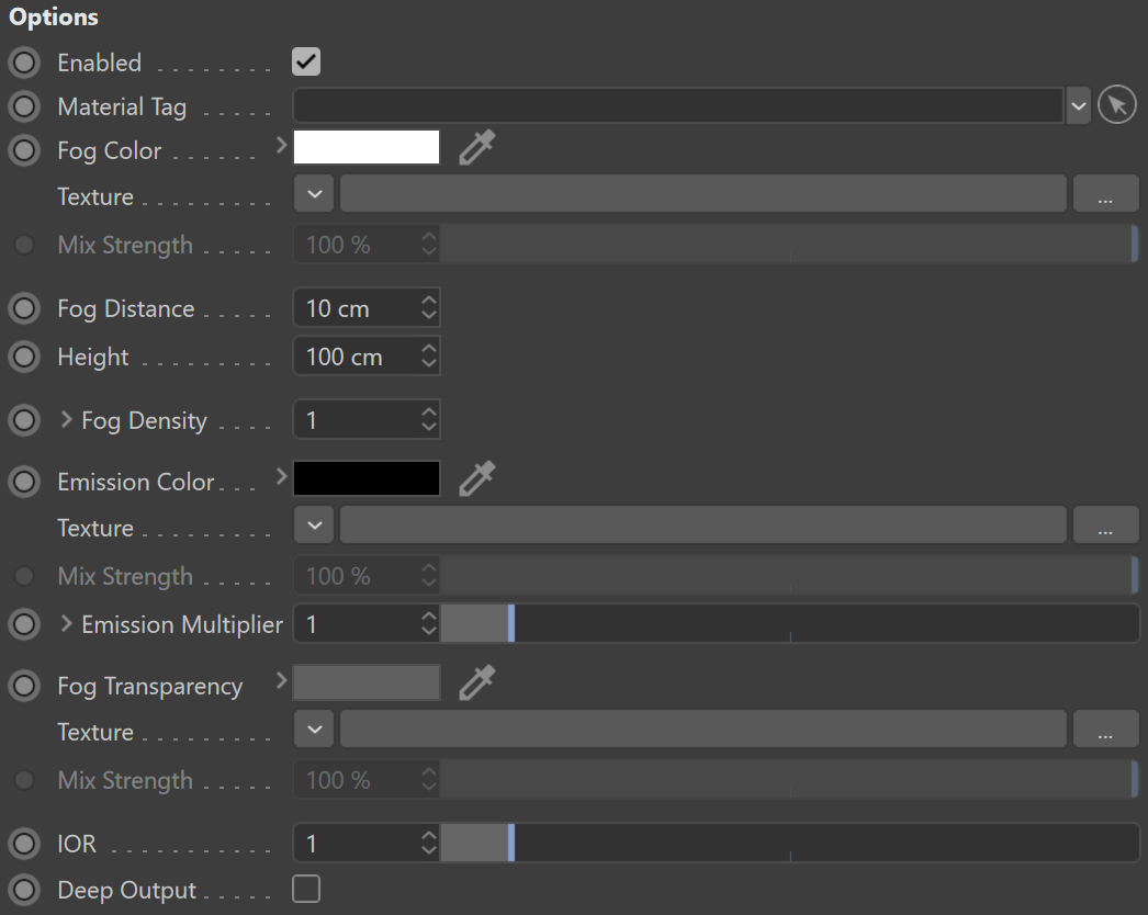

Options
Enabled – Enables or disables the Environment Fog.
Material Tag – Specifies a custom UV mapping for the displacement taken from the material currently attached in the field. If the field is empty, V-Ray uses the default or the UV mapping from the currently applied material to the object.
Fog Color – Defines the color of the fog when it is illuminated by light sources. You can also use a texture map to drive the fog color.
Fog Distance – Controls the fog density. Larger values make the fog more transparent, while smaller values make it denser.
Height – If the fog is not contained within a volume, it is assumed to start from a certain Y-level height and continue downward indefinitely. This parameter determines the starting point along the Y-axis. Note the units are centimeters.
Fog Density – A multiplier for the Fog distance parameter that allows a texture to be used for the density of the fog.
Emission ColorControls the fog emission (self-illumination). You can use this parameter to substitute the ambient illumination inside the fog, instead of using GI.
Emission Multiplier – Multiplies the Emission parameter.
Fog Transparency – Controls the transparency of the fog volume at a thickness given by the Fog distance parameter. Brighter colors make the fog more transparent.
IORIndex of Refraction for the volume, which describes the way light bends when crossing the material surface. A value of 1.0 means the light does not change direction.
Deep Output – Toggles writing deep data to the file. Note that enabling this option forces ray marching even for simple volumetrics which can cause slower rendering.
