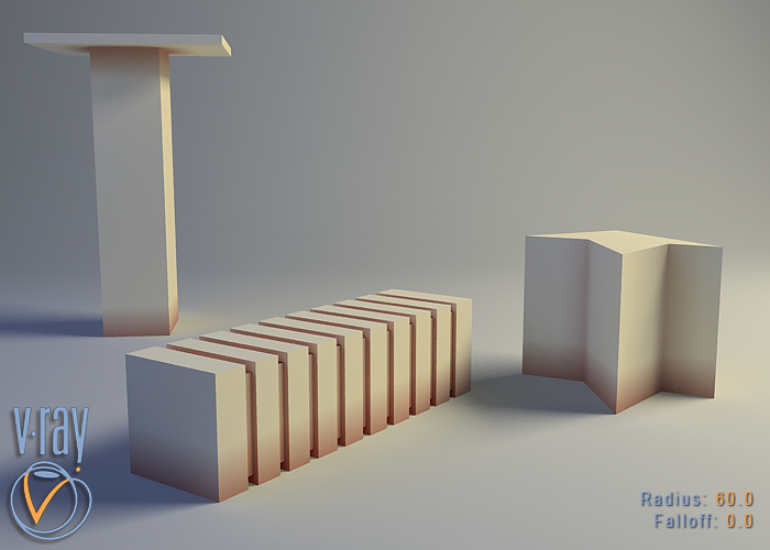

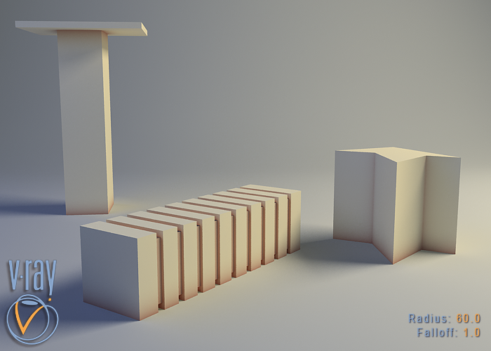

Example: Falloff Parameter
Falloff: 0.0
Falloff: 1.0
Falloff: 5.0

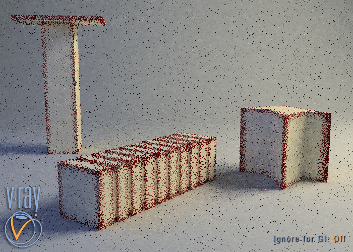

Example: Ignore for GI
This check-box determines whether the dirt effect is going to be visible during the GI calculation.
ON
OFF
