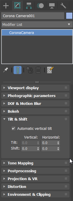

Tilt & Shift
Automatic vertical tilt Automatically sets the Vertical Tilt parameter to keep vertical lines straight and unaffected by perspective when the camera is looking up or down.
Automatic vertical tilt ON
Automatic vertical tilt OFF

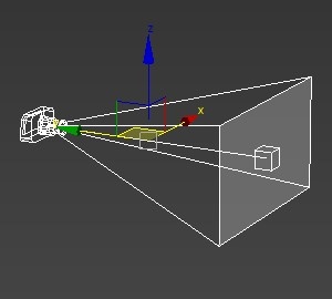

  • You can select both the Camera and its Target at the same time by clicking on the connecting line;
  • You can see the Camera clipping planes in the viewport;
  • You can easily resize the Camera’s viewport icon using the Icon size option under the Viewport display rollout;
  • The camera's viewport icon changes according to the currently used VR mode (spherical, cylindrical, etc.);
  • Interactive Rendering - as opposed to the native cameras, Interactive Rendering will not restart when changing the tone mapping parameters of a Corona Camera.

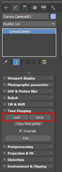

Saving and Loading Tone Mapping and Post-processing Settings
The Corona VFB offers Save and Load options, which can be used to save and load tone mapping and post-processing settings using the special CONF file format. Starting from Corona Renderer 4, those settings can be freely exchanged between the Corona VFB and the Corona Camera. This allows, for example, for:
  • Defining the look of the image using the Post tab of the Corona VFB, and then moving those settings to a Corona Camera.
  • Creating various post-processing presets, which can be then loaded into different Corona Cameras and the Corona VFB.
  • Setting up multiple Corona Cameras with different post-processing settings, and then loading those settings from one of them into the VFB.
The Corona VFB's Post tab features various tone mapping and post-processing options, and the possibility to save and load them.
After clicking the Save button, you can save your custom preset as a CONF file
You can then load the CONF file into a Corona Camera (and vice versa).
If the CONF file is loaded into the Corona Camera, and the Override checkboxes are enabled in that Corona Camera (to override the VFB settings), you will see that our custom post-processing preset is now used for the rendered image. So first we set up our desired post-processing in the VFB, then we saved them as a CONF file, and then loaded that CONF file into the Corona Camera.
If you render a non-camera view (in this case a free perspective view), only the settings available in the VFB Post tab are considered. Once you render from the Corona Camera again, the CONF settings loaded in that Corona Camera will be used again.
